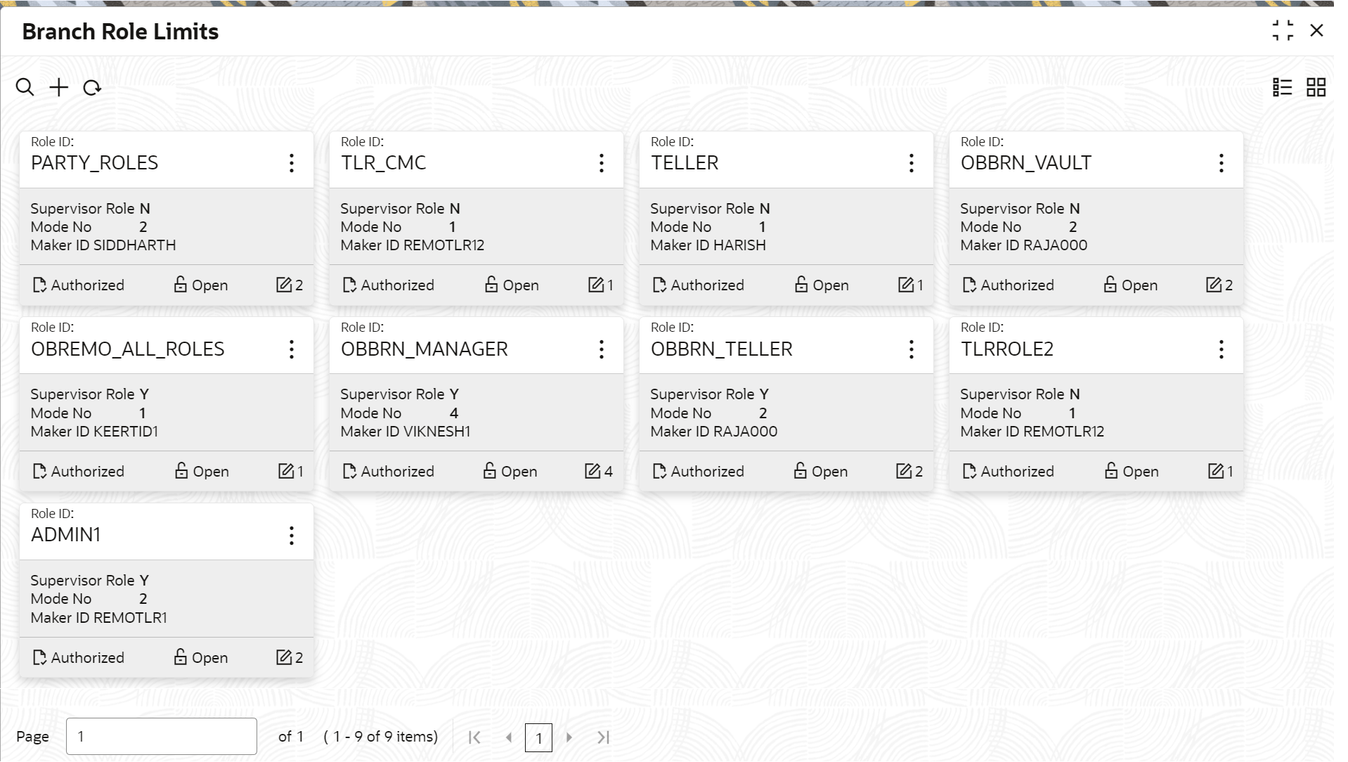

  1. On the Home screen, from Teller mega menu, under Branch Maintenance, click Branch Role Limits or specify Branch Role Limits in the search icon bar and select the screen.
    The Branch Role Limits summary screen is displayed.
    Figure 9-3 Branch Role Limits (Summary)

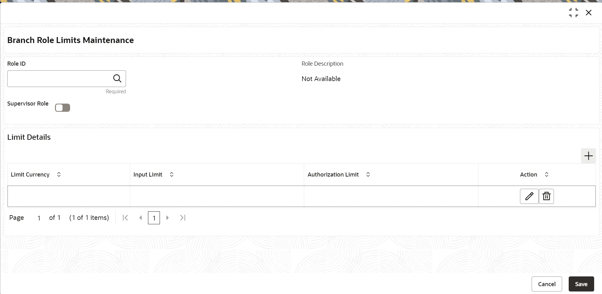

    The Branch Role Limits Maintenance screen is displayed.
    Figure 9-4 Branch Role Limits Maintenance
  3. On the Branch Role Limits Maintenance screen, specify the fields. For more information on fields, refer to the field description table.

    Field Description
    Role ID
    Select the role ID for which the limit preferences are to be set.
    Role Description
    Displays the role description for the selected Role ID.
    Supervisor Role
    Select if the defined role is a designated supervisor of the branch who has the authorization rights.
    Limit Currency
    Select the currency code in which the limits are to be specified.
    Input Limit
    Specify the transaction input limit for a single transaction.
    Authorization Limit
    Specify the maximum amount that the role is allowed to process while authorizing a transaction.
    Action
    Click the necessary icon to edit, save, or delete a row.
  4. Click Save.
    The summary view is displayed with the configured branch role limits.
