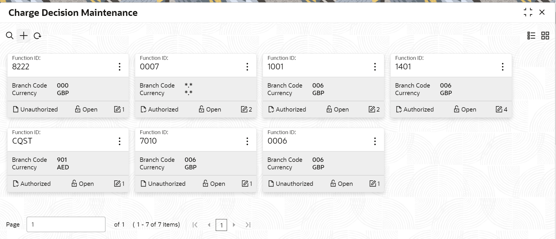

The Charge Decision Maintenance screen is used to maintain the charge decisions.
- On the Home screen, from Teller mega menu, under Branch Maintenance, click Charge Decision Maintenance or specify Charge Decision Maintenance in the search icon bar and select the screen.The Charge Decision Maintenance summary screen is displayed.
Figure 9-39 Charge Decision Maintenance (Summary)

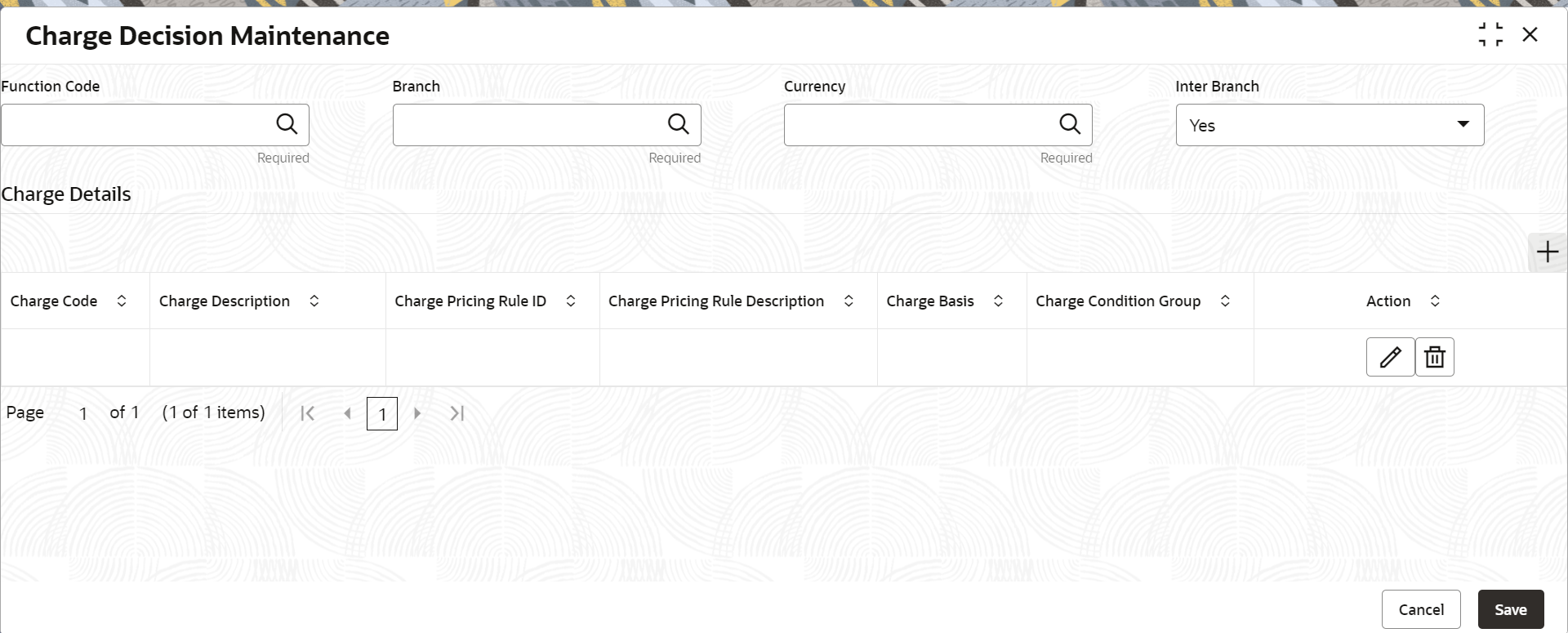

- Click Add icon.The Charge Decision Maintenance screen is displayed.
Figure 9-40 Charge Decision Maintenance (New)
- On the Charge Decision Maintenance screen, specify the fields. For more information on fields, refer to the field description
table.
Table 9-27 Charge Decision Maintenance - Field Description
Field Description Function Code
Specify the function code. You can also select from the list of values.
Branch
Specify the branch code. You can also select from the list of values.
Currency
Specify the currency code. You can also select from the list of values.
Inter Branch
Select the inter-branch requirement from the following drop-down values:-
Yes
No
Both
Charge Details
Specify the fields.
Charge Code
Specify the charge code. You can also select from the list of values.
Charge Description
Displays the description of the charge code specified.
Charge Pricing Rule ID
Specify the charge-pricing rule ID. You can also select from the list of values.Note:
You can choose the pricing rule ID to apply charge or choose a group code from which the pricing rule will be picked for calculation. You can only define the rule or group. Either the rule can be used, or a group can be used.Charge Pricing Rule Description
Displays the description of the charge-pricing rule ID specified.
Charge Basis
Specify the charge basis. You can also select from the list of values.
Charge Condition Group
Specify the charge condition group. You can also select from the list of values.
Action
Click the necessary icon to save, edit, or delete the values of a row.
- Click Save.The summary view is displayed with the configured details of charge decisions.
