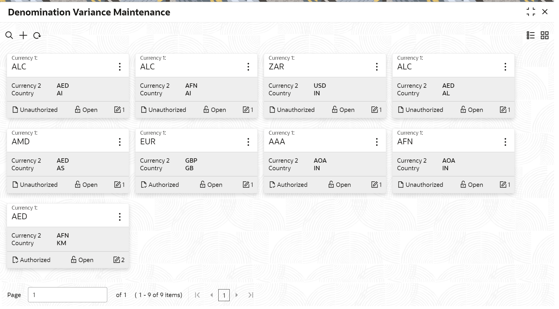

    The Denomination Variance Maintenance summary screen is displayed.
    Figure 9-46 Denomination Variance Maintenance (Summary)

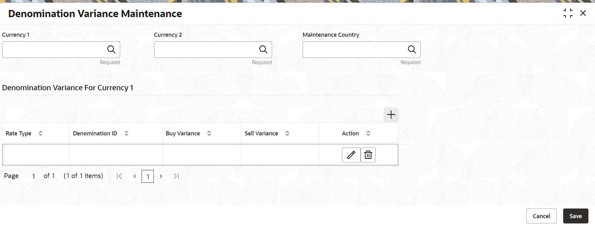

    The Denomination Variance Maintenance screen is displayed.
    Figure 9-47 Denomination Variance Maintenance (New)
  3. On the Denomination Variance Maintenance screen, specify the fields. For more information on fields, refer to the field description table.
