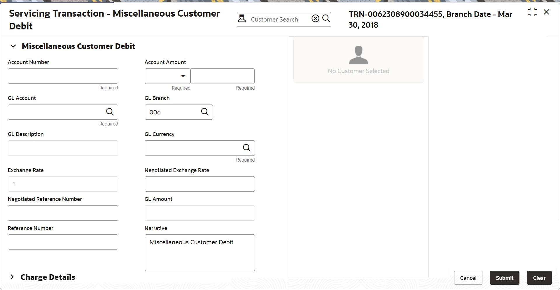

    Figure 8-1 Miscellaneous Customer Debit
  2. On the Miscellaneous Customer Debit screen, specify the fields. For more information on fields, refer to the field description table.
    Table 8-1 Miscellaneous Customer Debit - Field Description
    Field Description
    Account Number
    Specify the account number from which the funds need to be debited.
    The system displays an override or error message on the tab out of Account Number based on the account dormancy parameters.
    Account Amount
    Displays the account currency based on the account number specified. Specify the amount that needs to be debited from the account currency.
    GL Account
    Specify the GL account to which the funds need to be credited.
    You can also select the appropriate GL account from the list of values that displays all the valid GL accounts.
    GL Branch
    Displays the branch code of the transaction branch, and it can be modified.
    GL Description
    Displays the description of the selected GL account number.
    GL Currency
    By default, the account currency is displayed, and it can be modified.
    Exchange Rate
    Displays the exchange rate used to convert the transaction currency into GL currency, and it can be modified.
    If the transaction currency is the same as the account currency, the system displays the exchange rate as 1. This field is displayed only if Multi-Currency Configuration at Function Code Indicator level is set as Y.
    Negotiated Exchange Rate
    Specify the negotiated exchange rate that should be used for foreign currency transactions between the treasury and the branch. You need to specify the negotiated exchange rate only when the currencies involved in the transaction are different.
    This field is applicable only if the transaction involves cross currency and only if cross currency enabled and Negotiated_Rate_Enabled Configuration at Function Code Indicator level is set as Y.
    Negotiated Reference Number
    Specify the unique reference number that should be used for negotiation of cost rate, in foreign currency transaction. If you have specified the negotiated cost rate, then you need to specify the negotiated reference number also.
    GL Amount
    Displays the amount in terms of GL currency.
    Reference Number
    Specify the reference number for the transaction, which is the original transaction reference or any invoice number.
    Narrative
    Displays the narrative as Miscellaneous Customer Debit, and it can be modified.
