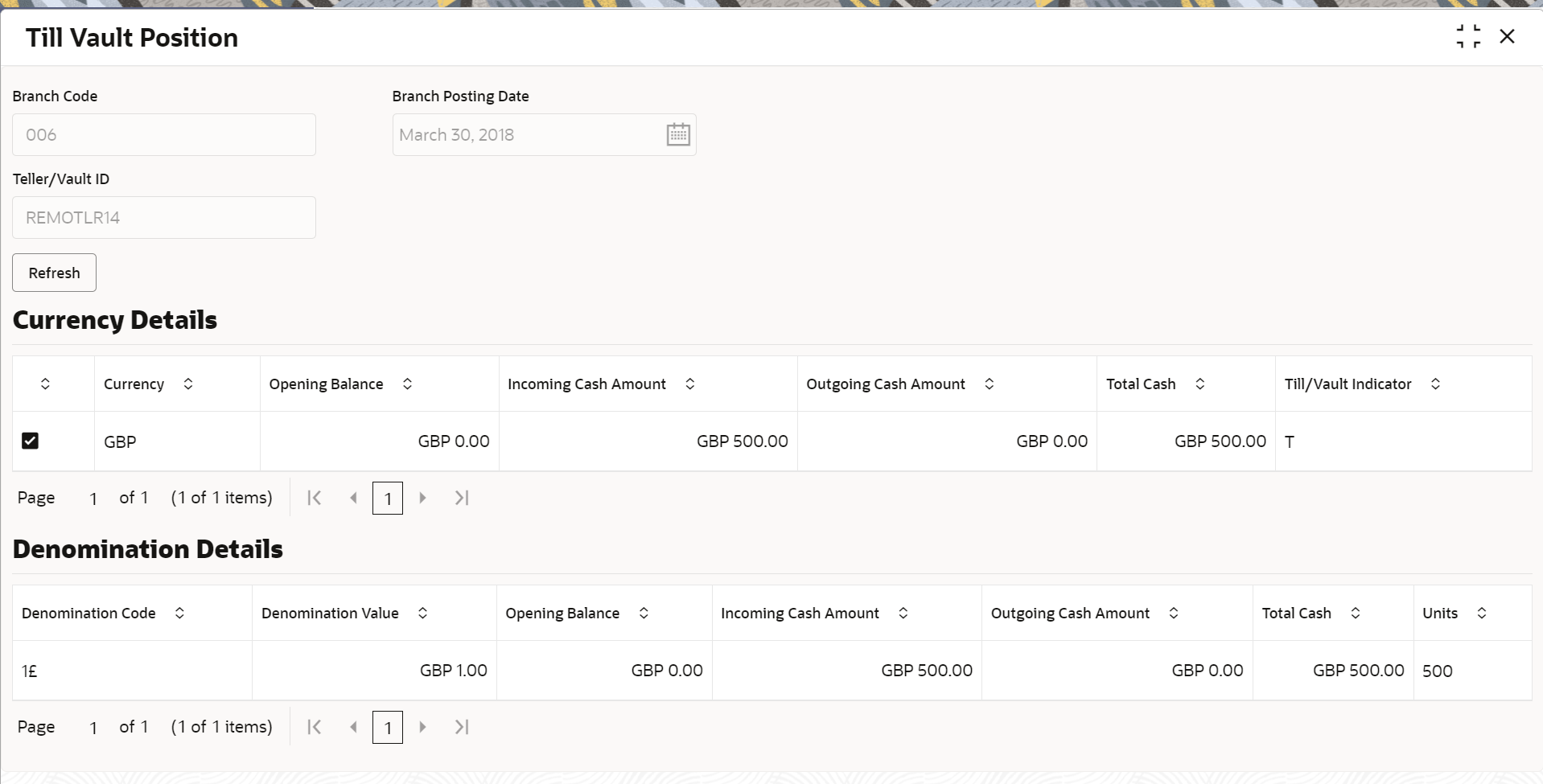

2.6 Till Vault Position
The Till Vault Position screen is used to view the cash position of all the currencies at any time for the Teller ID or Vault ID, which is logged in for the current posting date. It also shows the denomination details.
- On the Home screen, from Teller mega menu, under Branch Operations, click Till Vault Position or specify Till Vault Position in the search icon bar and select the screen.The Till Vault Position screen is displayed.
- On the Till Vault Position screen, specify the fields. For more information on fields, refer to the field description
table.

Field Description Branch Code
Displays the logged-in branch.
Branch Posting Date
Displays the date on which the Till/Vault batch is opened.
Teller/Vault ID
Displays the logged-in Teller ID or Vault Teller ID.
Currency Details
Specify the fields under this section.
Currency
Displays the currency code.
Opening Balance
Displays the opening balance of the till or vault.
Incoming Cash Amount
Displays the incoming cash in the till or vault for the current posting date.
Outgoing Cash Amount
Displays the outgoing cash in the till or vault for the current posting date.
Total Cash
Displays the total cash available in the till or vault.
Till Vault Indicator
Displays whether the currency details apply to Till or Vault. (T or V)
Denomination Details
Displays the denomination details under this section. Denomination Code
Displays the denomination code maintained for the currency. Denomination Value
Displays the denominations maintained for the currency. Opening Balance
Displays the opening balance in the Till or vault in terms of denominations. Incoming Cash Amount
Displays the incoming cash in the Till or vault in terms of denominations. Outgoing Cash Amount
Displays the outgoing cash in the Till or vault in terms of denominations. Total Cash
Displays the total cash currently available in the Till or vault for the day in terms of denominations. Units
Displays the total units available for the specific denomination code.
