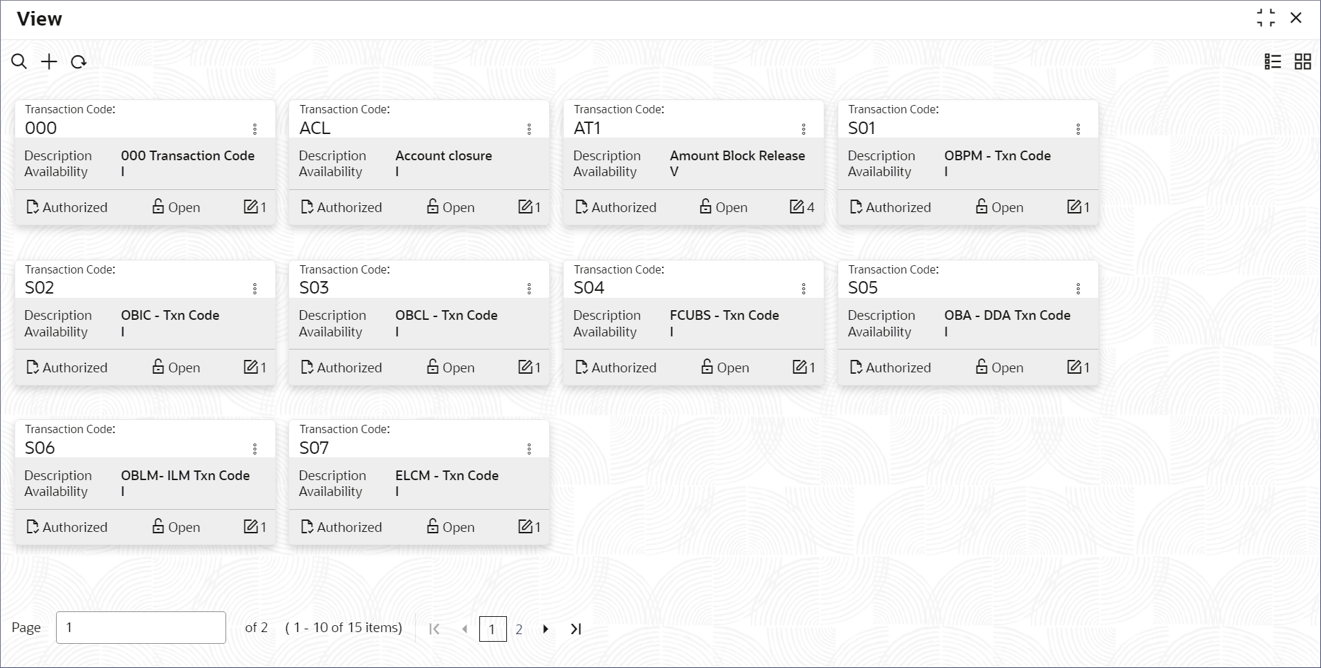

- Click Account Configurations, and under Account Configurations, click Transaction Code Parameters.
- Under Transaction Code Parameters, click View.The View page displays.
Figure 17-2 View Transaction Code Parameters

Table 17-2 Transaction Code Parameters Tile - Field Description
Field Description Transaction Code Displays the Transaction Code. Description Displays the description of the transaction code. Availability Displays the value A, V or I. Where A represents After 'N' day, V represents Value date, and I represents Immediate. Authorization Displays the authorization status of the record. - Authorized
- Rejected
- Unauthorized
Status Displays the status of the record. - Open
- Closed

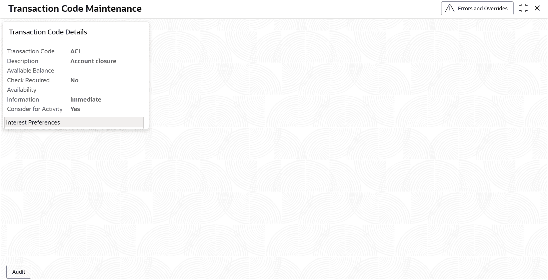

The actions you can perform depend on your role and the record status. - View the details of a Transaction Code Parameters tile.
- Click
and select View.The Transaction Code Maintenance page displays.Figure 17-3 Transaction Code Maintenance Page
- Click Audit.A dialog displays the Maker, Checker, Status, and Modification Number.
- Click

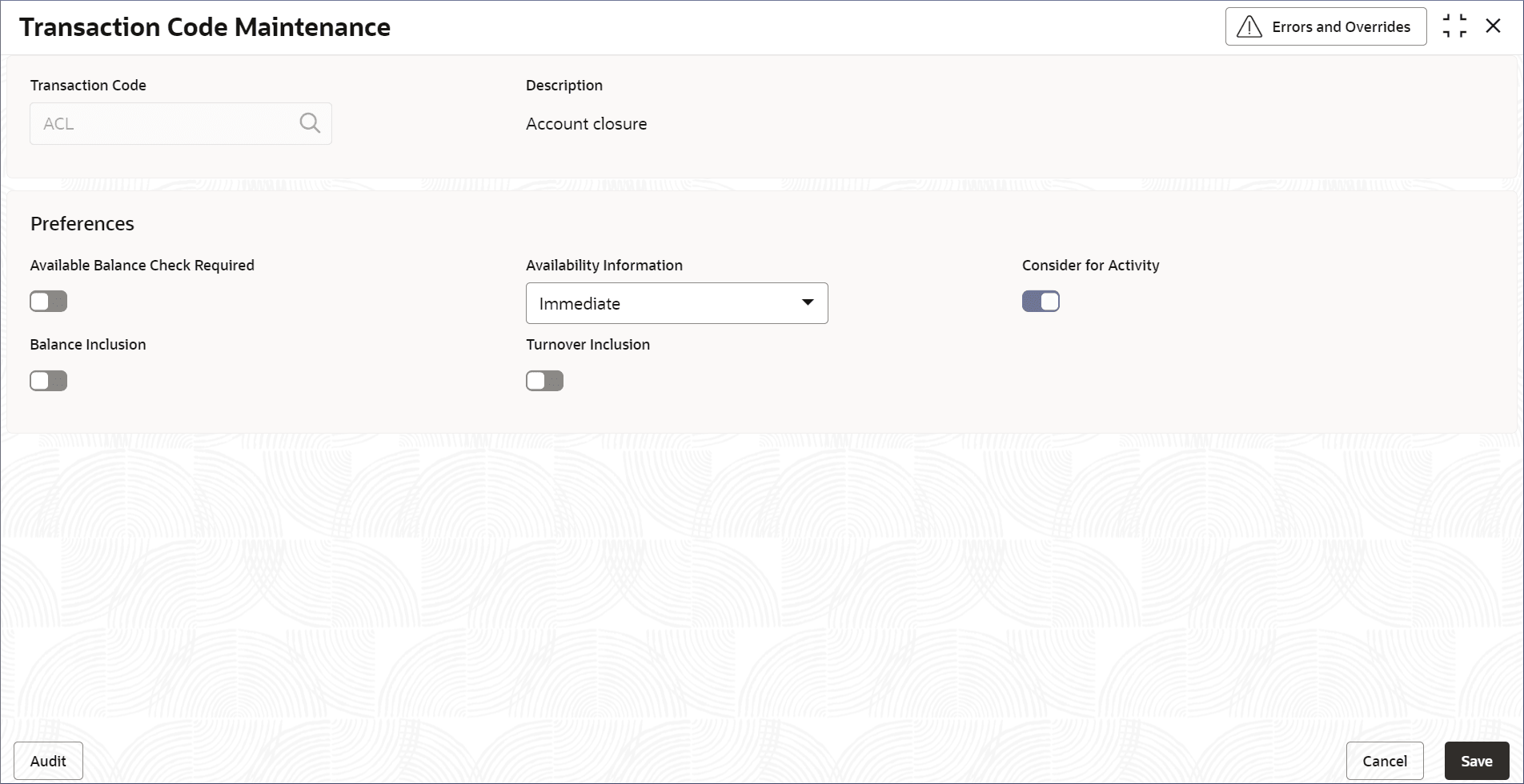

- Unlock and update Transaction Code Parameters.
- Click
and select Unlock.The Transaction Code Parameters page displays.Figure 17-4 Transaction Code Parameters - Unlock
The fields that are grayed cannot be updated. - Edit the required fields.
To know more about editing the Transaction Code Parameters, see Configure Transaction Code Parameters. - Click Save.
