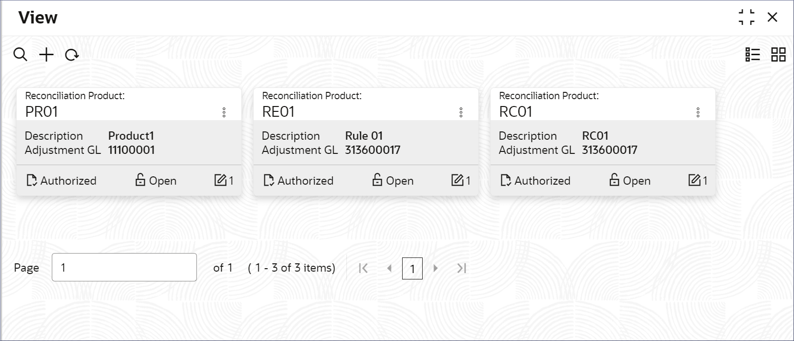

View the Reconciliation Products by following the instructions in this topic.
- Click Nostro Account Configuration, and under
Nostro Account Configuration, click Nostro
Reconciliation Product, then click
View.The View page displays the Reconciliation Products in Tiles view.
Figure 2-20 Nostro Reconciliation Products - Tiles View

Table 2-11 Nostro Reconciliation Product Tile - Field Description
Field Description Reconciliation Product Displays the four characters code for the reconciliation product. Description Describes the Reconciliation Product. Adjustment GL Displays the general ledger used for adjustments. Status Displays the status details of the record. The following table describes the action items in the More Options (

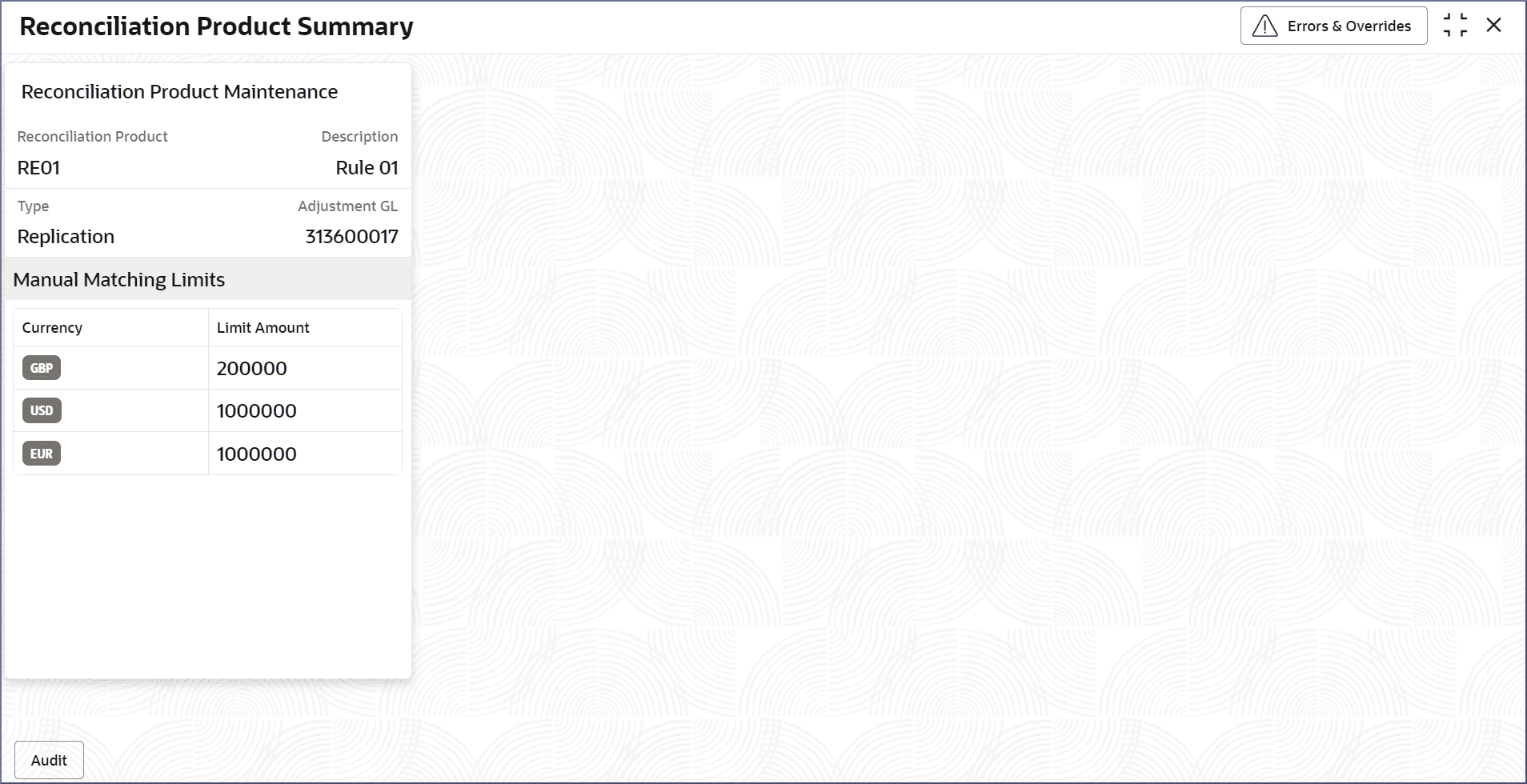

The actions you can perform depend on your role and the record status. - View a Reconciliation Product details.
- Click
and select View.The Reconciliation Product Summary page displays the Reconciliation Product details and the manual matching limits for different currencies.Figure 2-21 Reconciliation Product Summary - View

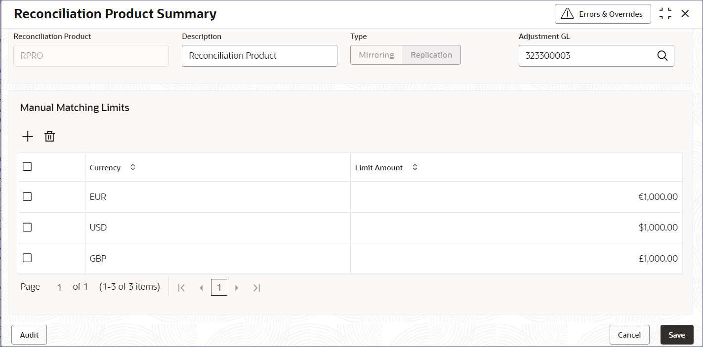

- Unlock and update a Reconciliation product.
- Click
and select Unlock.The Reconciliation Product Summary page displays the Reconciliation Product details and the manual matching limits for different currencies.Figure 2-22 Reconciliation Product Summary Unlock
- Update the required fields.Update the Description and Adjustment GL fields if necessary. Add new manual matching limits and delete the existing limits as required.
- Click Save.
