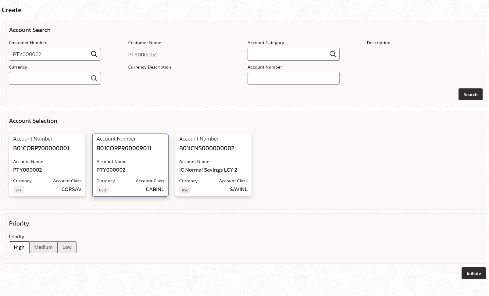

- Search and select the required account and initiate stop payment creation.
- Click Corporate Account Transactions, under Corporate Account Transactions, click Stop Payments.
 - Under Stop Payments, click Create.The Create page displays.
 - Specify the fields in the Account Search section.
Table 5-10 Create Legal Block - Field Description
Field Description Customer Number Specify the CIF number of the customer for whom the stop payment request is to be created from the drop-down list. Customer Name The customer name is displayed. Account Category Specify the account category. Description The description of the account category is displayed. Currency Specify the currency of the customer account. Currency Description The description of the currency is displayed. Account Number Enter the Account Number.  - Click Search.The Create page displays the accounts matching the search filters in the Account Selection section .
 - Select the required account and click Initiate.The Create Stop Payment Entry - <Application Number> page displays the Stop Payments screen.

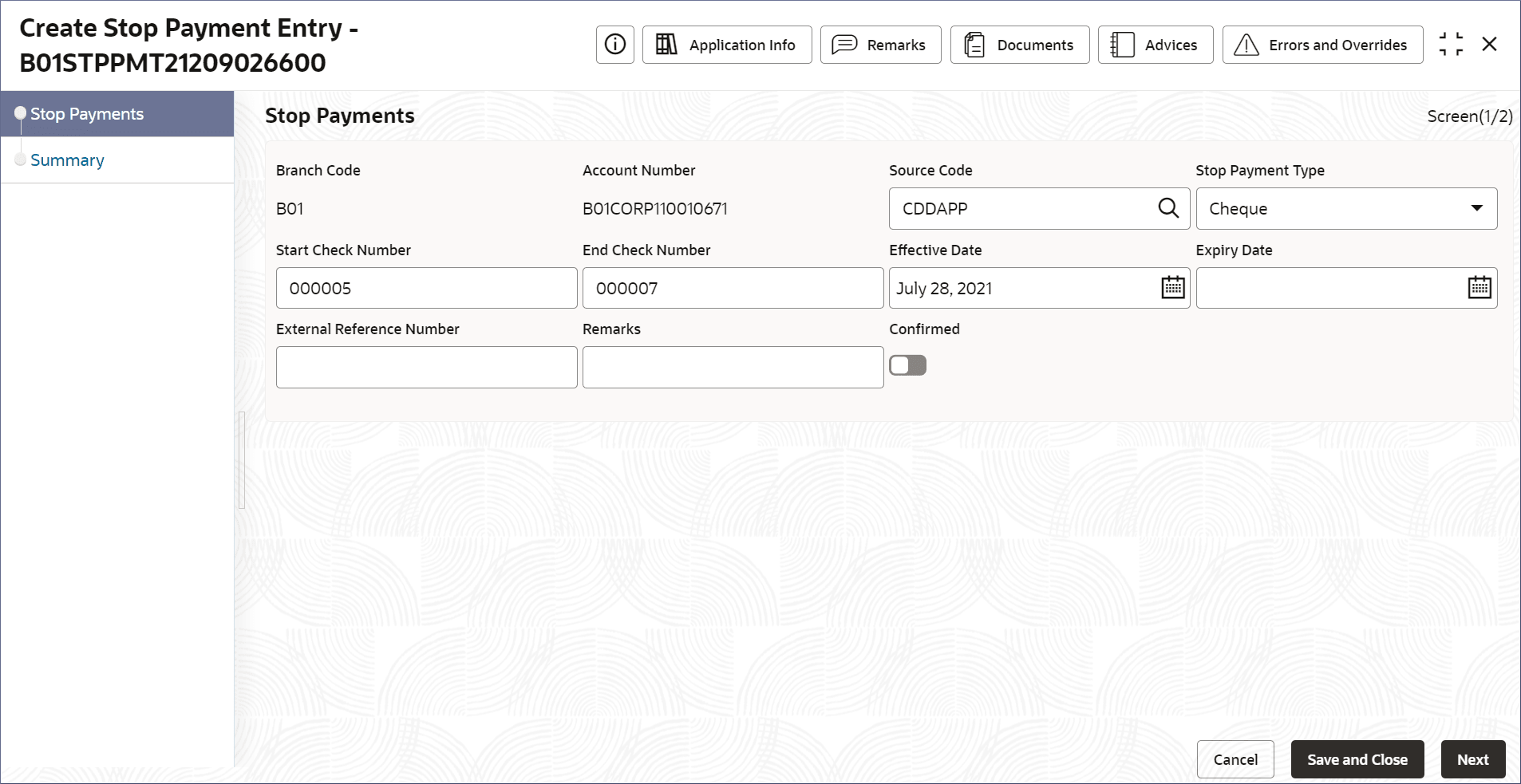

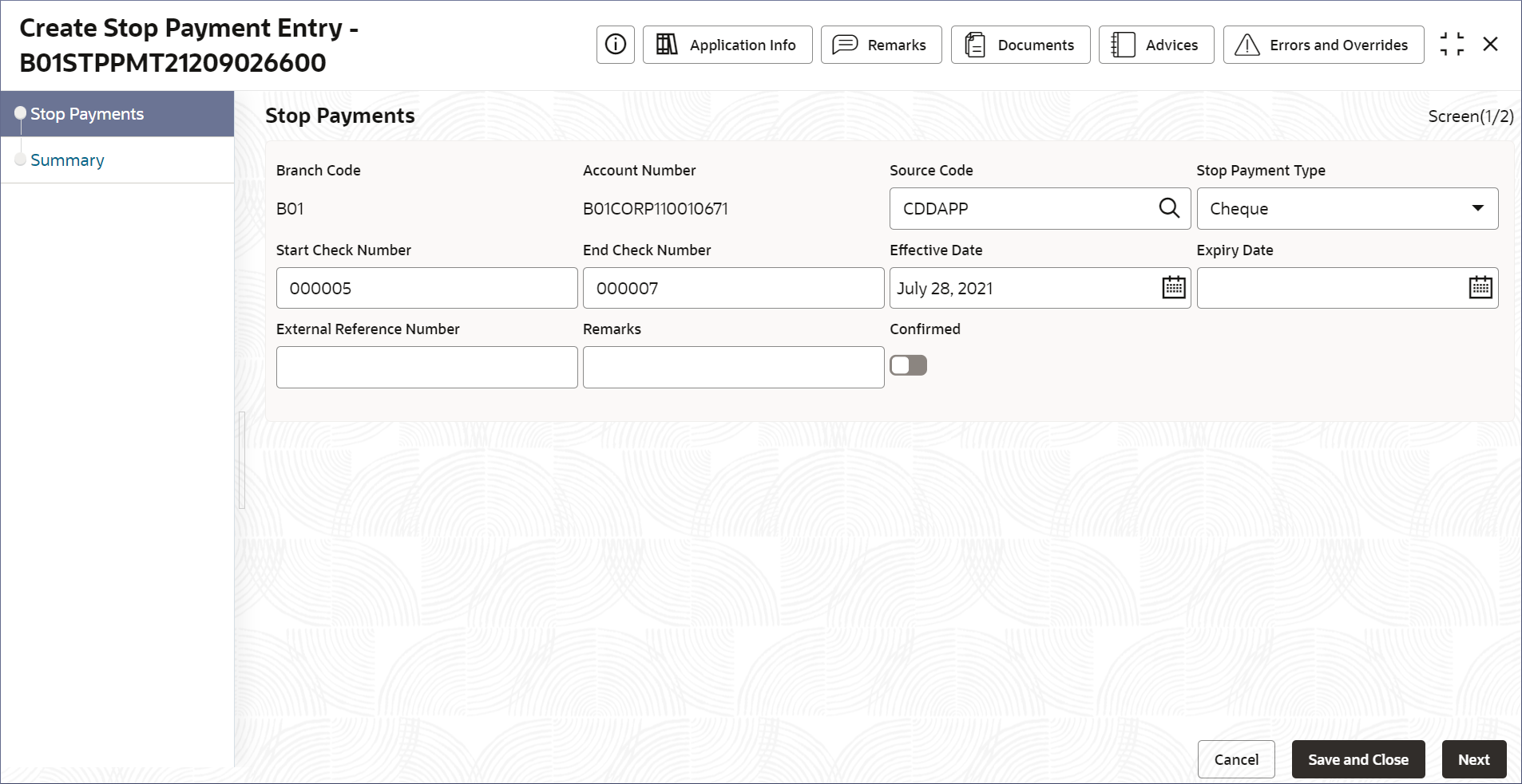

 - Specify the details on the Stop Payments screen.
Table 5-11 Create Stop Payments Entry - Field Description
Field Description Branch Code Displays the branch code the account belongs. Account Number Displays the number of the account. Source Code Specify the product source code that has issued the stop check payment request. Stop Payment Type Specify the stop payment type from the following: - Amount - The transaction amount to stop payment.
 - Check - The sequence of checks issued to stop payment.
Amount The transaction amount to block from payment. Note: This field displays if the Stop Payment Type is Amount.
Start Check Number The number of the first check in the sequence to stop payment. Note: The check number should match the number in the check leaf. This field displays if the Stop Payment Type is Check.
End Check Number The number of the last check in the sequence to stop payment. Note: The check number should match the number in the check leaf. This field displays if the Stop Payment Type is Check.
Effective Date The date from which the stop payment instruction is active. Expiry Date The date on which the stop payment instruction expires. External Reference Number (optional) Specify the external reference number of the transaction to stop payment. Remarks Specify any remarks. Confirmed Toggle the switch On if the stop payment is confirmed.  - Click Next.The Summary screen displays.
