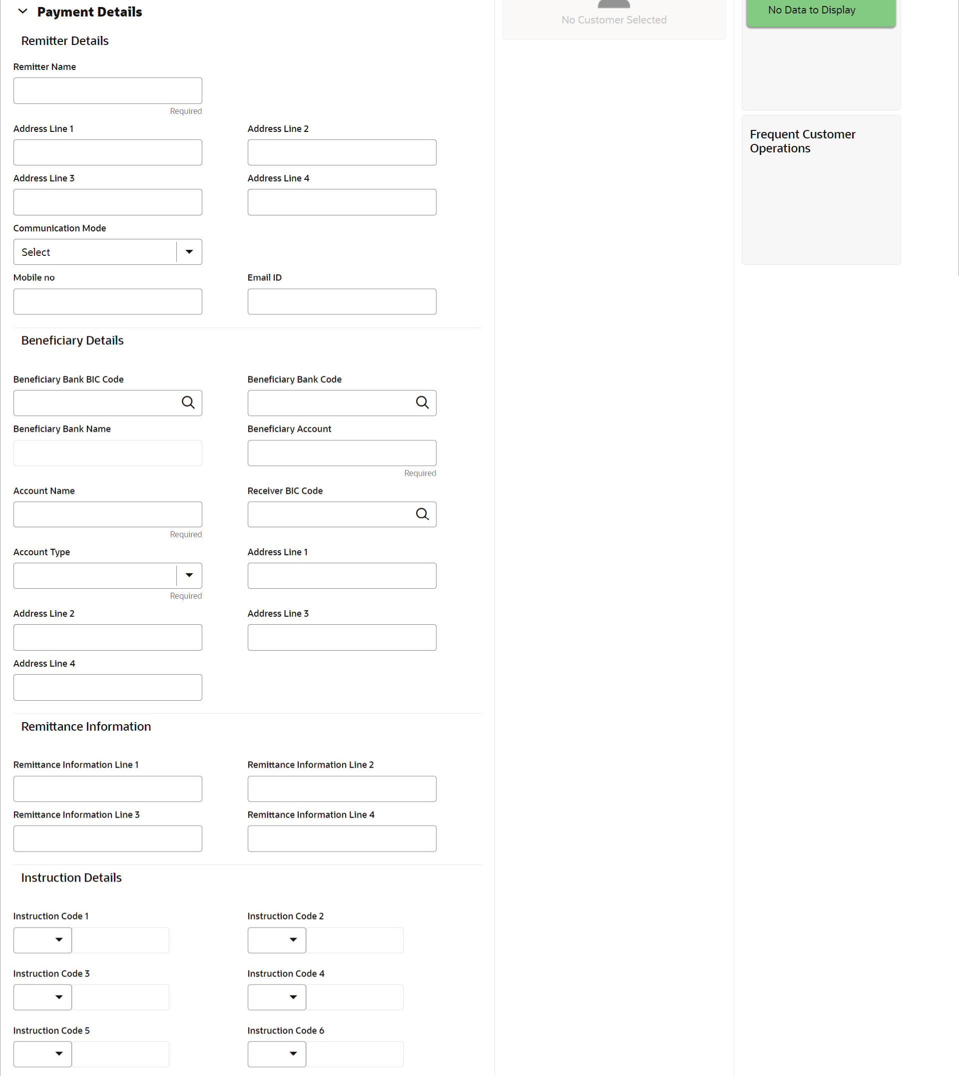

3.5.1 Add Payment Details for International Transfer
You can add the payment details for the international transfer in the Payment Details data segment.
Make sure that the transaction details are added to the screen.
To add the payment details:
On the Payment Details data segment, specify the fields. For more information on fields, refer to the field description table.
The fields marked as Required are mandatory.
Table 3-7 Payment Details - Field Description
Field Description
Remitter Details
Specify the fields.
Remitter Name
Displays the remitter description based on the remitter account number specified.
Address Line 1 to Address Line 4
Displays the remitter address details.
Communication Mode
Specify the mode of communication for the transaction. The drop-down values are E-Mail and Mobile No.
Mobile No
Specify the mobile number.
This field is mandatory if the Communication Mode is selected as Mobile No.
Email ID
Specify the email address.
This field is mandatory if the Communication Mode is selected as E-Mail.
Beneficiary Details
Specify the fields.
Beneficiary Bank BIC Code
Select the beneficiary BIC code from the list of values.
The LOV display all valid swift BIC codes maintained in the system.
Beneficiary Bank Code
Select the beneficiary bank code from the list of values.
The LOV display all valid clearing bank codes maintained in the system.
Beneficiary Bank Name
Specify the name of the beneficiary bank.
If the beneficiary bank code is selected, the system displays the description.
Receiver BIC Code
Specify the receiver BIC code from the list of values.
The LOV displays all the valid swift BIC codes maintained in the system.
Beneficiary Account
Specify the account number of the beneficiary.
Account Type
Select the account type of the beneficiary from the drop-down list.
Account Name
Specify the account name of the beneficiary.
Specify the address of the beneficiary.
Remittance Information
Specify the fields.
Remittance Information Line 1 to Remittance Information Line 4
Specify the remittance information in free text format.
Instruction Details
Specify the details under this section.
Instruction Code 1 to Instruction Code 6
Select the instruction codes from the drop-down list, and specify the additional information. The drop-down values are as follows:
  • CHQB – Cheque, Pay beneficiary customer by cheque only.
  • HOLD – Hold, Beneficiary customer/claimant will call; pay upon identification.
  • PHOB – Phone Beneficiary, Advise/contact beneficiary/claimant by phone.
  • PHOI – Phone Intermediary, Advise the intermediary institution by phone.
  • PHON – Telephone, Advise account with institution by phone.
  • REPA – Related Payment, Payment has a related e-Payments reference.
  • TELB – Telecommunication, Advise/contact beneficiary/claimant by the most efficient means of telecommunication.
  • TELE – Telecommunication, Advise the account with the institution by the most efficient means of telecommunication.
  • TELI – Telecommunication, Advise the intermediary institution by the most efficient means of telecommunication.
  • INTC – Intra-Company Payment, A payment between two companies belonging to the same group.
  • SDVA – Same Day Value, Payment must be executed with same-day value to the beneficiary.
  • CORT – Corporate Trade, Payment is made in settlement of a trade, for example, foreign exchange deal, securities transaction.
The field for additional information is disabled for the following codes:
  • CHQB
  • INTC
  • SDVA
  • CORT
