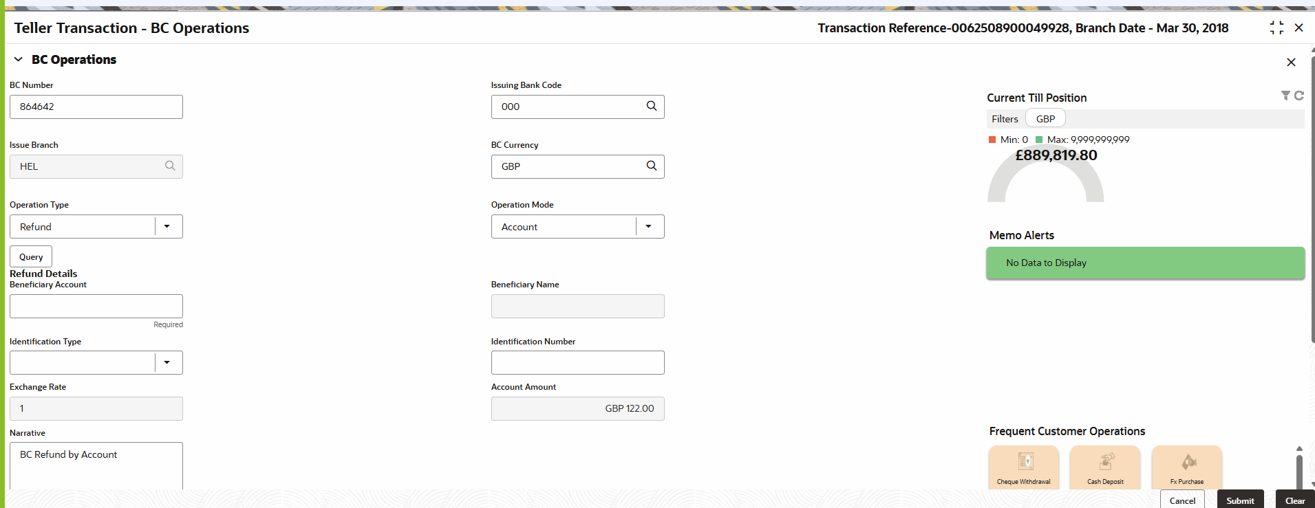

The Teller can use the BC Operations screen to refund the amount against a BC.
The BC payment is credited to the GL account when the operation mode is GL.
To refund the amount:
  1. On the Homepage, from Teller mega menu, under Remittances, click BC Operations or specify BC Operations in the search icon bar and select the screen.
    The BC Operations screen is displayed.
    Figure 5-16 BC Operations - Refund by GL
  2. On the BC Operations screen, specify the fields. For more information on fields, refer to the field description table.
    The fields marked as Required are mandatory.
