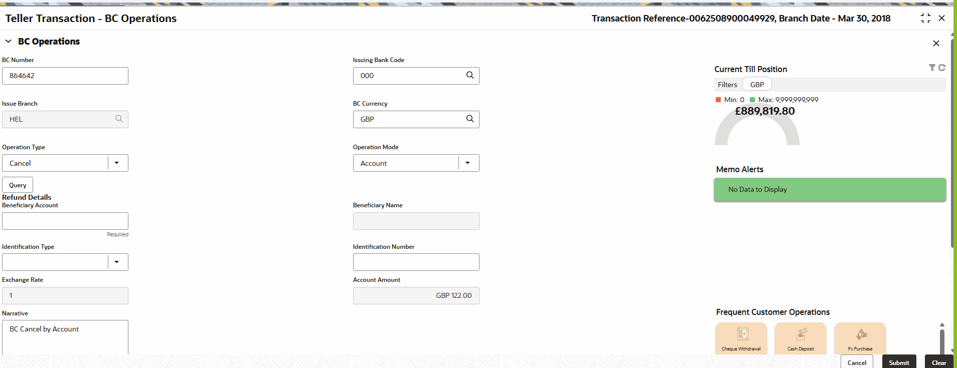

Figure 5-18 BC Operations - Cancel by Cash
- On the BC Operations screen, specify the fields. For more information on fields, refer to the field description
table.
The fields marked as Required are mandatory.Table 5-18 BC Operations (Cancel by Cash) - Field Description

- Click on the View BC Details data segment to view the
additional details of the BC.
This data segment is non-editable. - Specify the denomination details. For information on the fields in the Denomination segment, refer to Add Denomination Details.
- Click Submit.
A teller sequence number is generated, and the Transaction Completed Successfully information message is displayed.
The transaction is moved to authorization in case of any warning raised when the transaction saves.On transaction submission, the system will hand off the details to the payments product processor (Oracle Banking Payments) for processing. When you get a success notification from Oracle Banking Payments, the system will update the transaction status as Success and mark for charges accounting hand off. In case of reject notification from the Oracle Banking Payments, the system will discard the transaction.
