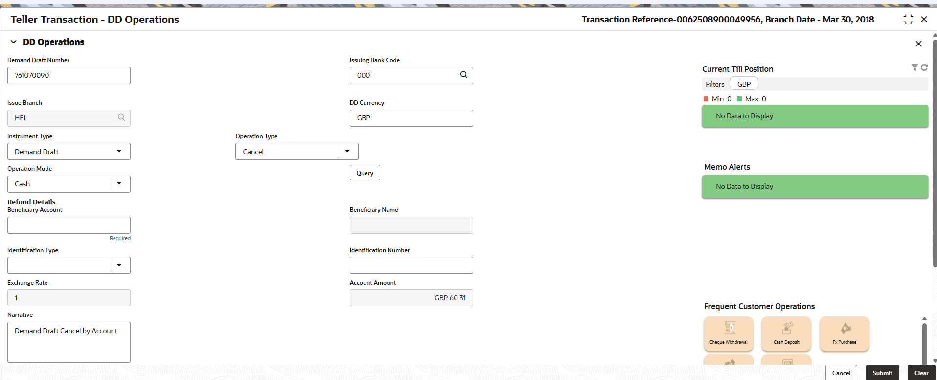

Figure 5-37 DD Operations - Cancel by Cash
- On the DD Operations screen, specify the fields. For more information on fields, refer to the field description
table.
The fields marked as Required are mandatory.Table 5-37 DD Operations (Cancel by Cash) - Field Description
Field Description Demand Draft Number
Specify the DD number of the instrument.
Issuing Bank Code
Specify the code of the issuing bank.
Issue Branch
Select the branch code where the instrument is issued from the LOV.
DD Currency
Specify DD Currency to query instrument details.
Instrument Type Select the instrument type from the drop-down list. The option are:- Demand Draft
- Demand Draft-FCY
Operation Type
Select the type Cancel from the drop-down list.
Operation Mode
Select the operation mode as Cash from the drop-down values.
Cancel Details
Specify the details under this segment.
Transaction Amount
Specify the transaction currency and transaction amount.
Beneficiary Name
Specify the beneficiary's name.
Identification Type
Select the identification type of the beneficiary from the drop-down values.
Identification Number
Specify the identification number of the beneficiary.
Exchange Rate
Displays the exchange rate, and it can be modified.Note:
If the transaction currency is the same as the account currency, the system will display the exchange rate as 1. This field is displayed only ifMulti-Currency Configurationat the Function Code Indicator level is set as Y.Total Charge Amount
Displays the account amount.Note:
This field is displayed only ifTotal Charges Configurationat the Function Code Indicator level is set as Y.Narrative
Displays the default narrative as DD Cancel by Cash, and it can be modified.
