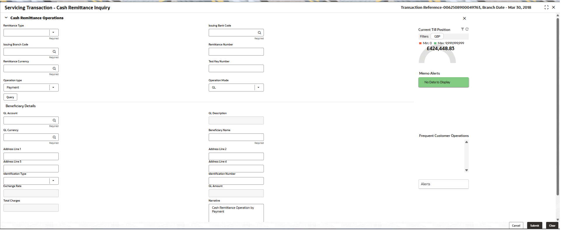

    Figure 5-48 Cash Remittance Operations (Payment by GL)
  2. On the Cash Remittance Operations screen, specify the fields. For more information on fields, refer to the field description table.
