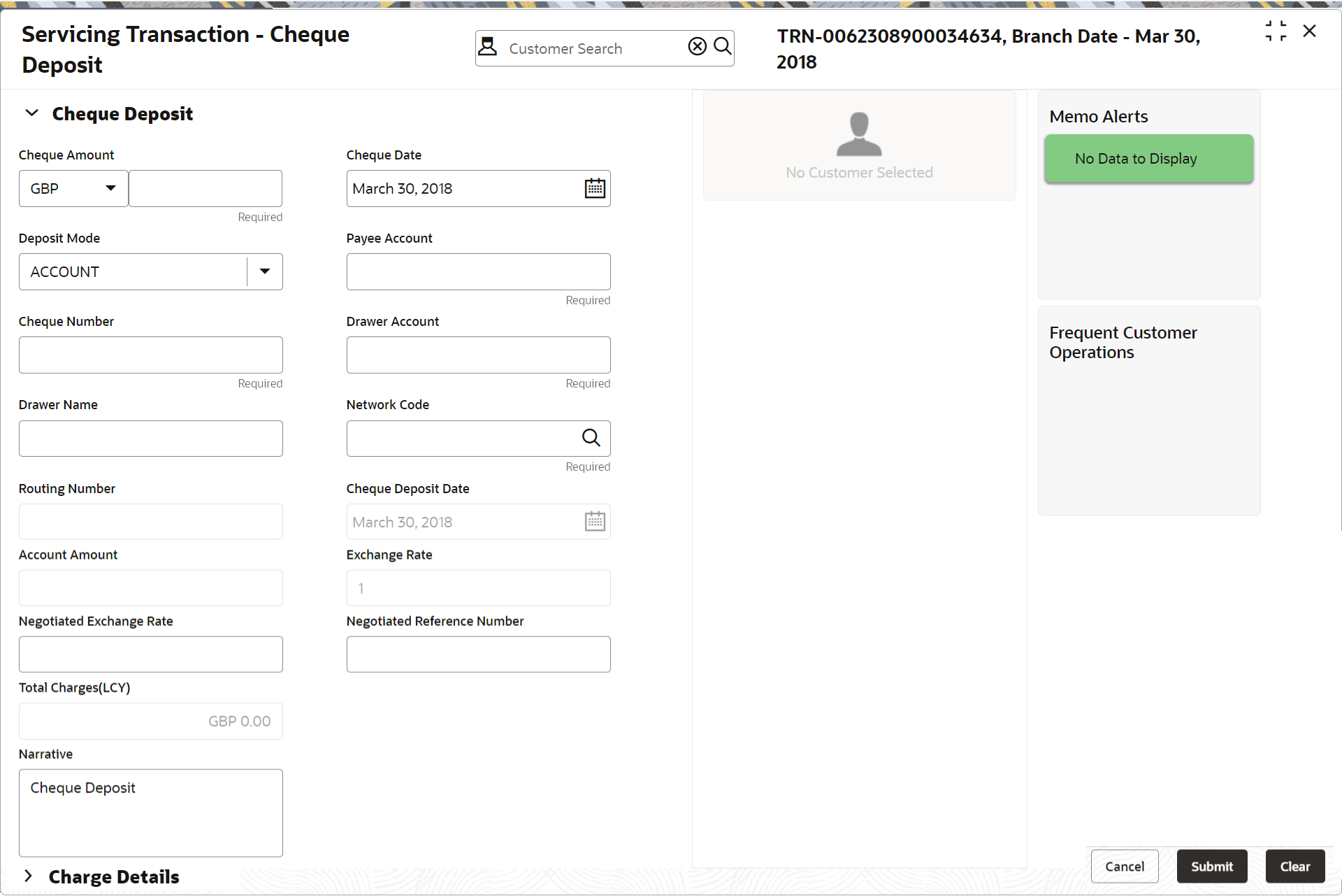

4.1.1 Cheque Deposit Against Account
The Teller can use the Cheque Deposit screen to carry out the cheque deposit transaction for a customer.
To capture the cheque deposit request:
  1. On the Homepage, from Teller mega menu, under Clearing, click Cheque Deposit or specify Cheque Deposit in the search icon bar and select the screen.
    The Cheque Deposit screen is displayed.
  2. On the Cheque Deposit screen, specify the fields. For more information on fields, refer to the field description table.
    The fields marked as Required are mandatory.
    Table 4-1 Cheque Deposit (Account Mode) - Field Description

  3. Specify the charge details. For information on the fields in the Charge Details segment, refer to Charge Details.
  4. Click Submit.
    A teller sequence number is generated, and the Transaction Completed Successfully information message is displayed.
    The transaction is moved to authorization in case of any warning raised when the transaction saves.
    When you submit, the transaction details are handed off to the Oracle Banking Payments system for Outward Clearing transaction processing with external system status as Pending.
