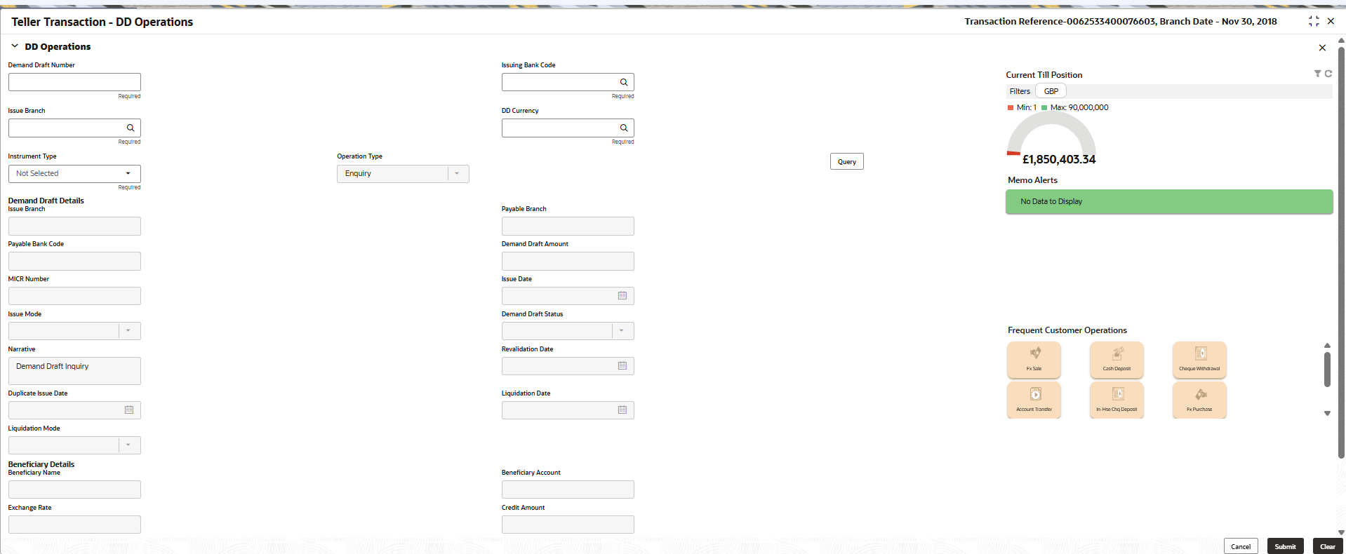

    Figure 5-31 DD Operations - Payment by Cash
  2. On the DD Operations screen, specify the fields. For more information on fields, refer to the field description table.
    The fields marked as Required are mandatory.
    Table 5-31 DD Operations (Payment by Cash) - Field Description
    Field Description
    Demand Draft Number
    Specify the DD number of the instrument.
    Issuing Bank Code
    Specify the code of the issuing bank.
    Issue Branch
    Select the branch code where the instrument is issued from the LOV.
    DD Currency
    Specify DD Currency to query instrument details.
    Operation Type
    Select the type Payment from the drop-down list.
    Operation Mode
    Select the operation mode as Cash from the drop-down values.
    Payment Details
    Specify the details under this segment.
    Transaction Amount
    Specify the transaction currency and transaction amount.
    Beneficiary Name
    Specify the beneficiary name.
    Identification Type
    Select the identification type of the beneficiary from the drop-down values.
    Identification Number
    Specify the identification number of the beneficiary.
    Exchange Rate
    Displays the exchange rate, and it can be modified.
    If the transaction currency is the same as the account currency, the system will display the exchange rate as 1. This field is displayed only if Multi-Currency Configuration at the Function Code Indicator level is set as Y.
    Total Charge Amount
    Displays the total charge amount.
    This field is displayed only if Total Charges Configuration at the Function Code Indicator level is set as Y.
    Narrative
    Displays the default narrative as Demand Draft Payment by Cash, and it can be modified.
