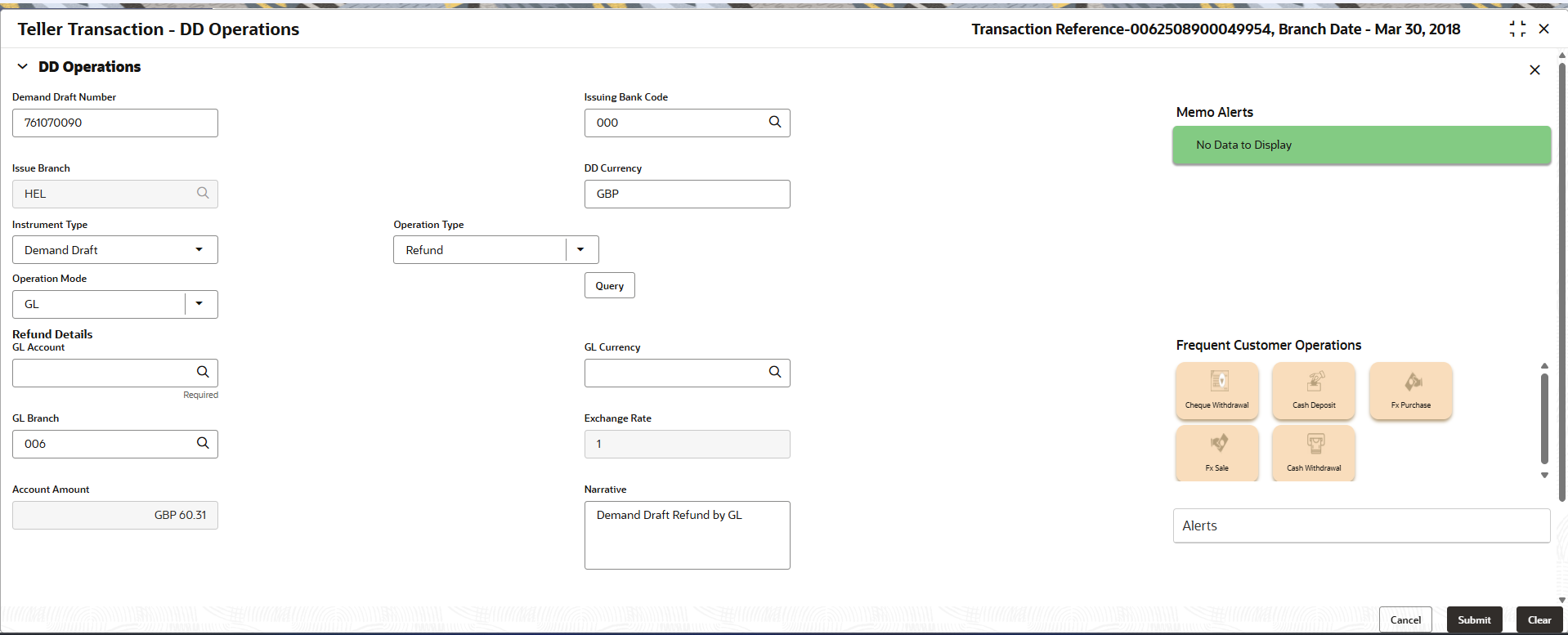

The Teller can use the DD Operations screen to refund the amount against a DD.
The DD payment is credited to the GL account when the operation mode is GL.
To refund the amount:
  1. On the Homepage, from Teller mega menu, under Remittances, click DD Operations or specify DD Operations in the search icon bar and select the screen.
    The DD Operations screen is displayed.
    Figure 5-35 DD Operations - Refund by GL
  2. On the DD Operations screen, specify the fields. For more information on fields, refer to the field description table.
    The fields marked as Required are mandatory.

  3. Specify the charge details. For information on the fields in the Charge Details segment, refer to Charge Details.
  4. Click on the View DD Details data segment to view the additional details of the DD.
    This data segment is non-editable.
  5. Click Submit.
    A teller sequence number is generated, and the Transaction Completed Successfully information message is displayed.
    The transaction is moved to authorization in case of any warning raised when the transaction saves.
    On transaction submission, the system will hand off the details to the payments product processor (Oracle Banking Payments) for processing. When you get a success notification from Oracle Banking Payments, the system will update the transaction status as Success and mark for charges accounting handoff. The transaction accounting is not applicable for the transaction. In case of reject notification from Oracle Banking Payments, the system will discard the transaction.
