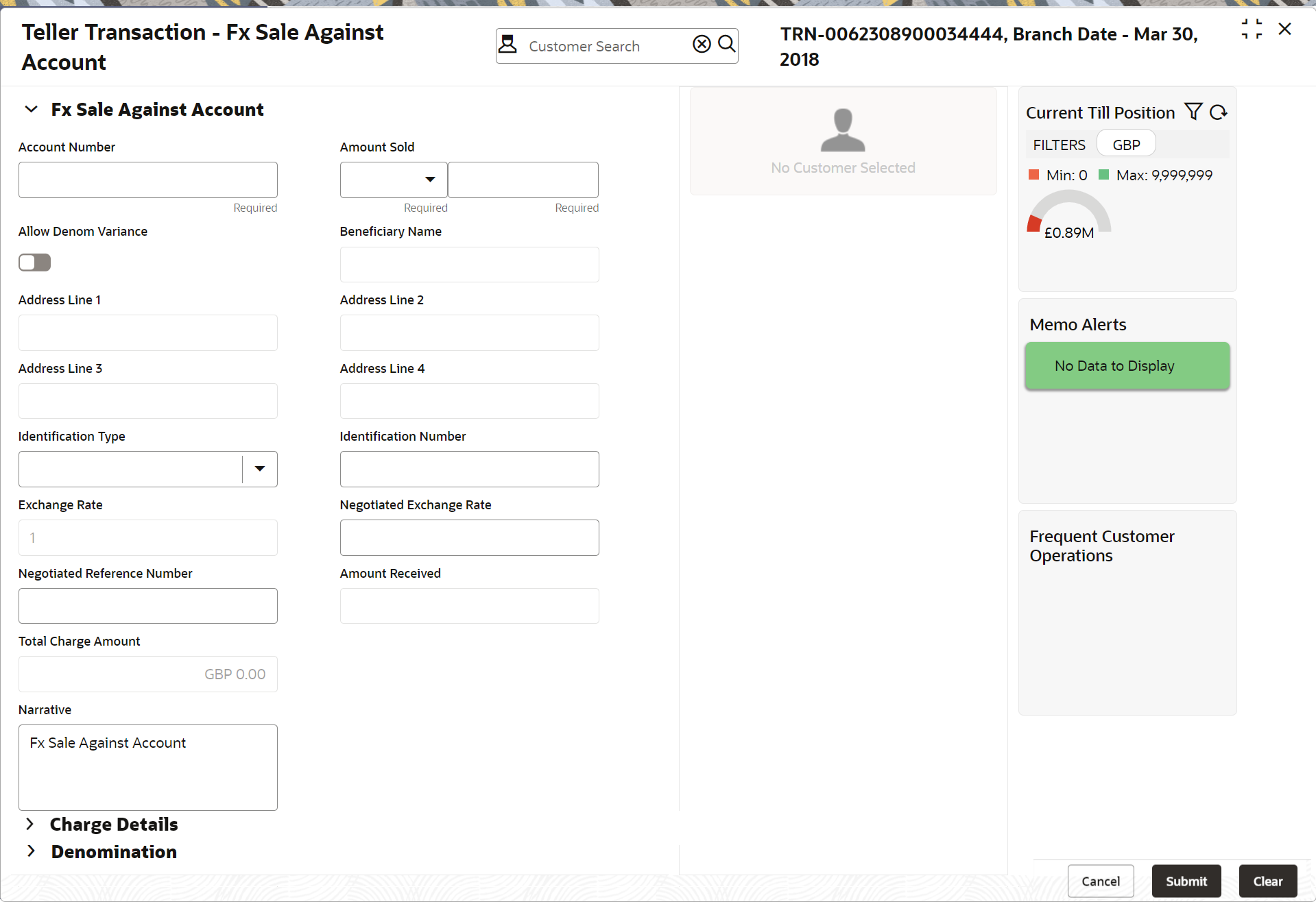

  1. On the Home screen, from Teller mega menu, under Customer TransactionForex Transactions, click FX Sale - Account or specify FX Sale - Account in the search icon bar and select the screen.
    The FX Sale Against Account screen is displayed.
    Figure 7-5 FX Sale Against Account
  2. On the FX Sale Against Account screen, specify the fields. For more information on fields, refer to the field description table.

  3. Specify the charge details. For information on the fields in the Charge Details segment, refer to Charge Details.
  4. Specify the FX Out Denomination details. For information on the fields in the Denomination Details segment, refer to Add Denomination Details.
  5. Click Submit.
    A teller sequence number is generated, and the Transaction Completed Successfully information message is displayed.
