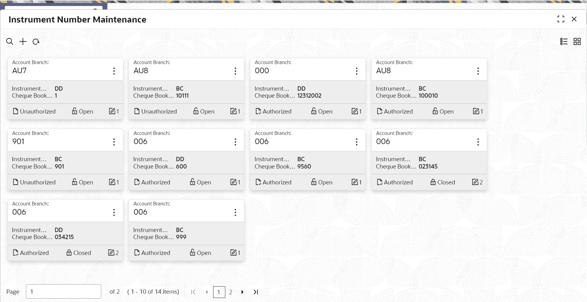

Figure 9-21 Instrument Number Maintenance (Summary)

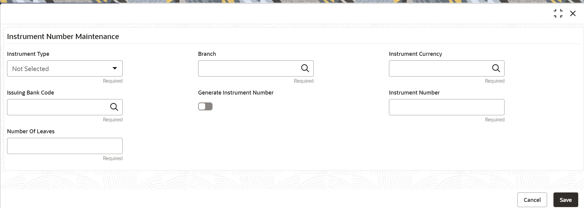

icon.The Instrument Number Maintenance (New) screen is displayed. - On the Instrument Number Maintenance screen, specify the
fields. For more information on fields, refer to the field description
table.
The fields marked as Required are mandatory.Figure 9-22 Instrument Number Maintenance (New)
Table 9-16 Instrument Number Maintenance - Field Description
Field Description Instrument Type
Specify the instrument type for which the instrument maintenance needs to be done. Select the type of Instrument Type from below values:
- Demand Draft
- Bankers Cheque
- Demand Draft-FCY
Branch
Select the branch code from the list of values.
Instrument Currency Click Search icon and select the currency code from the list of values. Issuing Bank Code Click Search icon and select the bank code from the list of values. Generate Instrument Number
Specify Generate Instrument Number as Yes/No by selecting the radio-button.
When Instrument Number generation mode is set to Manual in OBPM.- If Instrument Number should be auto Generated by Branch during DD Issuance. Then the Generate instrument number should be enabled in Instrument Number Maintenance in OBBRN.
- If Instrument Number should be manually input by Branch User during DD Issuance. Then the Generate instrument number should be disabled in Instrument Number Maintenance in OBBRN.
Instrument Number
Specify the cheque number for which the instrument maintenance needs to be done.
Number of Leaves
Specify the number of leaves.
