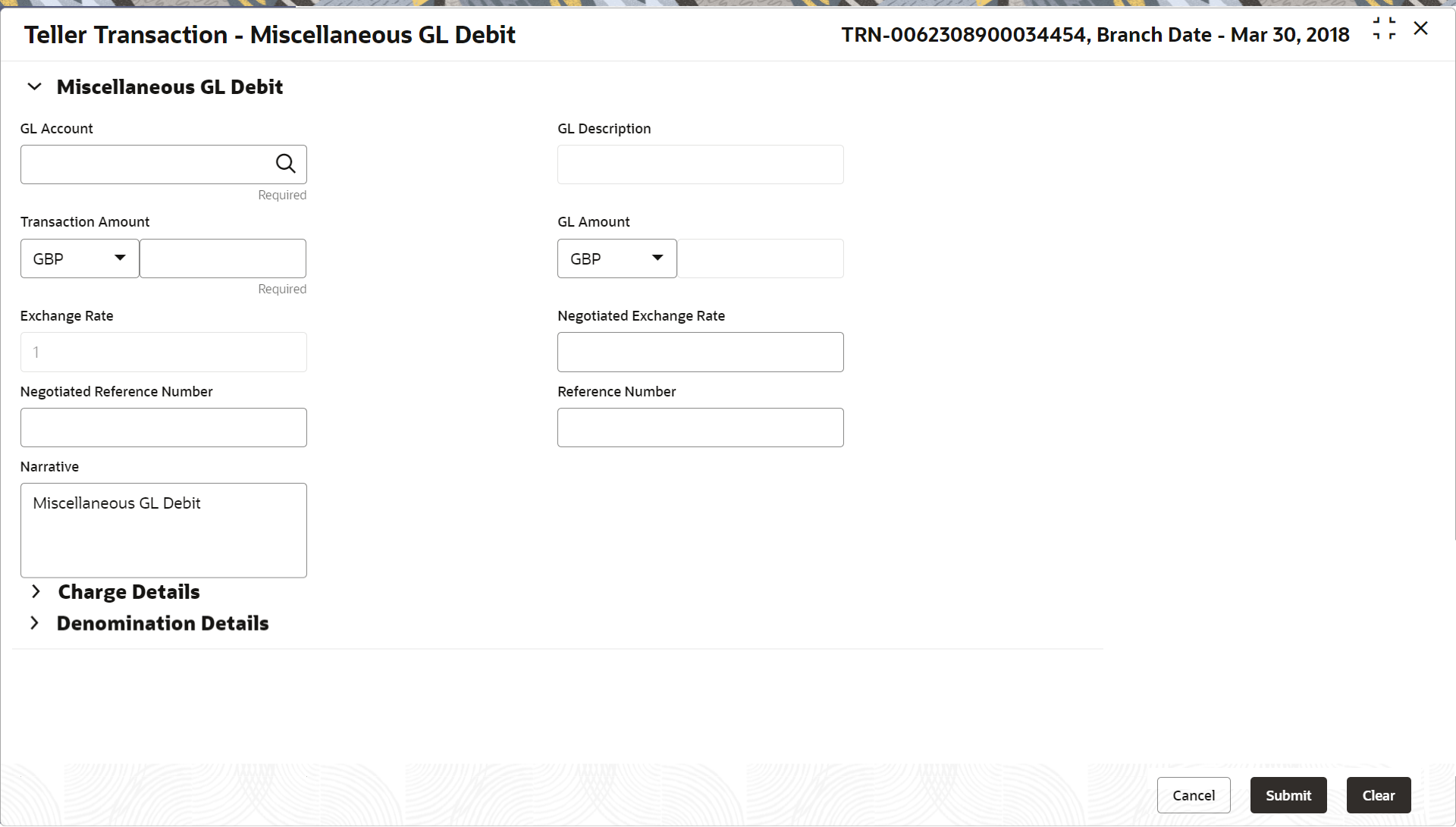

The Miscellaneous GL Debit screen is used to debit an amount from a GL account of the transaction branch and pay out the equivalent amount in cash.
- On the Home screen, from Teller mega menu, under Miscellaneous, click Misc GL Debit or specify Misc GL Debit in the search icon bar and select the screen.The Miscellaneous GL Debit screen is displayed.
- On the Miscellaneous GL Debit screen, specify the fields. For more information on fields, refer to the field description
table.

- Specify the charge details. For information on the fields in the Charge Details segment, refer to Charge Details.
- Specify the denomination details. For information on the fields in the Denomination Details segment, refer to Add Denomination Details.
- Click Submit.A teller sequence number is generated, and the Transaction Completed Successfully information message is displayed.
The transaction is moved to authorization in case of any warning raised when the transaction saves. On transaction completion, the cash balance of the Teller is updated successfully.
