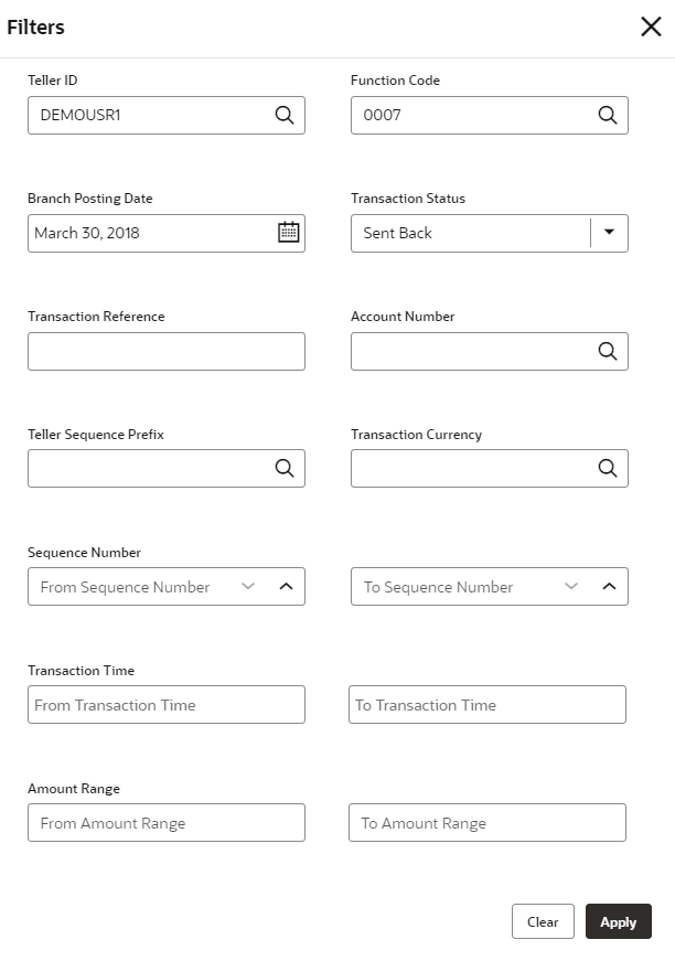

icon to filter the results on the tile/grid view based on the search criteria.The Filters overlays screen is displayed. - On the Filters overlays screen, specify the details to fetch the records. For more information on fields, refer to the field description
table.
Table 6-8 Filters - Field Description
Field Description Teller ID
Specify the Teller ID.Note:
You can also click the search icon and select the Teller ID from the list of values.Function Code
Specify the function code for which the inquiry is to be made.Note:
You can also click the search icon and select the function code from the list of values.Branch Posting Date
Specify the branch posting date for which the inquiry is to be made.Note:
By default, the current posting date is displayed.Transaction Status
Select the transaction status from the drop-down values.Note:
By default, Sent Back status is selected.Transaction Reference
Specify the transaction reference number.
Account Number
Specify the account number.Note:
You can also click the search icon and select the account number from the list of maintained account numbers.Teller Sequence Prefix
Click the search icon and select from the list of values.
Transaction Currency
Click the search icon and select the transaction currency from the list of values.
From Sequence Number
Specify the start number of the sequence range.
To Sequence Number
Specify the end number of the sequence range.
From Transaction Time
Specify the start time for filtering transactions executed within the given time range.
To Transaction Time
Specify the end time for filtering transactions executed within the given time range.
From Amount Range
Specify the “from” amount of the amount range.
To Amount Range
Specify the “to” amount of the amount range.
- Click Apply.The Servicing Journal screen displays.

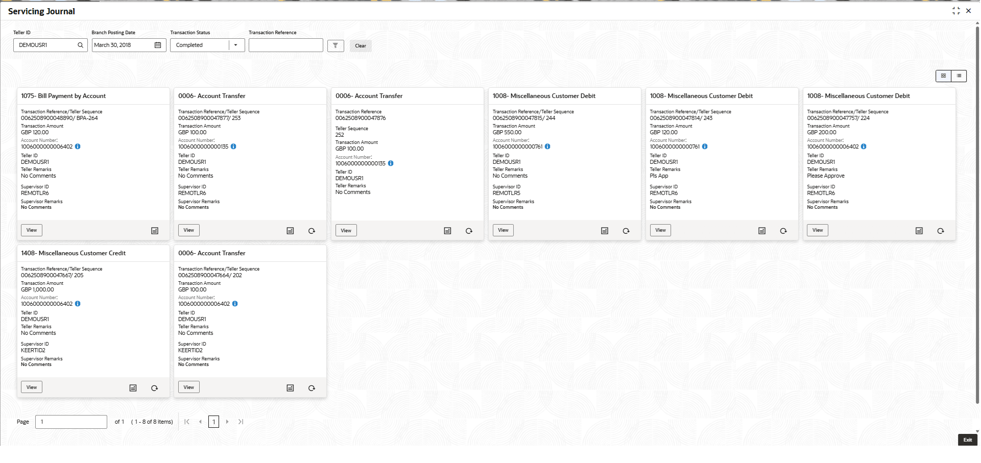

Figure 6-9 Servicing Journal (List View) - Completed Transaction Status

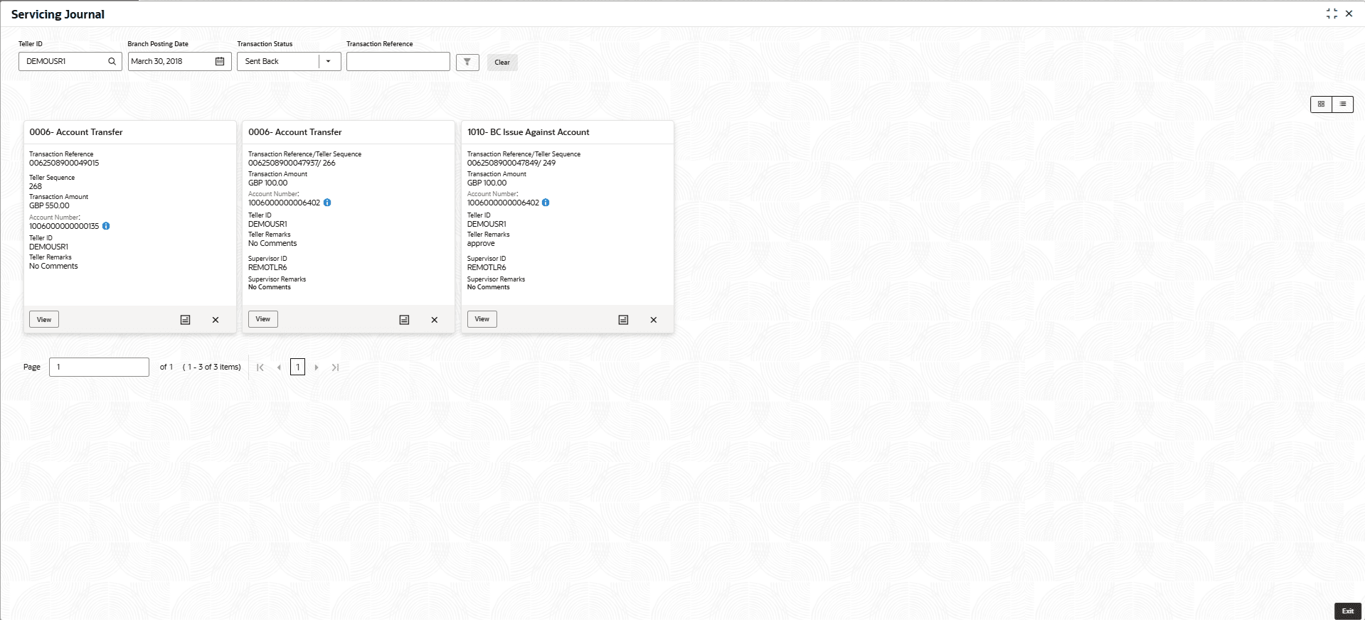

Figure 6-10 Servicing Journal (List View) - Sent Back Transaction Status
