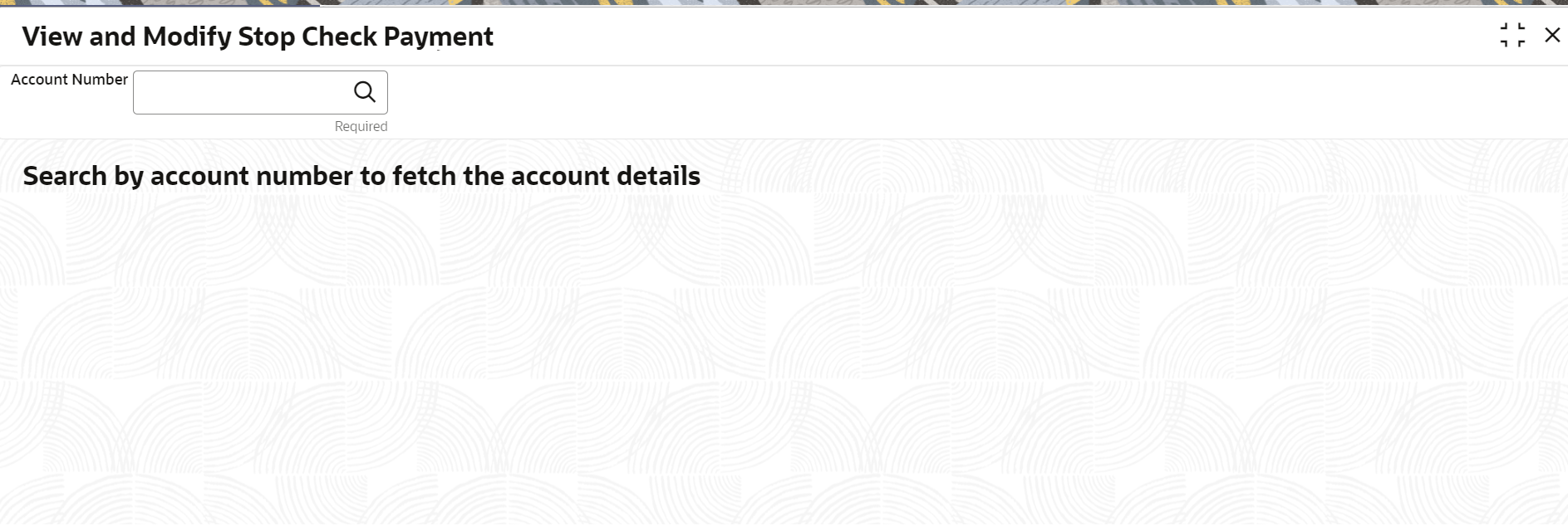

  1. On the Home screen, from Account Services, under Check Book, click View and Modify Stop Check Payment, or specify the View and Modify Stop Check Payment in the Search icon bar.
    The View and Modify Stop Check Payment screen is displayed.
    Figure 3-67 View and Modify Stop Check Payment
    Description of Figure 3-67 follows
    Description of "Figure 3-67 View and Modify Stop Check Payment"
  2. On the View and Modify Stop Check Payment screen, click the Search icon or specify the account number in the Account Number field, and press Tab or Enter.

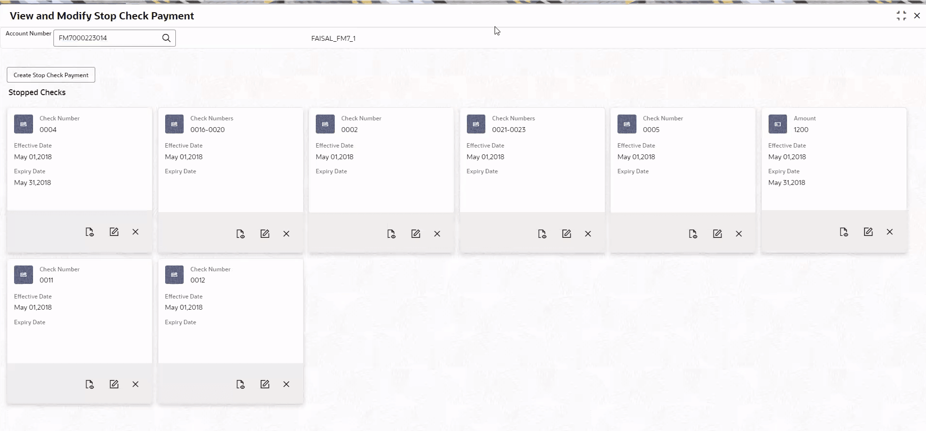

    The details are dislayed in the Stopped Checks section.
    If there are no stop payment records available for a given account number, the system displays a message that there are no stopped payments for the account.
  3. On the View and Modify Stop Check Payment screen, you can view a summary of the stopped checks for the account. For more information on fields, refer to the field description table.

    Stopped Checks This section lists all the checks for which the payments are stopped.
    Amount, Check Numbers, or Check Number Displays the type of stop check payment created for the account.
    While creating the stop check payment:
    • If you select the Amount option, then Amount is displayed in the widget.
    • If you select the Range of Checks option, then Check Numbers is displayed in the widget.
    • If you select the Single Check option, then Check Number is displayed in the widget.
    For more informtion on creating stop check payment, refer Stop Check Payment screen.
    Effective Date Displays the effective date from when the stop check payment is active.
    Expiry Date Displays the end date till when the stop check payment should be active.
  4. On the View and Modify Stop Check Payment screen, you can perform any of the following actions:
    • Create Stop Check Payment: The Stop Check Payment screen is displayed. You can perform the required action in this screen. For more information, refer the Stop Check Request screen.
    • View Stop Check Payment Details: The Stop Check Payment screen is displayed. For more information, refer View Stop Check Payment.
    • Modify Stop Check Payment: The Stop Check Payment screen is displayed. For more information, refer Modify Stop Check Payment.
    • Close Stop Check Payment: The Stop Check Payment screen is displayed. For more information, refer Close Stop Check Payment.
