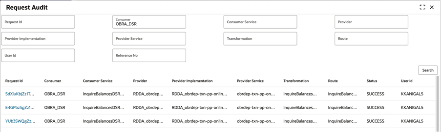

For requests identified as timeout:
  1. Search the corresponding consumer from the Request Audit menu.

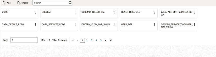

  2. From the Service Consumers menu, search OBRA_DSR, and select the option.

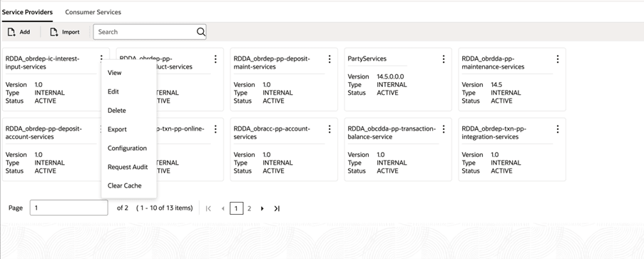

  3. In the Service Providers tab, click More Options, and select Configuration.
    Figure 6-3 Service Providers tab
  4. From the Provider Level Timeout field, switch the toggle to ON.
  5. In the Connection Timeout and Read Timeout fields, specify the value as 180000.
