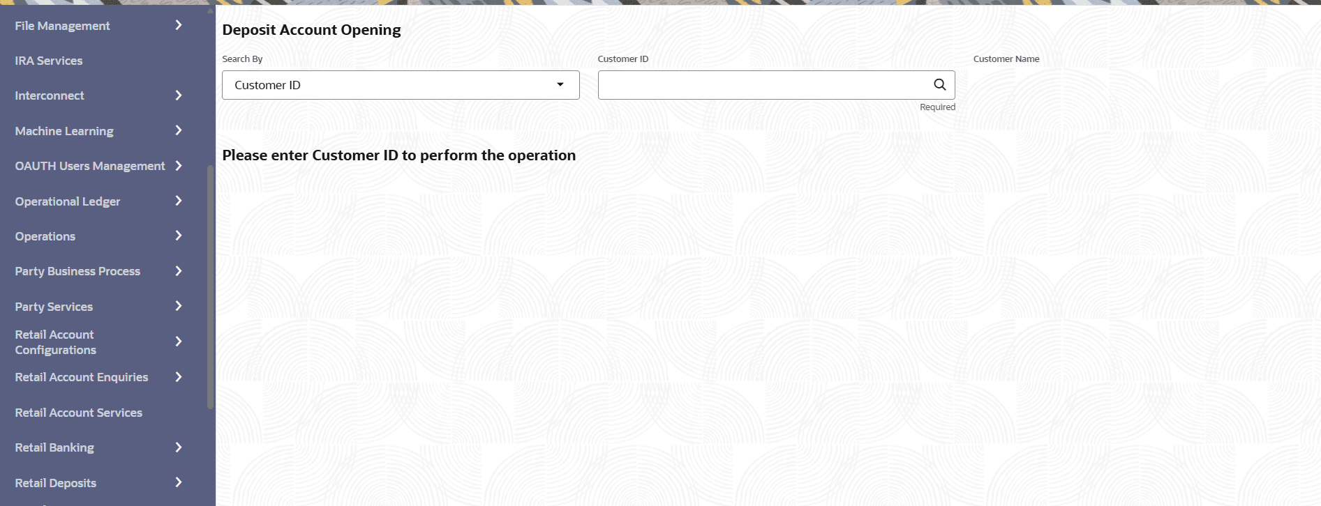

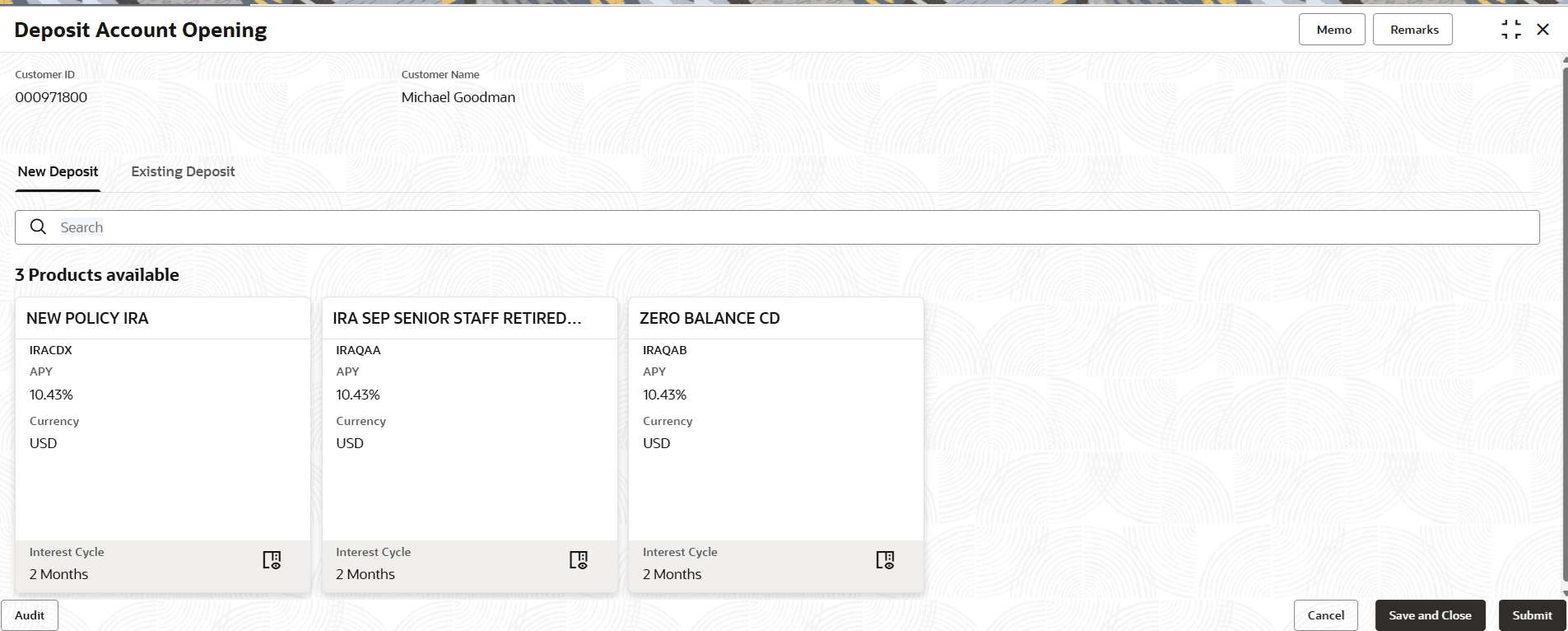

  1. On the Homepage, from the IRA Services click Deposit Account Opening, or specify Deposit Account Opening in the search icon bar and select the screen.
    The Deposit Account Opening screen is displayed.
    Figure 3-1 Deposit Account Opening
  2. Select the appropriate option from the Search by field.
  3. Perform the required action, based on the option selected from the Search by field.
    All available CD account deposit accounts are displayed by the system.
    Figure 3-2 Deposit Account Opening - Product Details

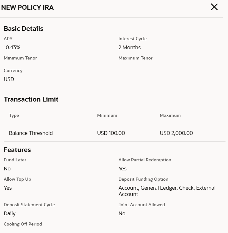

  4. On the Deposit Account Opening screen, click Search bar to search for products based on the product code, product description, and currency to search or filter the deposit products.
  5. Click View icon in the product widget, to view additional details of the product.
    The account detail screen is displayed with basic product details and allowed features.
    Figure 3-3 Deposit Account Opening - View Product Details
    For more information on fields, refer to field description table below:
    Table 3-2 New Deposit - View Details – Field Description
    Field Description
    Basic Details This section displays the basic details of the account.
    APY Displays the APY percentage of the deposit.
    Interest Cycle Displays the deposit's interest cycle.
    Minimum Tenor Displays the minimum tenor for deposit.
    Maximum Tenor Displays the maximum tenor for deposit.
    Currency Displays the deposit amount currency.
    Transaction Limit This section displays the transaction limit details.
    Type Displays the transaction type.
    Minimum Amount Displays the minimum transaction limit amount.
    Maximum Amount Displays the maximum transaction limit amount.
    Features This section displays the features of the deposit account.
    Fund Later Displays whether funding has to be done later.
    Allow Partial Redemption Displays whether partial redemption is allowed on the account or not.
    Allow Top Up Displays whether top up is allowed on the account or not.
    Deposit Funding Option Displays the allowed funding options. The possible options are:
    • Ledger
    • Account
    Deposit Statement Cycle Displays the statement cycle maintained for the deposit.
    Joint Account Allowed Displays whether joint account is allowed for the account.
    Cooling Off Period Displays the cooling off period for the account, if any.

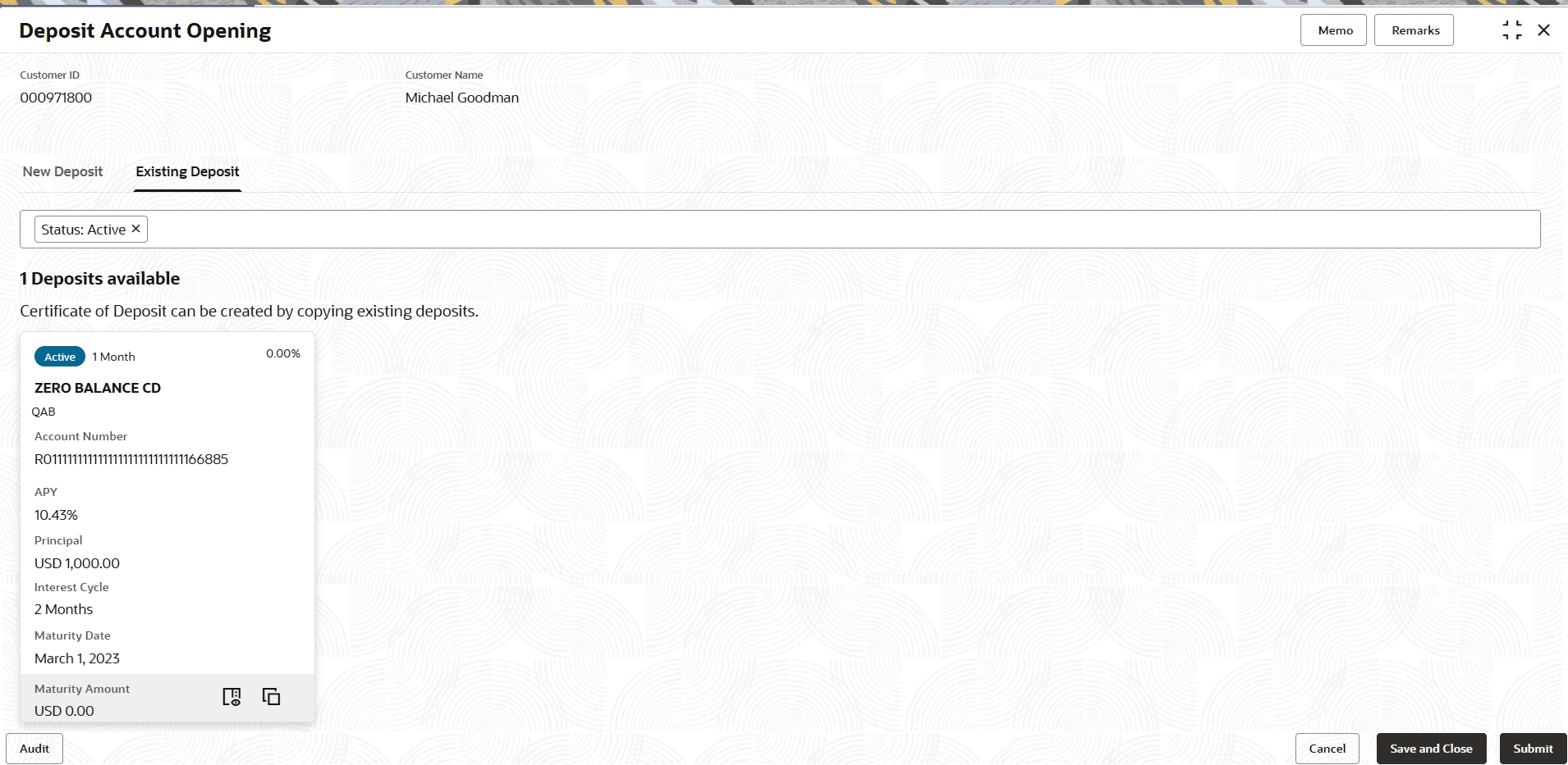

  6. Click Existing Deposit tab.
    The customer sees all available deposit accounts displayed by the system, with the default setting showing active account details.
    Figure 3-4 Deposit Account Opening - Existing Deposit

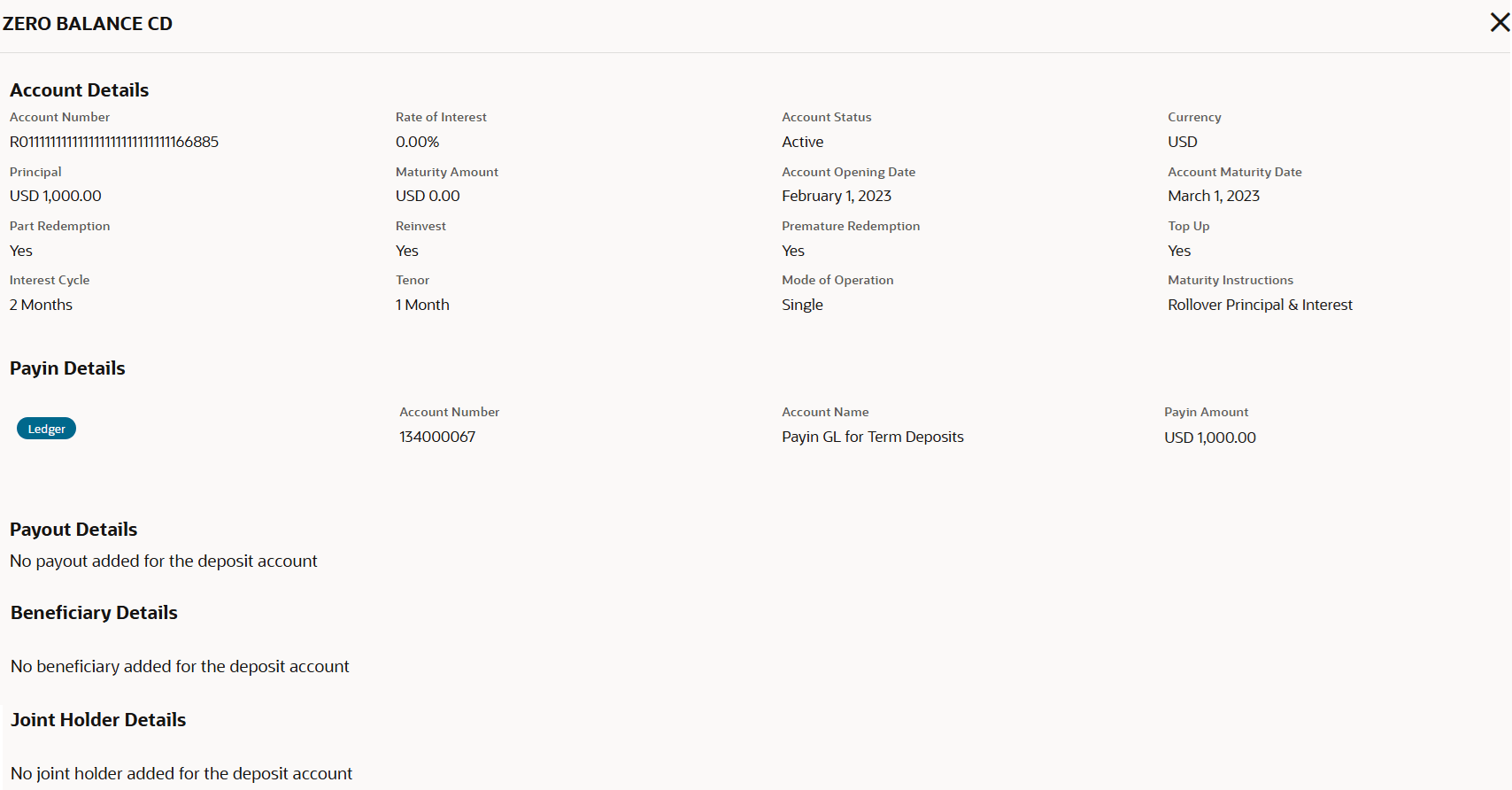

    The view screen is displayed with account details, payin details, payout details, beneficiary details and joint holder details if available.
    Figure 3-5 View Existing Account Details
    Table 3-4 View Existing Account Details - Field Description
    Field Description
    Account Details This section the existing account details.
    Account Number Displays the deposit account number.
    Rate of Interest Displays the current rate of interest.
    Account Status Displays the current deposit account status.
    Principal Displays the principal amount.
    Maturity Amount Displays the matured deposit amount.
    Account Opening Date Displays the date on which the deposit account is opened.
    Account Maturity Date Displays the maturity date of the deposit.
    Part Redemption Displays whether part
    Reinvest Displays whether the reinvest is applicable for the deposit account.
    Premature Redemption Displays whether premature redemption is allowed on the account.
    Top Up Displays whether top up is allowed on the account.
    Interest Cycle Displays the interest cycle set for the deposit account.
    Tenor Displays the tenor for deposit account.
    Mode of Operation Displays the mode of operation for the account.
    Maturity Instructions Displays the maturity instructions for the deposit which is defaulted from the product.

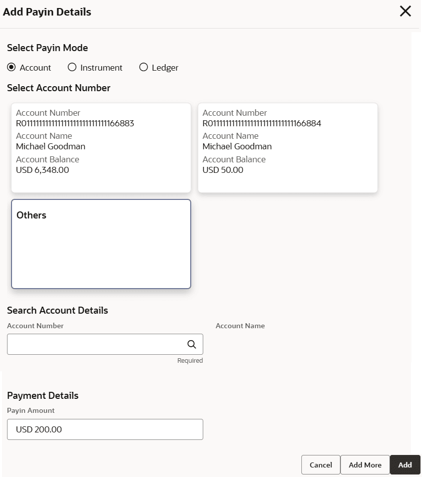

    Payin Details This section displays payin details of the deposit account.
    <Account Type> Displays the type of account.
    Account Number Displays the payin account number.
    Account Name Displays the payin account name.
    Payin Amount Displays the payin amount.
    Payout Details This section displays the payout details of the account, if they are already added.
    Beneficiary Details This section displays the beneficiary details of the account, if they are already added.
    Joint Holder Details This section displays the joint holder details of the account, if they are already added.
  9. On Deposit Account Opening screen, the user will be able to create new CD in two methods.
    They are as follows:
    • Copying the existing account to create new deposit
    • Selecting the product to create new deposit.
    The two methods are explained in the below steps.
  10. Click Copy icon in the existing account tile, to copy the existing details of an account.

    • The payin details will not be defaulted, if the Payin account is closed or payin GL is not valid for the branch.

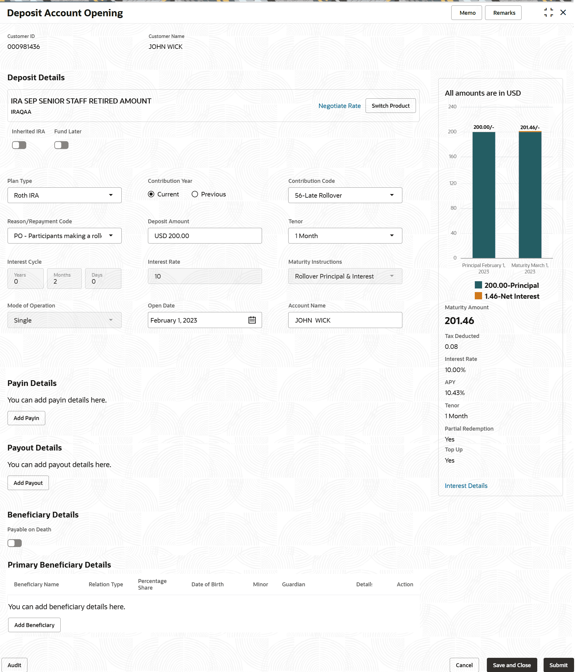

  11. On the Deposit Account Opening screen, select the product to create a new deposit account.
    A minor can open an account, with an adult or emancipated minor as joint holders.
    The Deposit Account Opening is displayed with the Deposit Details fields to specify the details.
    Figure 3-6 Deposit Account Opening - Deposit Details
  12. Perform the required actions on the Deposit Details section. For more information on fields, refer to field description table below:
    Table 3-5 Deposit Account Opening - Deposit Details – Field Description
    Field Description
    <Product Name>
    Displays the name of the deposit product selected.
    <Product Description>
    Displays the description of the deposit product selected.

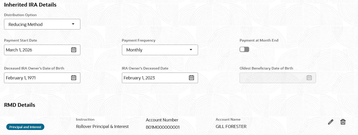

    Inherited IRA Switch the toggle ON, to inherit the IRA account.
    Fund Later Switch the toggle ON, to fund later to the account.
    This field is set as ON and is not enabled, if the Inherited IRA toggle is ON.
    Plan Type Select the plan type for the deposit account. The options are:
    • Traditional IRA
    • Roth IRA
    • Simplified Employee Pension IRA
    Contribution Year Select the year of contribution. The options are:
    • Current
    • Previous
    Reason/Repayment Code Select the reason or repayment code for the deposit.
    This field is enabled if 56-Late Rollover or 60-Qualified Distribution Repayment is selected from the Contribution Code field.
    Contribution Code Select the code of contribution for the account,
    Deposit Amount When user Specify the deposit amount, the system simulate the maturity amount and interest details based on given deposit amount, defaulted tenor, and account opening date.
    This field is not enabled, if the Fund Later toggle is ON.
    Tenor Select the tenor for the deposit.
    Interest Cycle Displays the cycle for charging the interest. The interest cycle is displayed in Years, Months, and Days.
    By default, the interest cycle is set based on the product. If required, users can modify it. The interest cycle can be set to Years, Months, Days or combination of year, month and days.
    This field can only be modified if the Account Level Liquidation Preferences option is enabled at the Interest and Charge product level.
    Interest Rate Displays the interest rate of the deposit and it is defaulted from the product, when you specified the deposit amount.
    Maturity Instructions The product displays its default maturity instructions, which the user can modify.
    If auto-rollover is disabled for the product, it displays only Redeem Principal and Interest or Redeem Principal.
    Mode of Operation Displays the mode of operation from the drop-down. The possible options are:
    • Single
    • Jointly
    • Either Anyone or Survivor
    • Former or Survivor
    • Mandate Holder
    If the Mode of Operation is single, the Joint Holder Details will not be displayed.
    Open Date Select or specify the account opening date.
    Account Name Displays the customer name as the account name and the user is allowed to modify the name.
    If the user wishes to change the selected product before the save/submit operation, click Switch Product in the deposit details screen, and the system displays a confirmation message related to clearing the input details. On confirmation, all input details are cleared and the user will navigate to the product selection screen.

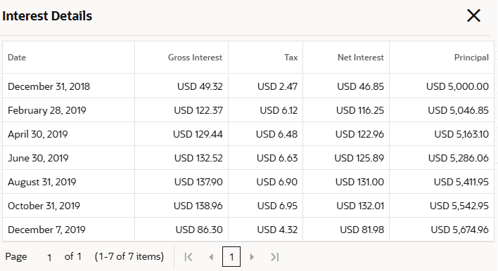

  15. Click Interest Details link in the simulation widget to view the interest details.
    1. Click Interest Details link in the simulation widget to view the interest details.
      The Interest Details screen is displayed. For more information on fields, refer to field description table below:
      Table 3-7 Interest Details - Field Description
      Field Description
      Date Displays the date of the interest cycle.
      Gross Interest Displays the gross interest amount.
      The amount will display both the Reinvest Yes and Reinvest Nos cases.
      Tax Displays the tax interest amount.
      Net Interest Displays the total net interest.
      Net Interest will be calculated as, Gross Interest - Tax.
      Principal Displays the interest principal amount.
  16. If the Inherited IRA toggle is ON, then the following sections are displayed:
    Table 3-8 Inherited IRA – Field Description
    Field Description
    Inherited IRA Details This section displays the Inherited IRA details to be maintained for the account.
    Distribution Option Select an appropriate distribution option from the list. The options are:
    • Distribute over Spouse's Life
    • Distribute Using IRA Owner's Date of Death
    • Five Year Rule
    • Ten Year Rule
    • Use Non-Spouse Beneficiary's Age in IRA Owner's Year of Death
    • Use Non-Spouse Beneficiary's Age at Year End Following IRA Owner's Year of Death
    • Use Oldest Age of Multiple Beneficiaries
    • Reducing Method
    • Lump Sum Distribution
    Payment Start Date Select or specify the start date for the payment.
    Payment Frequency Select the required option for the payment frequency. The options are:
    • Monthly
    • Quarterly
    • Annual
    Payment at Month End Switch the toggle ON, if the payment is to be done on month end.
    Deceased IRA Owner's Date of Birth Select or specify the date of birth of the deceased IRA owner.
    IRA Owner's Deceased Date Select or specify the deceased date of the IRA owner.
    Oldest Beneficiary Date of Birth Select the date of birth of the oldest beneficiary.
    RMD Details This section displays the RMD details to be maintained for the account.
    <Component> Displays the component.
    Instruction Displays the instruction set for the account.
    Account Number Displays the payout account number.
    This field is displayed, if Account option is selected from the Select Payout Mode field, in the Add Payout Details section.
    Account Name Displays the payout account name.
    Ledger Code Displays the payout ledger code.
    This field is displayed, if Ledger option is selected from the Select Payout Mode field, in the Add Payout Details section.
    Ledger Description Displays the payout ledger description.
    <Actions> Displays the following icons:
    • Edit: Click to edit the RMD payout details.
    • Delete: Click to delete the RMD payout entry.

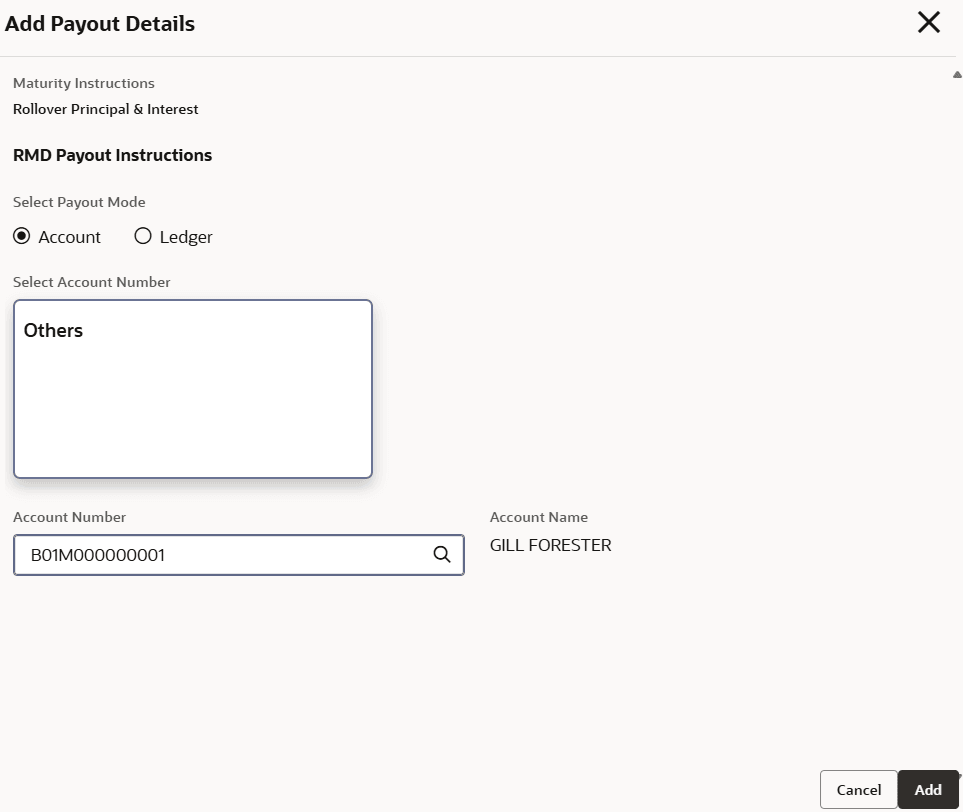

  17. If no details are no RMD details added, then Add RMD Details button is displayed in the RMD Details section. This section is displayed if Inherited IRA toggle is ON.
    The Add Payout Details section is displayed.
    Figure 3-10 RMD Details - Add Payout Details
    1. In the Add Payout Details section, specify the fields. For more information on fields, refer to field description table below:
      Table 3-9 RMD Details - Add Payout Details – Field Description
      Field Description
      Maturity Instructions Displays the maturity instruction set for the account.
      RMD Payout Instructions This section displays instructions to be maintained for the RMD payout.
      Select Payout Mode Select the appropriate payout mode. The options are:
      • Account
      • Ledger
      Select Account Number Select the required account number to be used for payout.
      • This field is displayed if Account option is selected Select Payout Mode field.
      • Only Others option is displayed in this field.
      Account Number Select the account number for the payment.
      As user searches the account number, an Account Number section is displayed. User can specify the Customer ID, Account Number, or Account Name, and click Fetch. Select the required account number from the search result.
      Account Name Displays the account name associated with the selected account number.
      Ledger Details This section displays the ledger details.
      This field is displayed if Ledger option is selected Select Payout Mode field.
      Ledger Code Select the ledger code from the list for the payment.
      Ledger Description Displays a description for the ledger code selected. If required, user can edit the description.
    2. Click Add.
      The details are added and displayed in the RMD Details section.

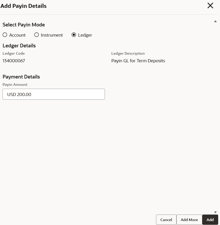

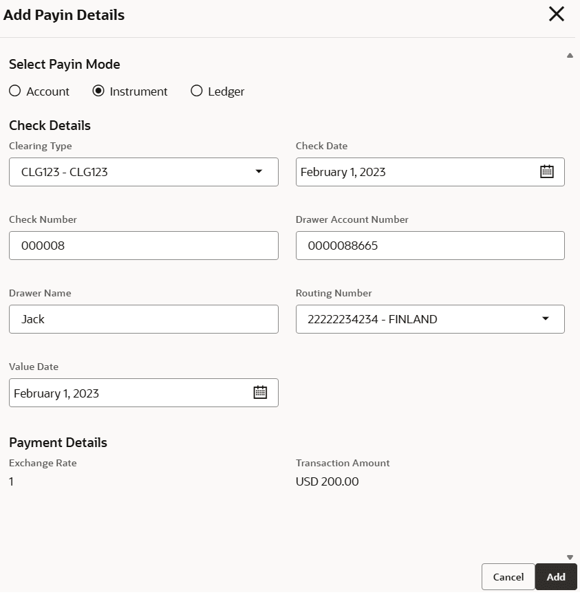

  18. Click Add Payin, in the Payin Details section on the Deposit Account Opening screen.
    The Add Payin Details screen is displayed.
    The system will defaults the payin account to pay the deposit amount if the customer has an active Current and Saving Account with sufficient balance, the accounts where deposit currency and account currency are same, and the single-match account is found.
    If the user wants to modify the defaulted payin details, click Change Default Payin. Then the system will delete the defaulted payin details and open the Add Payin Details screen.
    Figure 3-11 Add Payin Details - Accounts
    Figure 3-12 Add Payin Details - Instrument
    Figure 3-13 Add Payin Details - Ledger
    1. Perform the required action for payin details as an account. For more information on fields, refer to field description table below:
      Table 3-10 Add Payin Details as Account
      Field Description
      Select Payin Mode The Account mode is selected by default.
      Select Account Number The own accounts are displayed as widgets with the Account Number, Account Name, and Account Balance. You can select the account for CD payin.
      You can select Others from the widget to select any other accounts in the same bank for CD payin.
      Search Account Details This will display, if you select Others from the widgets.
      click the Search icon to select from the list or specify the account number in the Account Number field and the Account Name is displayed adjacent to the account number.
    1. Perform the required action for payin details as instrument. For more information on fields, refer to field description table below:
      Table 3-11 Add Payin Details as Instrument - Field Description
      Field Description
      Select Payin Mode Select the Instrument option for the payin mode.
      Check Details This section displays the check details for payin.
      Clearing Type Select the clearing type of the instrument.
      Check Date Select or specify the date on the check.
      Check Number Specify the check number.
      Drawer Account Number Specify the account number of the drawer.
      Drawer Name Specify the name of the drawer.
      Routing Number Select the routing number for the instrument.
      Value Date Select or specify the value date.
      Payment Details This section displays the details related to payments.
      Exchange Rate Displays the current exchange rate.
      Transaction Amount Displays the transaction amount for payin.
    1. Perform the required action for payin details as ledger. For more information on fields, refer to field description table below:
      Table 3-12 Add Payin Details as Ledger
      Field Description
      Select Payin Mode Select the Ledger option to perform the settlement.
      Ledger Code Displays the ledger code used for the transaction.
      Ledger Description Displays the ledger description used for the transaction.
      Payin Amount Displays the amount and also you can modify the amount.
    1. Click Cancel, to close the Add Payin Details screen without adding the payin details.
    1. Click Add More, the system add the payin details in the main screen and refreshes the Add Payin Details screen with default values, and the payin amount is updated for the remaining payin amount.
    1. Click Add to add the payin details in the main screen.

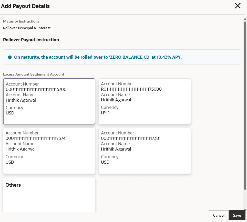

  19. Click on Add Payout, in the Payout Details section on the Deposit Account Opening screen.
    The Add Payout Details screen is displayed.
    The system will defaults the payout account if the customer has an active Current and Saving Account, the accounts where deposit currency and account currency are same, and the single-match account is found.
    If the user wants to modify the defaulted payin details, click Change Default Payout. Then the system will delete the defaulted payin details and open the Add Payout Details screen.
    1. If the user specifies the Deposit Amount, then on click of Add Payout.
    2. In the Add Payout Details section, specify the fields. For more information on fields, refer to field description table below:
      Table 3-13 Add Payout Details - Field Description
      Field Description
      Maturity Instructions Displays the maturity instruction selected for the payout.
      Rollover Payout Instruction
      This section displays the details of the rollover product instruction. The default rollover product configured for the business product is shown here along with its APY details.
      Users are allowed to modify the rollover product at the account level only if Rollover to New Product is enabled for the business product. Users can also define the account to settle any excess amount during rollover if the maturity amount exceeds the rollover product's maximum threshold limit.
      Select Product Select the product to define the rollover product at the account level.
      During rollover, the product defined at the account level will take precedence. The product drop-down fetches all active deposit business products with their product code, product name, and APY details.
      Excess Amount Settlement Account Select the account to settle any excess amount during rollover. The tile displays the primary holder's active accounts with details such as account number, account name, and currency.
      Click the tile to select the account. An option is also provided to select accounts other than the primary holder's. On clicking Other, an Account Number field is displayed, allowing the user to select accounts other than the primary holder’s across branches.
    3. Click Add.
      The added payout details are added successfully and displayed in the Payout Details section.
    1. Click Cancel, to close the Add Payout Details screen without adding the payin details.
    1. Click Add More, the system add the payout details in the main screen and refreshes the Add Payout Details screen with default values, and the payout amount is updated for the remaining payout amount.
    1. Click Add to add the payout details in the main screen.
  20. Click on Add Beneficiary, in the Beneficiary Details section on the Deposit Account Opening screen.
    The Add Beneficiary Details screen is displayed.
    For more information about Add Beneficiary Details, refer to the Beneficiary Details Update.
  21. Click on Add Joint Holder, in the Joint Holder Details section on the Deposit Account Opening screen.
    The Add Joint Holder Details screen is displayed.
    For more information about Add Joint Holder Details, refer to the Joint Holder Maintenance.
  22. After adding the Add Payin, Add Payout, and Add Beneficiary details, the Deposit Account Opening screen displays the added information.
  23. Click Submit.
    The screen is successfully submitted for authorization.
    The CD account number is displayed when the CD account creation is successful.
