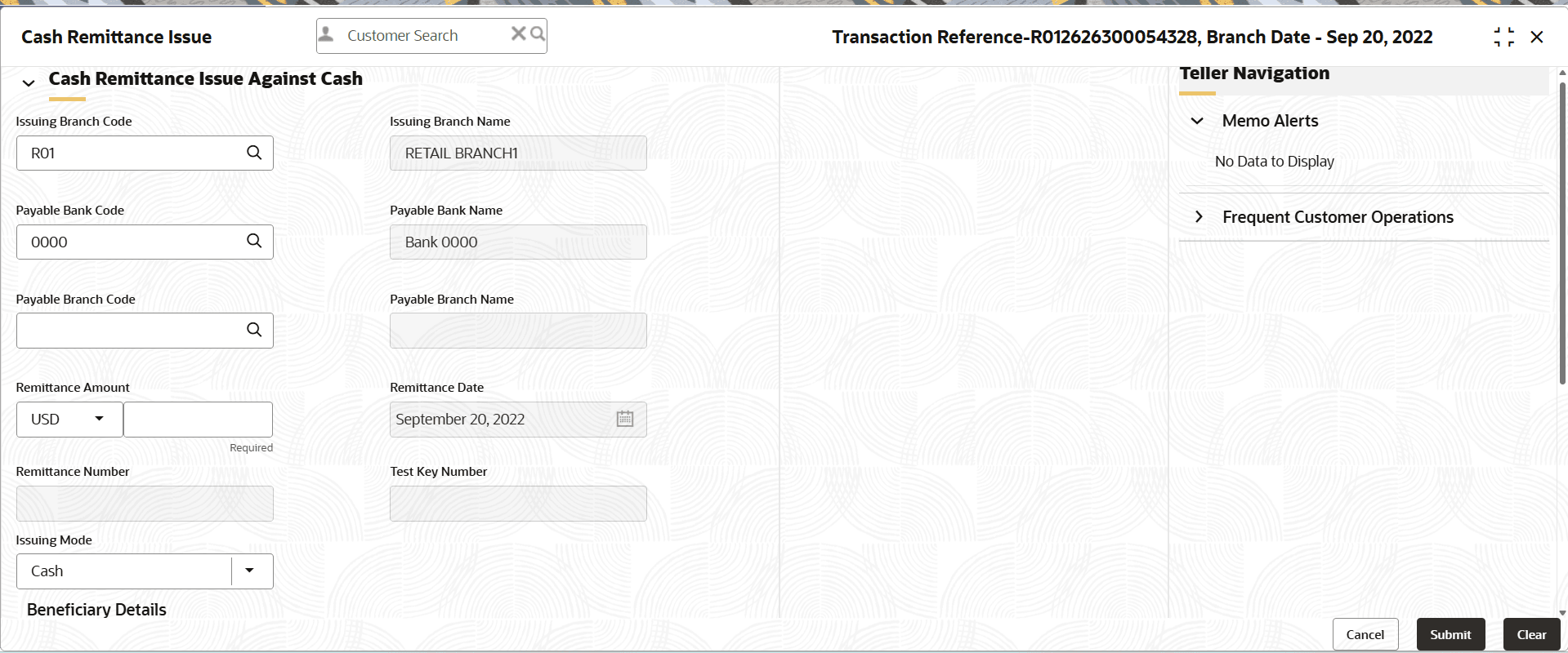

The Cash Remittance Issue Against Cash screen is used to remit funds across branches of the same bank and across banks. Reversal of cash remittance issuance is supported through EJ.
The cash remittance is performed against the cash from the remitter when the issuing mode is Cash.
To perform cash remittance issue against cash:
  1. On the Home page, from Teller mega menu, under Remittances, click Cash Remittance Issue or specify Cash Remittance Issue in the search bar and select the screen.
    The Cash Remittance Issue Against Cash screen is displayed.
    Figure 5-45 Cash Remittance Issue Against Cash
  2. On the Cash Remittance Issue Against Cash screen, specify the fields. For more information on fields, refer to Table 5-43.
