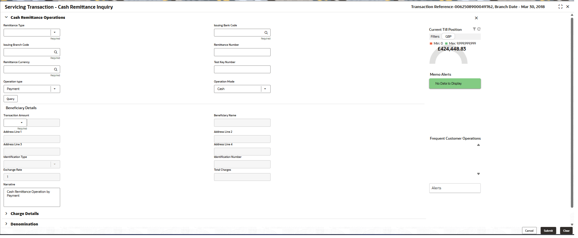

    Figure 5-50 Cash Remittance Operations (Payment by Cash)
  2. On the Cash Remittance Operations screen, specify the fields. For more information on fields, refer to the field description table.
    The fields marked as Required are mandatory.
    Table 5-48 Cash Remittance Operations (Payment by Cash) - Field Description
    Field Description
    Remittance Type
    Select the Remittance Type from the drop-down list.
    RI = Remittance-Inward
    RO = Remittance-Outward
    Issuing Bank Code
    Specify the code of the issuing bank.
    Issuing Branch Code
    Select the branch code where the remittance is issued.
    Test Key No
    Specify the test key number.
    Remittance No
    Specify the remittance number.
    Operation Type
    Select the type Payment from the drop-down list.
    Operation Mode
    Select the operation mode as Cash from the drop-down values.
    Query
    Click Query to fetch the remittance details.
    Note: When user click this icon, after user specify the Issue Branch Code and Remittance No, the system will make a service call to Oracle Banking Payments and fetch the remittance details.
    Beneficiary Details
    Specify the details under this segment.
    Transaction Amount
    Displays the transaction currency and a transaction amount.
    Note: By default, the local branch currency is displayed as transaction currency and it can be modified.
    Beneficiary Name
    Specify the beneficiary's name.
    Address Line 1 to Address Line 4
    Specify the address of the beneficiary.
    Identification Type
    Select the identification type of the beneficiary from the drop-down values.
    Identification No
    Specify the identification number of the beneficiary.
    Exchange Rate
    Displays the exchange rate, and it can be modified.
    Note: If the transaction currency is the same as the account currency, the system will display the exchange rate as 1. This field is displayed only if Multi-Currency Configuration at the Function Code Indicator level is set as Y.
    Total Charges
    Displays the total charge amount.
    Note: This field is displayed only if Total Charges Configuration at the Function Code Indicator level is set as Y.
    Narrative
    Displays the default narrative as Cash Remittance Operation by Payment, and it can be modified.
