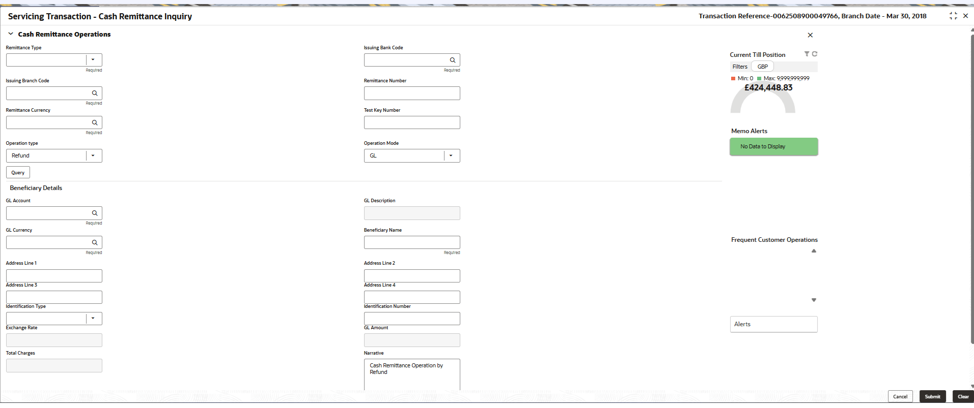

5.3.2.7 Cash Remittance Refund by GL
The Teller can use the Cash Remittance Operations screen to refund the amount against a cash remittance.
The refund amount is credited to the GL account when the operation mode is GL.
To refund the amount:
  1. On the Home page, from Teller mega menu, under Remittances, click Cash Remittance Operations or specify Cash Remittance Operations in the search bar and select the screen.
    The Cash Remittance Operations screen is displayed.
    Figure 5-55 Cash Remittance Operations (Refund by GL)
  2. On the Cash Remittance Operations screen, specify the fields. For more information on fields, refer to the field description table.
    The fields marked as Required are mandatory.
