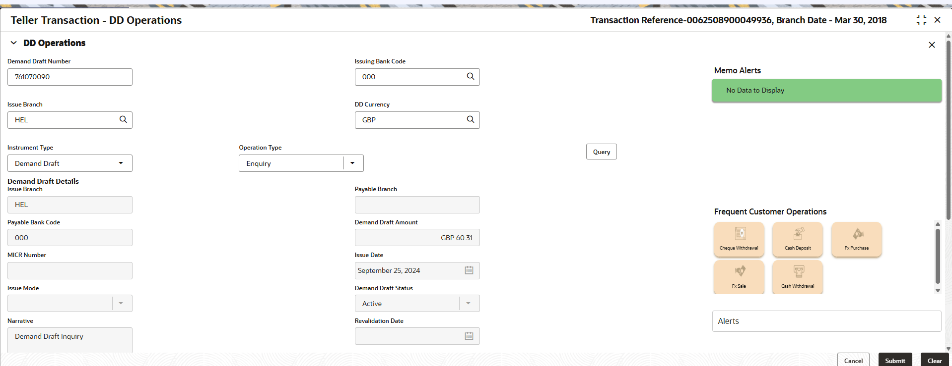

The Teller can use the DD Operations screen to inquire about the details of DD.
To inquire the details of DD:
  1. On the Home page, from Teller mega menu, under Remittances, click DD Operations or specify DD Operations in the search bar and select the screen.
    The DD Operations screen is displayed.
    Figure 5-31 DD Operations - Inquiry
  2. On the DD Operations screen, specify the fields. For more information on fields, refer to the field description table.
    The fields marked as Required are mandatory.

    Demand Draft Details
    Displays the details of DD under this segment.
