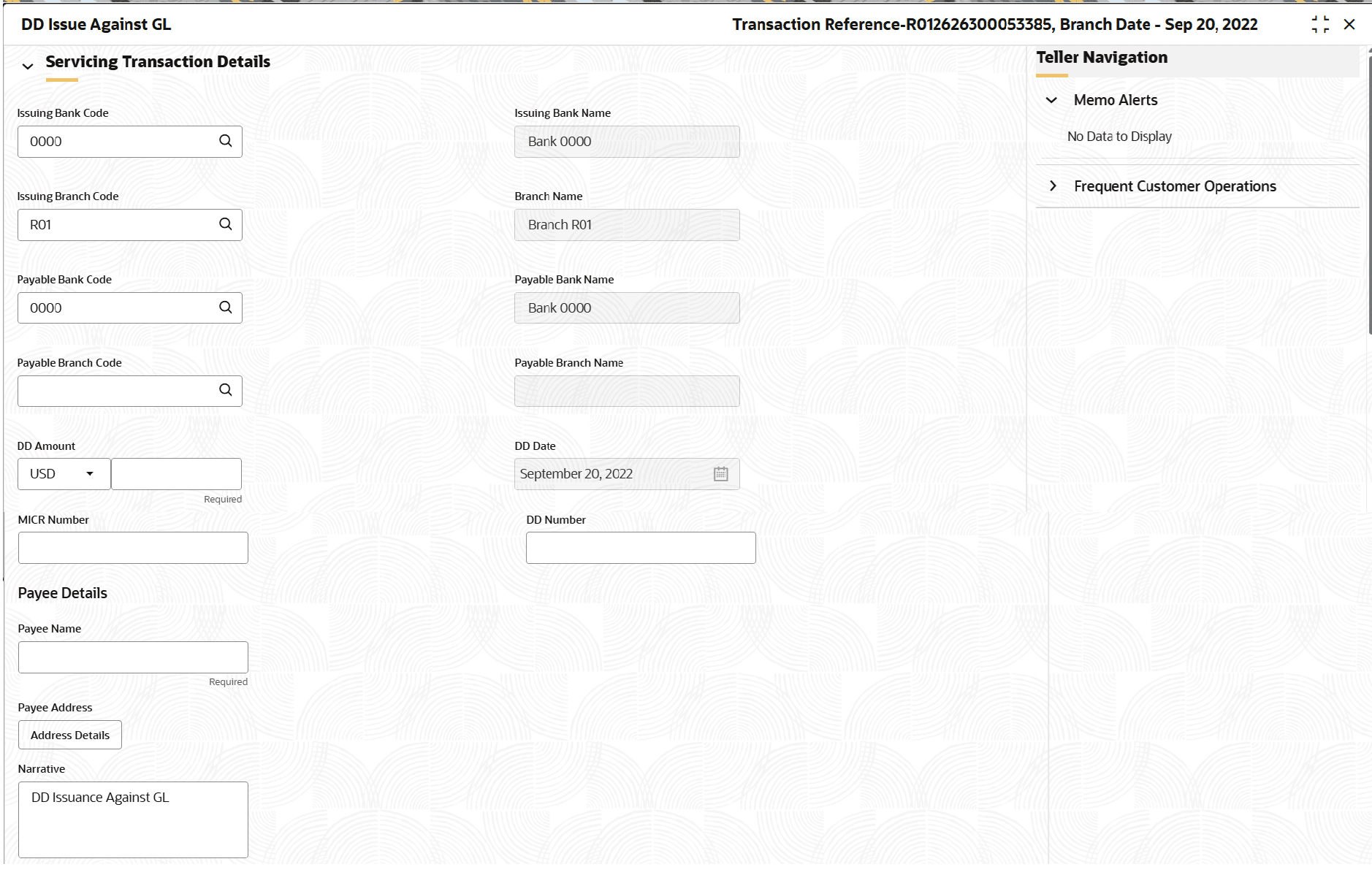

  1. On the Home page, from Teller mega menu, under Remittances, click DD Issue - GL or specify DD Issue - GL in the search bar and select the screen.
    The DD Issue Against GL screen is displayed.
    Figure 5-27 DD Issue Against GL
  2. On the DD Issue Against GL screen, specify the fields. For more information on fields, refer to the field description table.
    The fields marked as Required are mandatory.
    Table 5-27 DD Issue Against GL - Field Description
    Field Description
    Issuing Bank Code
    Specify the code of the issuing bank.
    Issuing Bank Name
    Specify the name of the issuing bank.
    Issuing Branch Code
    Displays the logged-in branch code.
    Branch Name
    Displays the branch description of issuing branch.
    Payable Bank Code
    Select the payable bank code. The list of values contains the bank codes maintained using the External Bank Code Maintenance screen.
    • To remit funds within the same bank, select the logged-in bank code as payable bank code. To remit funds across banks, select the necessary bank code as payable bank code. The fields Payable Branch Code and Payable Branch Name will be enabled after you specify the Payable Bank Code.
    • If the Instrument Currency is FCY and the Payable Bank code selected is External Bank, then the Instrument Type will be Demand Draft-FCY (DF).
    Payable Bank Name
    Displays the name of the selected bank code.
    Payable Branch Code
    Select the branch code of the payable bank. The list of values contains the corresponding branch codes maintained using the Bank Code Maintenance screen.
    Payable Branch Name
    Displays the branch name of the selected branch code.
    DD Amount
    Specify the DD currency and DD amount.
    DD Date
    Specify the date that needs to be mentioned in the DD.
    MICR No
    Displays the serial number.
    DD Number
    Specify the instrument number and validate.
    Note: If not specified, the system generates the DD number based on the maintenance setup.
    Payee Details
    Specify the fields.
    Payee Name
    Specify the payee name on which the DD is drawn.
    Payee Address
    Click Address Details button to view the customer address details.
    For the field-level description of the customer address, see Address Details.
    Narrative
    Displays the narrative as DD Issuance Against GL, and it can be modified.

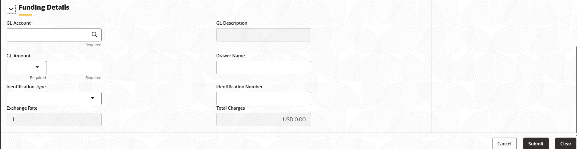

  3. Click on the Funding Details data segment.
    The Funding Details data segment is displayed.
  4. On the Funding Details data segment, specify the fields. For more information on fields, refer to the field description table.
    Table 5-28 Funding Details - Field Description
    Field Description
    GL Account Select the account number of the GL against which the BC is issued from the LOV.
    GL Description Displays a brief description of the general ledger.
    GL Amount Specify the GL amount.
    Drawer Name Specify the name of the drawer.
    Identification Type Select the identification type of the drawer from the drop-down list.
    Identification Number Specify the identification number of the drawer.
    Exchange Rate Displays the exchange rate.
    Total Charges Displays the total charges.
  5. Specify the charge details. For information on the fields in the Charge Details segment, refer to Charge Details.

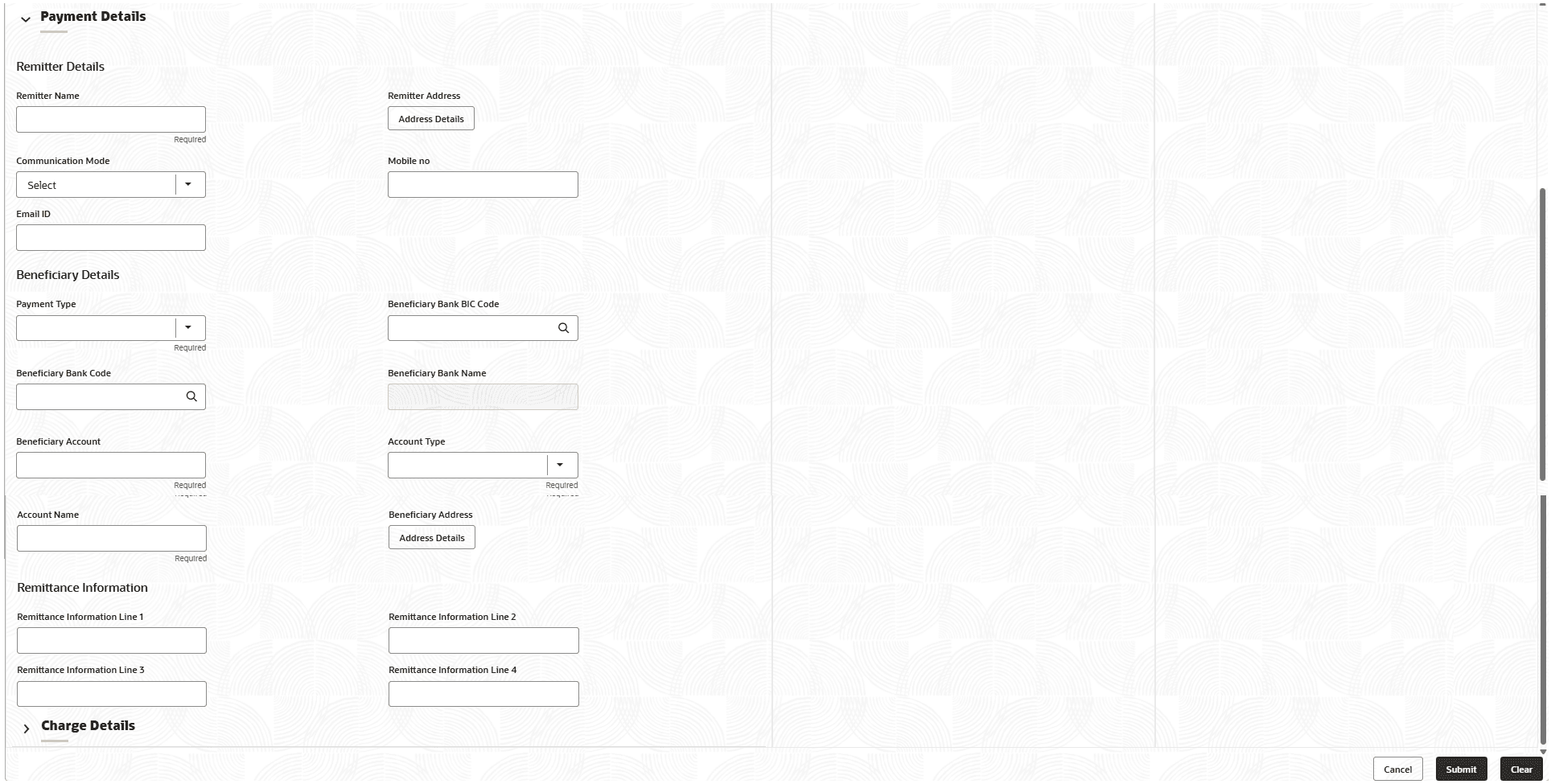

  7. To add the payment details:
    On the Payment Details data segment, specify the fields. For more information on fields, refer to the field description table.
    Table 5-29 Payment Details - Field Description
    Field Description
    Remitter Details
    Specify the fields.
    Remitter Name
    Displays the remitter description based on the remitter account number specified.
    Remitter Address
    Click Address Details button to view customer address.
    Communication Mode
    Specify the mode of communication for the transaction. The drop-down values are E-Mail and Phone.
    Mobile No
    Specify the mobile number if the mode of communication is selected as Phone.
    Email ID
    Specify the email address if the mode of communication is selected as E-Mail.
    Beneficiary Details
    Specify the fields.
    Payment Type
    Select the payment type from the drop-down values.
    Beneficiary Bank Code
    Select the beneficiary bank code from the list of values.
    The LOV display all valid clearing bank codes maintained in the system.
    Beneficiary Bank Name
    Specify the name of the beneficiary bank. If the beneficiary bank code is selected, the system displays the description.
    Beneficiary Account
    Specify the account number of the beneficiary.
    Account Type
    Select the account type of the beneficiary from the drop-down list.
    Account Name
    Specify the account name of the beneficiary.
    Beneficiary Address
    Remittance Information
    Specify the fields.
    Remittance Information Line 1 to Remittance Information Line 4
    Specify the remittance information in free text format.
