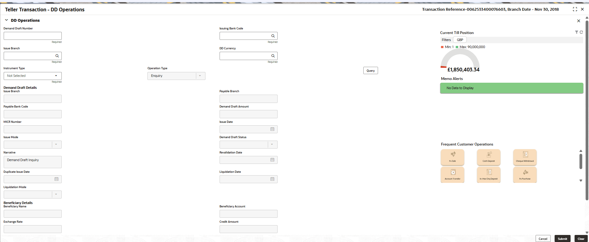

    Figure 5-36 DD Operations - Payment by GL
  2. On the DD Operations screen, specify the fields. For more information on fields, refer to the field description table.
    The fields marked as Required are mandatory.

    Field Description
    Demand Draft Number
    Specify the DD number of the instrument.
    Issuing Bank Code
    Specify the code of the issuing bank.
    Issue Branch
    Select the branch code where the instrument is issued from the LOV.
    DD Currency
    Specify DD Currency to query instrument details.
    Operation Type
    Select the type Payment from the drop-down list.
    Operation Mode
    Select the operation mode as GL from the drop-down values.
    Payment Details
    Specify the details under this segment.
    GL Account
    Specify the GL account number.
    GL Currency
    Displays the currency of the specified GL account.
    GL Branch
    Displays the branch code of the specified GL account.
    Exchange Rate
    Displays the exchange rate, and it can be modified.
    Note: If the transaction currency is the same as the account currency, the system will display the exchange rate as 1. This field is displayed only if Multi-Currency Configuration at the Function Code Indicator level is set as Y.
    Account Amount
    Displays the account amount.
    Note: This field is displayed only if Multi-Currency Configuration at the Function Code Indicator level is set as Y.
    Total Charge Amount
    Displays the total charge amount.
    Note: This field is displayed only if Total Charges Configuration at Function Code Indicator level is set as Y.
    Narrative
    Displays the default narrative as DD Operations, and it can be modified.
