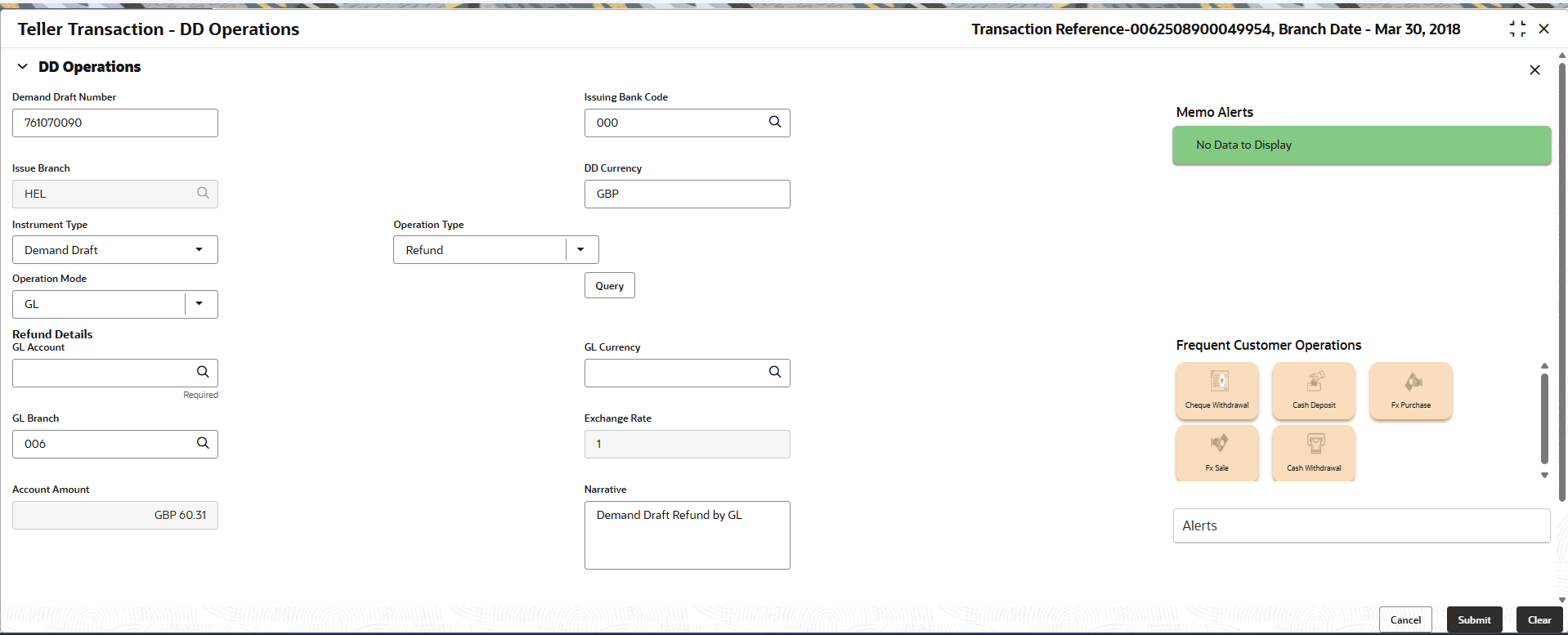

The Teller can use the DD Operations screen to refund the amount against a DD.
The DD payment is credited to the GL account when the operation mode is GL.
To refund the amount:
  1. On the Home page, from Teller mega menu, under Remittances, click DD Operations or specify DD Operations in the search bar and select the screen.
    The DD Operations screen is displayed.
    Figure 5-39 DD Operations - Refund by GL
  2. On the DD Operations screen, specify the fields. For more information on fields, refer to the field description table.
    The fields marked as Required are mandatory.
    Table 5-39 DD Operations (Refund by GL) - Field Description
    Field Description
    Demand Draft Number
    Specify the DD number of the instrument.
    Issuing Bank Code
    Specify the code of the issuing bank.
    Issue Branch
    Select the branch code where the instrument is issued from the LOV.
    DD Currency
    Specify DD Currency to query instrument details.
    Instrument Type Select the instrument type from the drop-down list.
    The option are:
    • Demand Draft
    • Demand Draft-FCY
    Operation Type
    Select the type Refund from the drop-down list.
    Operation Mode
    Select the operation mode as GL from the drop-down values.
    Refund Details
    Specify the details under this segment.
    GL Account
    Specify the GL account number.
    GL Currency
    Specify the currency of the specified GL account.
    GL Branch
    Select the branch code from the list of values.
    Exchange Rate
    Displays the exchange rate, and it can be modified.
    Note: If the transaction currency is the same as the account currency, the system will display the exchange rate as 1. This field is displayed only if Multi-Currency Configuration at the Function Code Indicator level is set as Y.
    Account Amount
    Displays the account amount.
    Note: This field is displayed only if Multi-Currency Configuration at the Function Code Indicator level is set as Y.
    Total Charge Amount
    Displays the total charge amount.
    Note: This field is displayed only if Total Charges Configuration at the Function Code Indicator level is set as Y.
    Narrative
    Displays the default narrative as Demand Draft Refund by GL, and it can be modified.
