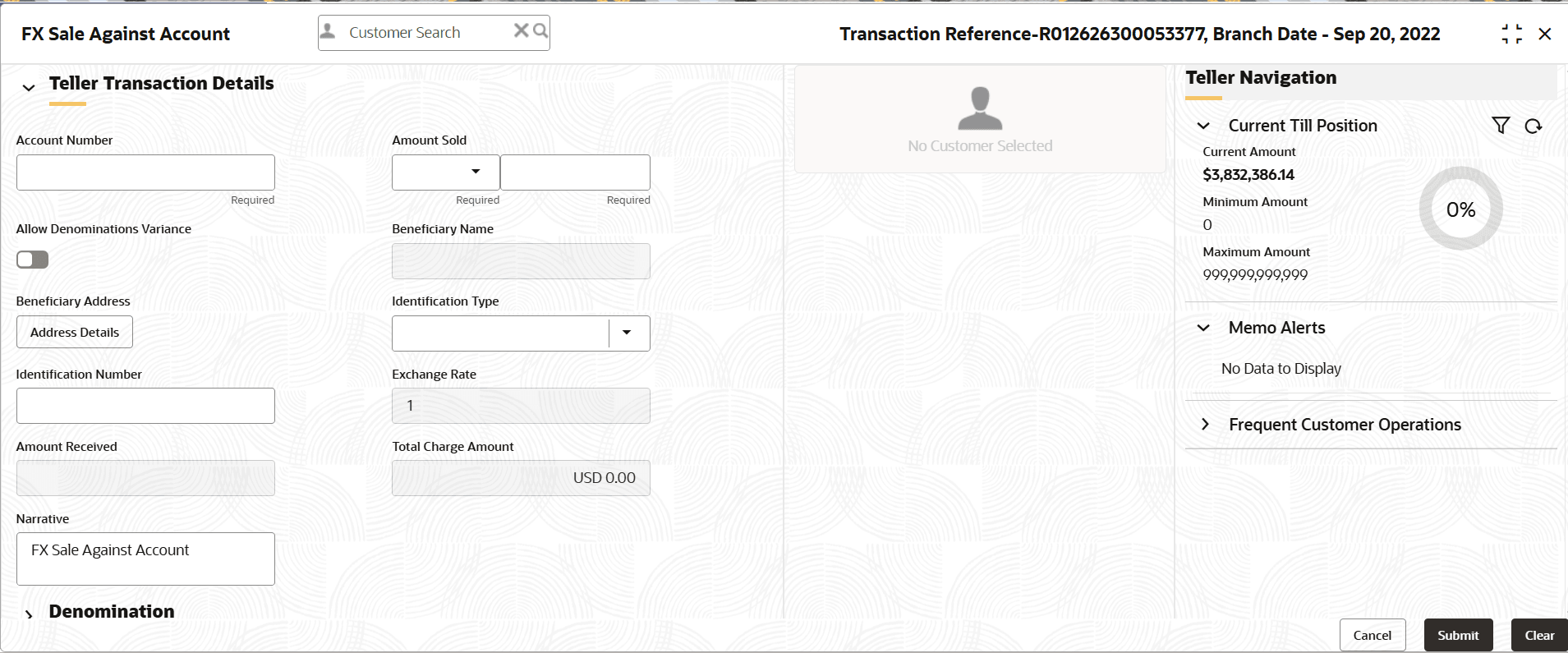

The Foreign Exchange (FX) Sale Against Account screen is used to sell the foreign currency from the branch through the CASA account.
This transaction is performed by debiting the corresponding account currency from the CASA account.
To sell the foreign currency against CASA account:
- On the Home screen, from Teller mega menu, under Customer Transaction → Forex Transactions, click FX Sale - Account or specify FX Sale - Account in the search bar and select the screen.The FX Sale Against Account screen is displayed.
- On the FX Sale Against Account screen, specify the fields.

Table 7-5 FX Sale Against Account - Field Description
Field Description Account Number
Specify the CASA account to be debited for the foreign currency sale from the adjacent option list.
The system displays an override or error message on the tab out of Account Number based on the account dormancy parameters.Amount Sold
Specify the currency and amount sold against the CASA account. You can select the appropriate code from the adjoining option list that displays all the currency codes maintained in the system. The system also displays the amount that is being sold.
Allow Denom Variance
Select if the denomination-wise variance needs to be applied for the transaction.Note:
If the parameter at the function code indicator is set as Y, this option will be selected by default and it can be modified. If the parameter at the function code indicator is set as N, then this option will be disabled.Beneficiary Name
Displays the name of the beneficiary customer based on the account number selected.
Beneficiary Address
Click Address Details button to view the customer address details.Note:
For the field-level description of the customer address, see Address Details.Identification Type
Select the type of identification provided by the customer from the drop-down list.
Identification Number
Specify the identification number provided by the customer.
Exchange Rate
Displays the exchange rate used to convert the transaction (sale) currency into account currency and it can be modified.Note:
This field is displayed only ifMulti-Currency Configurationat Function Code Indicator level is set as Y.Negotiated Exchange Rate
Specify the negotiated exchange rate that should be used for foreign currency transactions between the treasury and the branch.Note:
This field is applicable only if the transaction involves cross currency and only if cross currency enabled andNegotiated_Rate_Enabled Configurationat Function Code Indicator level is set as Y.Negotiated Reference Number
Specify the unique reference number that should be used for negotiation of cost rate, in foreign currency transaction. If you have specified the negotiated cost rate, then you need to specify the negotiated reference number also.Note:
Accounting system books the online revaluation entries based on the difference in exchange rate between the negotiated exchange rate and transaction rate.Amount Received
Displays the amount received and currency from the CASA account.Note:
The currency of the amount received defaults from the CASA account currency. The amount received will be calculated based on the Amount Sold and the Exchange Rate. This field is displayed only ifMulti-Currency Configurationat Function Code Indicator level is set as Y.Total Charges
Displays the total charge amount which is computed by the system in the local currency of the branch.Note:
This field is displayed only ifTotal Charges Configurationat Function Code Indicator level is set as Y.Narrative
Displays the default narrative as FX Sale Against Account, and it can be modified.
- Specify the FX Out Denomination details. For information on the fields in the Denomination Details segment, refer to Add Denomination Details.
- Click Submit.A teller sequence number is generated, and the Transaction Completed Successfully information message is displayed.
The transaction is moved to authorization in case of any approval warning raised when the transaction saves. On transaction completion, the foreign currency cash is withdrawn and the equivalent account amount is debited. For more information on transaction submission and validations, refer to Step 5 in Cash Deposit.
