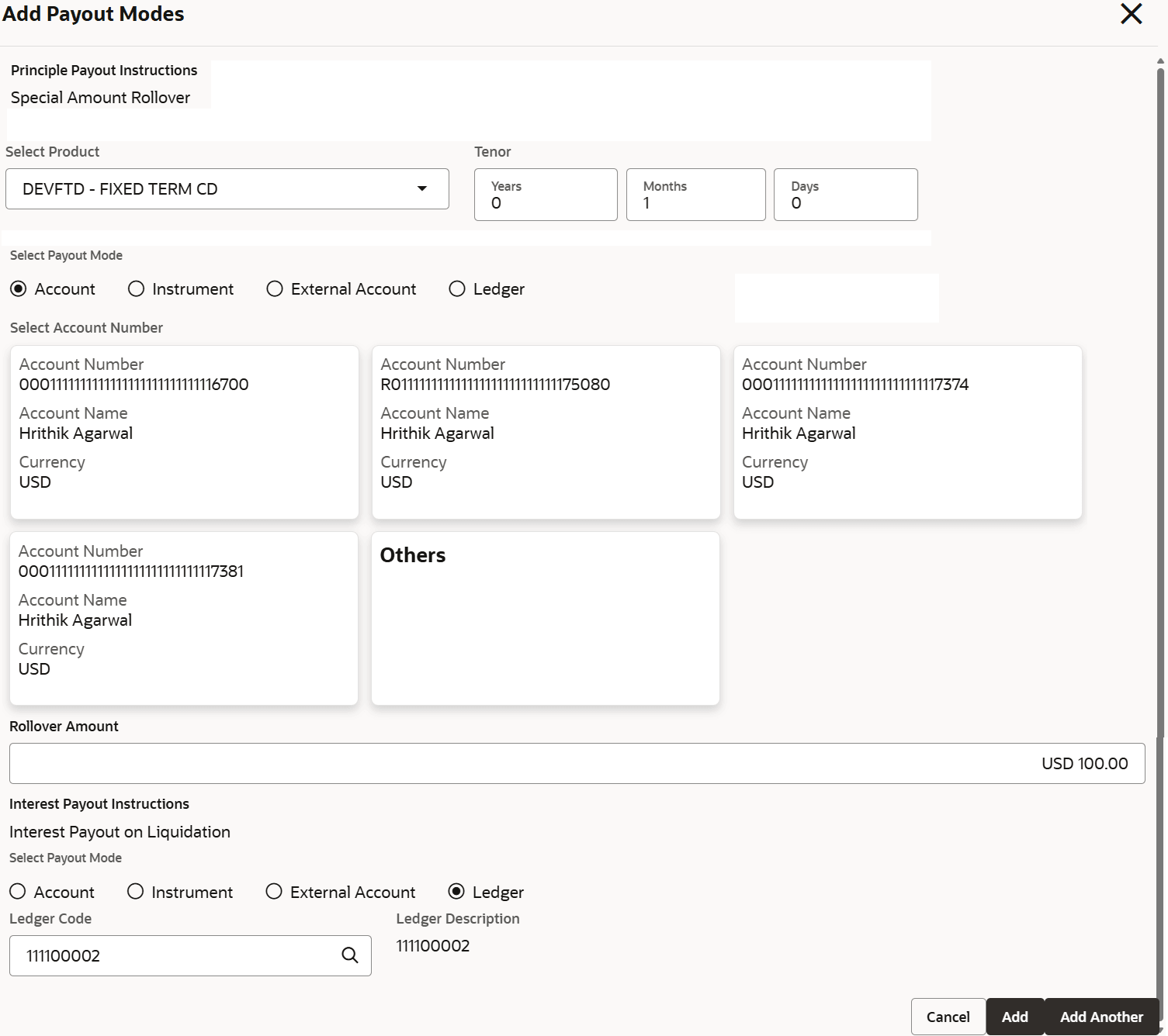

  3. In the Settlement details section, click Add Payout.
    The Add Payout Modes section is displayed.
    Figure 3-45 Add Payout Modes - Special Amount Rollover
  4. In the Add Payout Modes section, specify the fields. For more information on fields, refer to the field description table.
    Table 3-39 Add Payout Modes - Special Amount Rollover – Field Description
    Field Description
    Principal Payout Instructions Displays the principal payout instruction set for the account.
    Select Product Select the product to define the rollover product at the account level.
    During rollover, the product defined at the account level will take precedence. The product drop-down fetches all active deposit business products with their product code, product name, and APY details.
    Tenor Specify the tenor for payout in Years, Months, or Days.
    Select Payout Mode
    Select the payout mode for the settlement. The options are:
    • Account
    • Instrument
    • External Account
    • Ledger
    For more information, refer Payout Modification - Payout Modes.
    Rollover Amount Specify the rollover amount.
    Interest Payout Instructions Displays the instruction set for the interest payout.
    Select Payout Mode
    • Account
    • Instrument
    • External Account
    • Ledger
  5. Click Submit.
