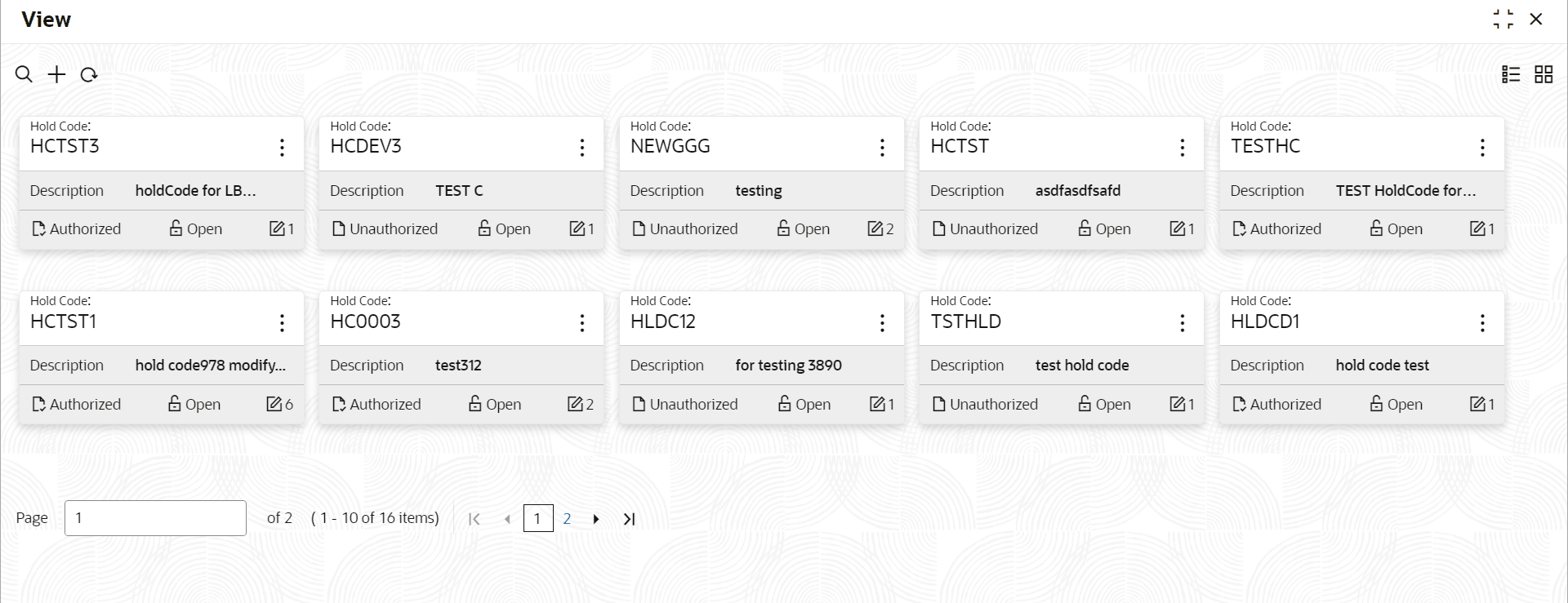

  1. Click Account Configurations, and under Account Configurations, click Hold Code.
  2. Under Hold Code, click View.
    The View page displays.
    Tip:
    Click Title view or List view to switch between the Tile view and the List view.
    Table 4-2 Hold Code Tile - Field Description
    Field Description

  3. View the details of a Hold Code.
    1. Click More Options menu icon and select View.
      The Hold Code Maintenance page displays.
    2. Click Audit.
      A dialog displays the Maker, Checker, Status, and Modification Number of the record.
