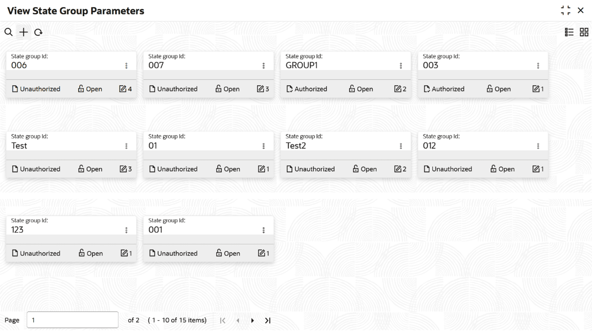

  1. Click Account Configurations, and under Account Configurations, click State Group Parameters, then click View State Group Parameters.
    The View State Group Parameters page displays.
    Figure 8-2 View State Group Parameters
    Tip:
    Click Title view or List view to switch between the Tile view and the List view.
