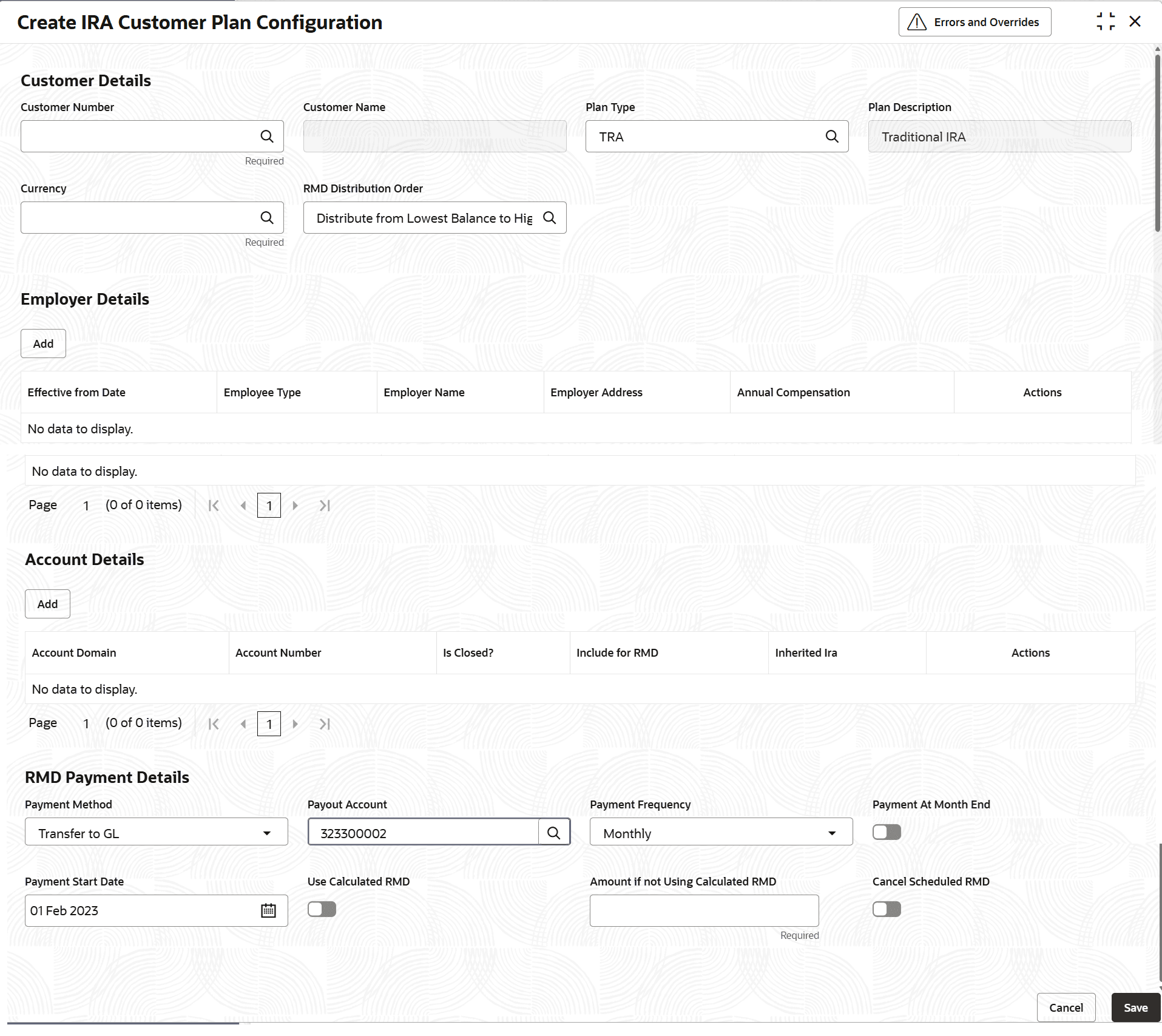

  1. On Home screen, under Menu, click Retail Account Configurations. Under Retail Account Configurations, click IRA Customer Plans Configuration.
  2. Under IRA Customer Plans Configuration, click Create IRA Customer Plans.
    The Create IRA Customer Plans Configuration screen is displayed.
    Figure 1-61 Create IRA Customer Plans Configuration
  3. Specify the fields on Create IRA Customer Plans Configuration screen.
    For more information on fields, refer to the field description table below.

  4. After specifying all the details, click Save to complete the steps. Or, click Cancel to exit without saving.
