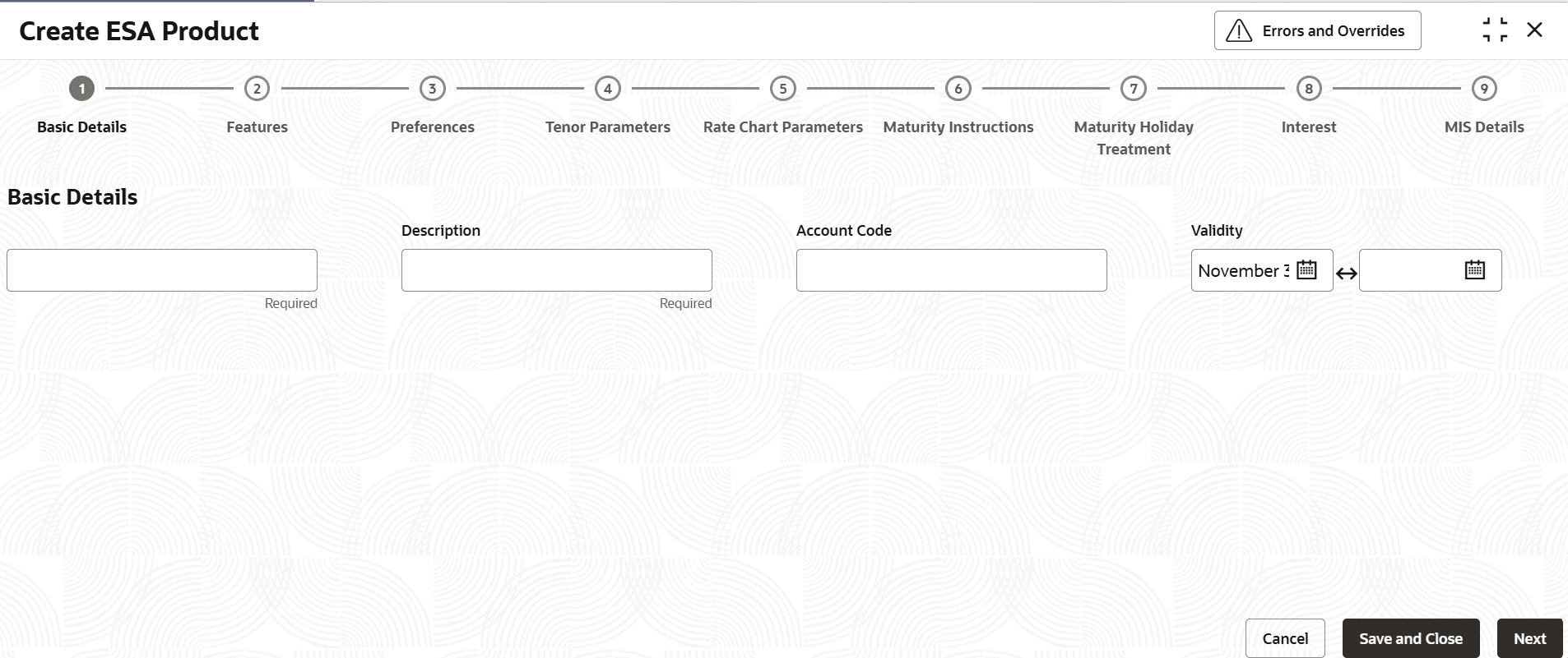

    Figure 1-53 Create ESA Product - Basic Details
  3. Specify the fields on the Basic Details screen.
    For more information on fields, refer to the field description table below.
    Table 1-56 Basic Details - Field Description
    Field Description
    ESA Product Code Specify the ESA product code to be maintained. This indicates the class code or template code. This code is referenced during the deposit creation.
    Description Specify the description for the ESA product.
    Account Code As per your bank’s requirement, user can choose to classify ESA products into different account codes. The bank can decide the way the ESA products are to be assigned to different account codes.
    An account code can consist of a maximum of four characters.
    An account code can be part of the customer account mask.
    If the customer account mask consists of an account code, the value in this field is used as part of deposit account number generation.
    Validity Specify the validity period of the ESA product by specifying the start date and the end date.
    End date is optional.

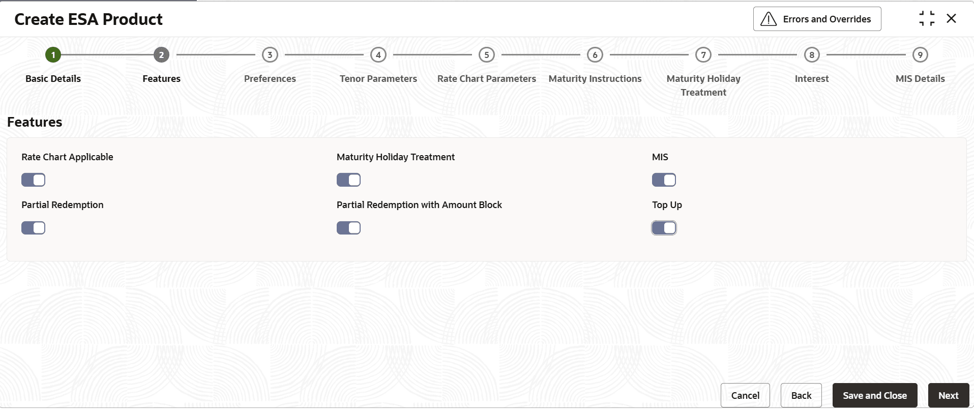

    Figure 1-54 Create ESA Product - Features
  5. Specify the fields on Features screen.
    Table 1-57 Features - Field Description
    Field Description
    Rate Chart Applicable Switch this toggle ON, if balance and tenor based rates are applicable. Only if this button is on the related data segment will be displayed for capture.
    If this option is enabled, the Rate Chart Parameters data segment will be displayed in the screen.
    Maturity Holiday Treatment Switch this toggle ON, if maturity holiday treatment is applicable. It determines the treatment applicable for deposit account, if the maturity date falls on a holiday.
    If this option is enabled, the Maturity Holiday Treatment data segment will be displayed in the screen.
    MIS Switch this toggle ON, to capture the MIS details for the product.
    If this option is enabled, the MIS data segment will be displayed in the screen.
    Partial Redemption Switch this toggle ON, to indicate that partial redemption is allowed. If this option is not enabled, then partial redemption will not be allowed on deposits under this ESA product.
    The default value is OFF.
    Partial Redemption with Amount Block Switch this toggle ON, to indicate that partial redemption is allowed for the deposits with amount blocks. If the deposit is linked partially then partial redemption of the deposit will be allowed only if user enable this option.
    Top Up Switch this toggle ON, to indicate that Top-up (adding of additional funds to the ESA CD during the life cycle) is allowed for the deposits.
  6. After specifying the fields in the Basic Details screen, click Next.

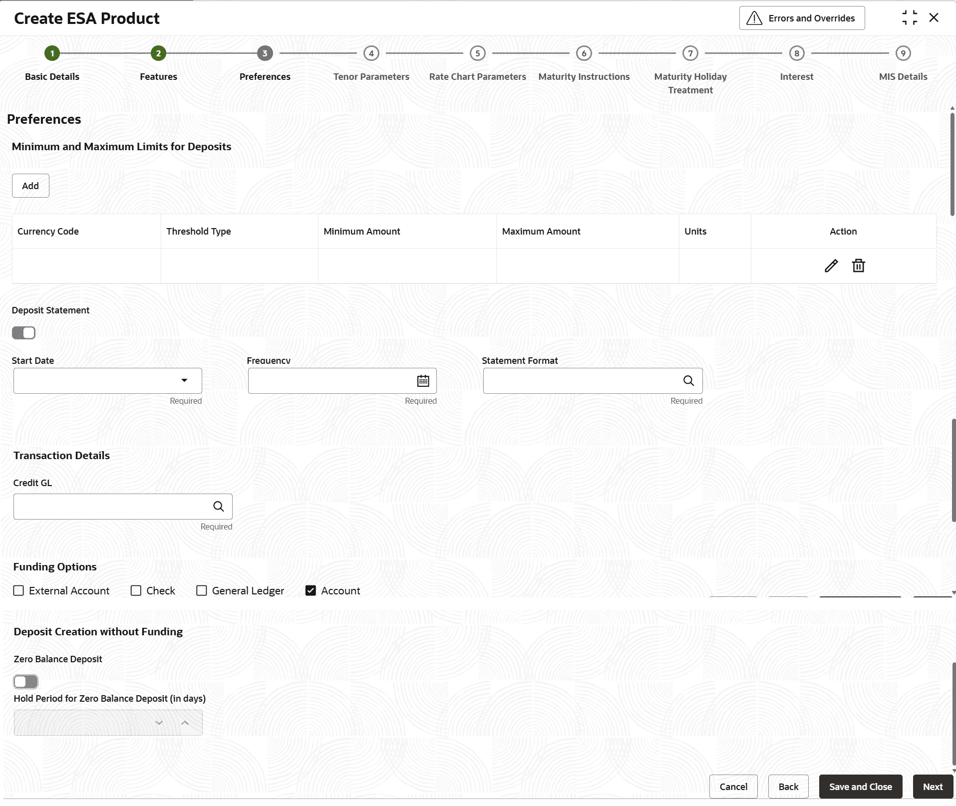

    Figure 1-55 Create ESA Product - Preferences
  7. Specify the fields on Preferences in Deposits screen.
    Click Add button in the Preferences screen to specify the currency code, minimum opening deposit amount, maximum opening deposit amount, and top up units.
    Table 1-58 Preferences - Field Description
    Field Description
    Minimum and Maximum Limits for Deposits The min and max limits feature in Certificate of Deposit business product allows for the bank to include the limits for deposit opening, top-up and deposit lifecycle balance threshold for deposit processing
    Currency Code Specify the currency code or click Search icon to select the applicable currency from the list for which the minimum and maximum opening deposit amount is to be maintained.
    Threshold Type This field is a drop-down list. This field denotes the event type for which the minimum and maximum limits are being defined. This field will support the below 3 types as static values:
    • Certificate of Deposit Creation: This type to be selected for defining the minimum and maximum limits of the deposit amount that is required for opening a deposit. If there are no values provided for this field, then it is understood that there is no minimum or maximum deposit opening amount limits.
    • Top-up: This type to be selected for defining the minimum and maximum limits of the amount when processing a top-up transaction for the deposit. If there are no values provided for this field, then it is understood that there is no minimum or maximum amount limits for top-up.  Top-up units: This field is applicable only when the “Threshold Type” is Top-up. This is an existing field and this denotes the incremental unit in which the top-up can be done. Eg: If this value is 50, then the top-up can be done for $50, $100, $150, $200 and so on.
    • Balance Threshold: This type to be selected for defining the minimum and maximum deposit balance over the lifecycle of the deposit (that is, the balance in the deposit account at any point in the deposit lifecycle cannot breach these limits). Eg: Any lifecycle operation such as a deposit opening, top-up, redemption cannot breach these limits. If there are no values provided for this field, then it is understood that there is no minimum or maximum amount limits to be validated over the lifecycle of the deposit.
    • The values for minimum and maximum amounts provided for the threshold type Certificate of Deposit cannot breach the limits if provided for the Balance Threshold.
    • Similarly, the values for minimum and maximum amounts provided for the threshold type Top-up cannot breach the limits if provided for the Balance Threshold.
    Minimum Amount Specify the minimum opening deposit amount for the deposit product.
    If the deposit funding amount is less than minimum opening deposit amount, then the system will reject the deposit creation.
    Maximum Amount Specify the maximum opening deposit amount for the deposit product.
    If the deposit funding amount is greater than the maximum opening deposit amount, then system will reject the deposit creation.
    Units Specify the top-up units for the deposit product. The top-ups done on the deposit product should be basis the units if configured. Eg: If top-up unit is USD 500, then top-up can be done for UDS 500, USD 1000, USD 1500 etc.
    Action Click the Edit icon to edit the values specified, or click Delete icon to delete the added row.
    Deposit Statement Switch this toggle ON, to specify the cycle, and statement format to get the deposit statement for the transactions.
    Credit GL Specify the GL to which an account balance should belong. Click Search icon and select the credit GL from the list of values.
    Funding Options Specify the option(s) through which the Certificate of deposit can be funded. When the deposit is opened, a validation ensures that the deposit is funded only through the selected option(s). The available options are External Account, Check, General Ledger, and Account.
    Deposit Creation without Funding System will support the capability to allow opening a zero balance deposit by the bank, which can be funded later. It is to be noted that this funding should happen within the configured number of days at the deposit business product, if not, then the zero balance deposit will be closed automatically.
    Zero Balance Deposit Switch this toggle ON to enable the system allows for a zero balance deposit account to be created under the business product. In such cases the deposit account origination system will not be passing the payin details during Certificate of deposit opening as this deposit will be funded later. The default value is OFF.
    Hold Period for Zero Balance Deposit (in days) Select the days to configure the Zero Balance Deposit.
    Once a zero balance deposit is created, it is expected that the Certificate of deposit will be funded within the days configured as part of this field. Eg: if the value configured as part of this field is ‘7 days’ then: - If the customer funds (this funding will be considered as an initial funding) within 7 days of opening the deposit then the deposit account will continue to be active. The interest accruals under this CD will be considered from the date of funding the deposit account. -If the customer fails to fund the deposit within the configured 7 days, then the system will process the closure of this deposit with zero balance as part of the EOD batch process.
    Note: This field is applicable only if the flag Zero Balance Deposit is set to On.

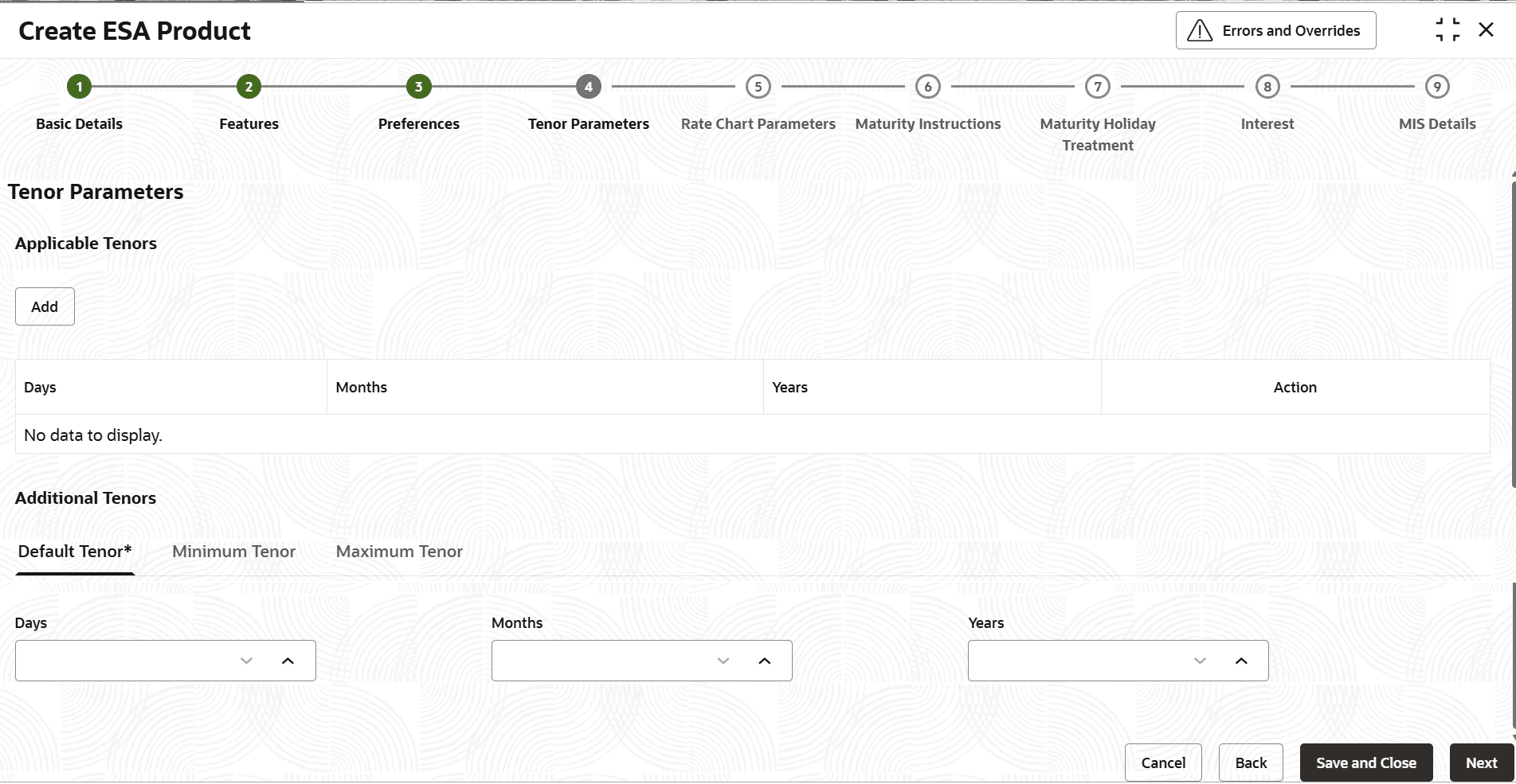

    Figure 1-56 Create ESA Product - Tenor Parameters
  9. Specify the fields on Tenor Parameters screen.
    Click Add button in the Tenor Parameters data segment to add the applicable tenors.
    Table 1-59 Tenor Parameters - Field Description
    Field Description
    Tenor Parameters This section determines the list of applicable tenors for a ESA product and also the minimum, maximum and default tenor for a ESA product.
    Applicable Tenors Click on Add to specify multiple tenors that are applicable for the ESA product.
    If Applicable Tenors are defined for a ESA product then the deposit can be created only with one of the tenors mentioned in the configured list. The deposit creation will fail in case the deposit is booked with any other tenor not part of the maintained list.
    Days Specify the tenor value in Days.
    Months Specify the tenor value in Months.
    Years Specify the tenor value in Years.
    Minimum Tenor Specify the minimum tenor for which deposits should be created under this ESA product. If the deposit is booked for a tenor that is less than the minimum tenor then the deposit creation fails with an appropriate error message.
    If applicable tenor is configured, then it needs to be made sure that the minimum tenor is less than the least value of the configured applicable tenors.
    Days Specify the minimum tenor in terms of days.
    Months Specify the minimum tenor in terms of months.
    Years Specify the minimum tenor in terms of years.
    Default Tenor User can define a tenor for the deposits that are opened under the ESA product. Deposits opened under the ESA product will automatically acquire this tenor. However, user can change the tenor to suit the requirements of a specific deposit. The default tenor should be within the minimum and maximum range specified.
    The default tenor is mandatory for a ESA product.
    If applicable tenors are also configured, then one of the applicable tenors needs to be captured as a default tenor.
    Days Specify the default tenor in terms of days.
    Months Specify the default tenor in terms of months.
    Years Specify the default tenor in terms of years.
    Maximum Tenor Specify the maximum tenor for which deposits can be created under this ESA product. If the deposit is booked beyond the maximum tenor then the deposit creation fails with an appropriate error message.
    If applicable tenor is configured, then it needs to be made sure that the maximum tenor is more than the max value of the configured applicable tenors.
    Days Specify the maximum tenor in terms of days.
    Months Specify the maximum tenor in terms of months.
    Years Specify the maximum tenor in terms of years.

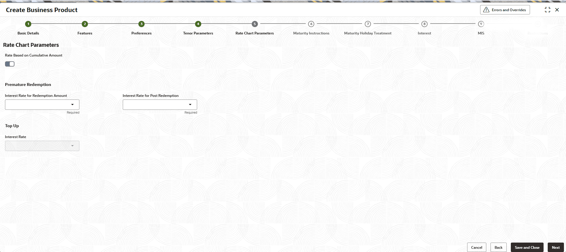

    Figure 1-57 Create ESA Product - Rate Chart Parameters
  11. Specify the fields on Rate Chart Parameters screen.
    Table 1-60 Rate Chart Parameters - Field Description
    Field Description
    Rate Chart Parameters This determines if rate chart is applicable for the ESA product and the premature redemption details for the deposits if rate chart is allowed.
    Rate Based On Cumulative Amount Switch this toggle ON to indicate that the system should arrive at the interest rate of a new deposit using the cumulative amount of other active deposits, under the same ESA product, customer, and currency.
    Interest Rate for Redemption Amount Select the interest rate to be applied for the redemption amount, from the drop-down list. The list of values are as follow:
    • Continue Existing
    • As on Opening Date
    • As on Redemption Date
    The default value is Continue Existing.
    Interest Rate for Post Redemption Select the interest rate to be applied after redemption of deposit, from the drop-down list. The list of values are as follows:
    • Continue Existing
    Interest Rate Select the interest to be applied on the top-up deposit, from the drop-down list. The list of values as follow:
    • Current - Select this option to apply the current interest rate of the deposit on the top-up amount.
    • As on Opening Date - Select this option to apply the interest rate based on the slab as on the value date of deposit opening. If top-up is made to a deposit after rollover, the rate as on rollover date will be considered for rate pick up.
    • As on Top Up Value Date - Select this option to apply the interest rate based on the slab as on the value date of the top-up.

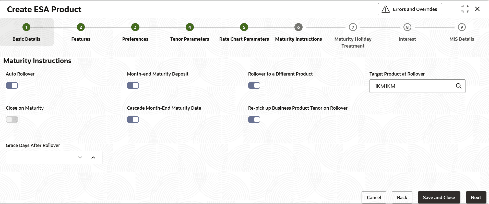

    Figure 1-58 Create ESA Product - Maturity Instructions
  13. Specify the fields on Maturity Instructions screen.
    Table 1-61 Maturity Instructions - Field Description
    Field Description
    Maturity Instructions This determines the default maturity instructions for accounts opened under the ESA product.
    Auto Rollover Switch this toggle ON to automatically rollover the deposits on maturity date.
    Month-End Maturity Deposit Switch this toggle ON to indicate that the deposit is a month-end maturing deposit (i.e., the deposit matures on the last working day of the month).
    Rollover to a Different Product Switch this toggle button ON for selection only if the Maturity Instructions selected for the product is Auto Rollover. If this flag is OFF when Auto-Rollover is ON, then the deposits opened under this business product can rollover to the same product only. This flag status also determines if the override of Target Product at Rollover will be allowed to be overridden at account level
    The default value for this field is OFF
    Target Product at Rollover Switch this toggle ON for selection only if the field Rollover to a Different Product is selected as ON. This LOV lists the configured deposit product codes along with product descriptions, in the system. The user can choose the target product code from the list to which the deposit account needs to rollover to on maturity (if the maturity instruction is rollover).
    The Target product must be of the same type. Eg: ESA CD to show only ESA CD products as part of the List of Values (LOV)
    This is an optional field.
    Re-pick up Business Product Tenor on Rollover Switch this toggle ON to enable re-pick up of the ESA product tenor on rollover. During rollover, the system will pick up the default tenor of the ESA product.
    Close on Maturity Switch this toggle ON to close the deposit account on maturity date and transfer the amount as per the pay-out details maintained for the deposit.
    Cascade Month-End Maturity Date Switch this toggle ON to cascade the month end maturity date of the deposit. If not selected then, the maturity date will fall in line with the account open date.
    Maturity Notice Period Specify the number of days before which the customer notification is to be sent for deposit maturity.
    Grace Days After Rollover Specify the number of days after rollover during which the customer can request modifications or operations such as redemption without incurring any penalty.

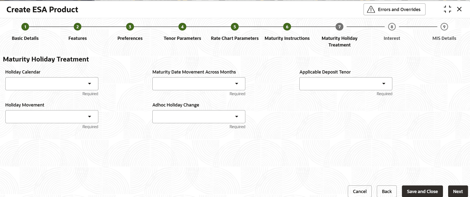

    Figure 1-59 Create ESA Product - Maturity Holiday Treatment
  15. Specify the fields on Maturity Holiday Treatment screen.
    Table 1-62 Maturity Holiday Treatment - Field Description
    Field Description
    Maturity Holiday Treatment This determines the holiday treatment if the maturity of the deposit falls on a holiday.
    Holiday Calendar Select the holiday calendar applicable to the ESA product from the drop-down list. This list displays the following values:
    • Ignore - Select this option to ignore all other holiday parameters for the ESA product. By default, this option is selected.
    • Branch - Holiday calendar will be based on the branch holiday maintenance of the respective branch.
    • Currency - Holiday calendar will be based on the currency maintenance done at bank level for the respective currency.
    • Both Branch and Currency - Holiday calendar is based on both branch and currency holiday maintenance.
    The holiday calendar is used to arrive at the maturity date. The holiday calendar defined at the ESA product is applicable to all deposits opened under the ESA product. User cannot modify the Holiday Calendar if there are active accounts under the ESA product.
    The default value is Ignore.
    Holiday Movement Select the working day to which the holiday should be moved from the adjoining drop-down list. This list displays the following values:
    • No Change - If you select this option, then there is no change in the maturity date. By default, this option is selected.
    • Previous Working Day - In case the computed maturity date is a holiday, then system moves the maturity date to the previous working day for the corresponding Holiday Calendar chosen.
    • Next Working Day - In case the computed maturity date is a holiday, then system moves the maturity date to the next working day for the corresponding Holiday Calendar chosen.
    Holiday movement is adjusting the next maturity date when the maturity date falls on a holiday, based on the Holiday Calendar chosen. Holiday Movement is not applicable if you select Ignore option for Holiday Calendar.
    User cannot modify the Holiday Movement if there are active account under the IRA product.
    The default value is No Change.
    Maturity Date Movement Across Months Select the maturity date movement across months from the drop-down list:
    • Allowed - The maturity date is moved across months. If the computed maturity date falls on a Holiday, then the maturity date can be moved to the next or previous working day, based on the holiday movement option, even if it falls in a different month. By default, this option is selected.
    • Previous/Next Working Day of the Same Month - After moving the maturity date, if the adjusted maturity date falls in the previous/next month, then the system moves the maturity date forward or backward to the next/previous working day of the same month.
    • No Change in Maturity Date - If the adjusted maturity date falls on next/previous month, then the system ignores the movement and considers the computed maturity date as the maturity date even it falls on a holiday.
    Maturity date across months is applicable only when the maturity date is adjusted to previous or next working day.
    The default value is Allowed.
    Adhoc Holiday Change Select the adhoc holiday change from the drop-down list. The list displays the following values:
    • Change Maturity Date and Generate Advice - System updates the maturity date and the rollover maturity date as per the deposit holiday calendar maintenance, generates an advice to the customer. By default, this option is selected.
    • Generate Advice - System generates an advice on deposits having maturity date falling on a holiday.
    • No Action - If this is selected, the maturity date does not change. In this case the system will not generate advices for the deposit.
    The adhoc holiday change is the change in branch and currency holiday calendar after opening the deposit due to adhoc change in holiday or branch transfer of the deposit. System ignores the value of Adhoc Holiday Change if you select the Ignore option for Holiday Calendar.
    The default value is Change Maturity Date and Generate Advice.
    Applicable Deposit Tenor Select the deposit tenor, applicable to the deposit for interest rate pick-up, from the drop-down list. This list displays the following values:
    • Original Tenor - If you select this option, then the system considers the tenor which is defaulted from the IRA product or modified at the account level. By default, this option is selected.
    • Deposit Tenor - If you select this option, then the system considers the tenor based on the adjusted maturity date.
    The default value is Original Tenor.

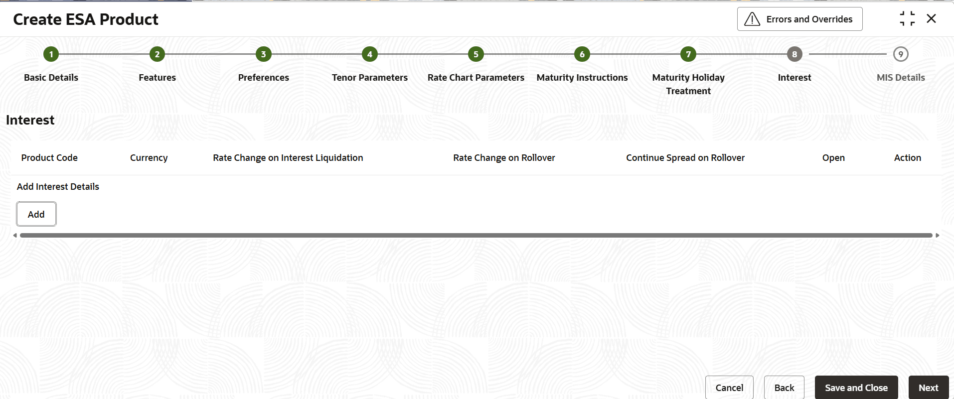

  16. After specifying the fields in the Maturity Holiday Treatment screen, click Next.
    The Interest screen displays.
    Figure 1-60 Create ESA Product - Interest
  17. Specify the fields on Interest screen.
    Click the Add button. The Add Interest screen displays.
    Table 1-63 Interest - Field Description
    Field Description
    Product Code Specify the interest product code that should be linked to the account. The adjoining option list displays all valid Interest and Charge (IC) products available in the system. User can select the appropriate one.
    Currency Select the Currency from the drop-down list defined for the interest product.
    Rate Change on Interest Liquidation Switch this toggle ON, then on every interest liquidation new rates are picked up for the interest calculation. However, you cannot toggle this switch once authorized.
    Rate Change on Rollover Switch this toggle ON to re pick up the rate activity on the rollover of deposit. The rate is picked up for fixed and rate chart allowed deposits.
    Continue Spread on Rollover This is defaulted based on the Interest and Charges product. Switch this toggle ON to enable continued variance on rollover. The system will default account variance as current value to the rollover deposit for the next cycle.
    If you toggle OFF this, then the account variance will not be carried forward to the next rollover cycle.
    Open Switch this toggle ON to make the product applicable. More than one IC product may be applicable for a IRA product at the same time.
    The default value is ON.
    Action Click Edit icon to edit the values in a row, or click Delete icon to delete the rows.
    1. After specify the details in the Add Interest screen. Click Add or Add Another button to include the interest parameters in the Interest screen.
  18. After specifying the fields in the Interest screen, click Next.
    The MIS screen displays.
    Figure 1-61 Create IRA Product - MIS
  19. Specify the fields on MIS screen.
    Table 1-64 MIS - Field Description
    Field Description
    MIS Group Select the MIS group applicable for the deposit ESA product from the selection list. The list is populated based on the MIS configuration maintained in common core.
    Description The system displays the description. This is auto populated.
