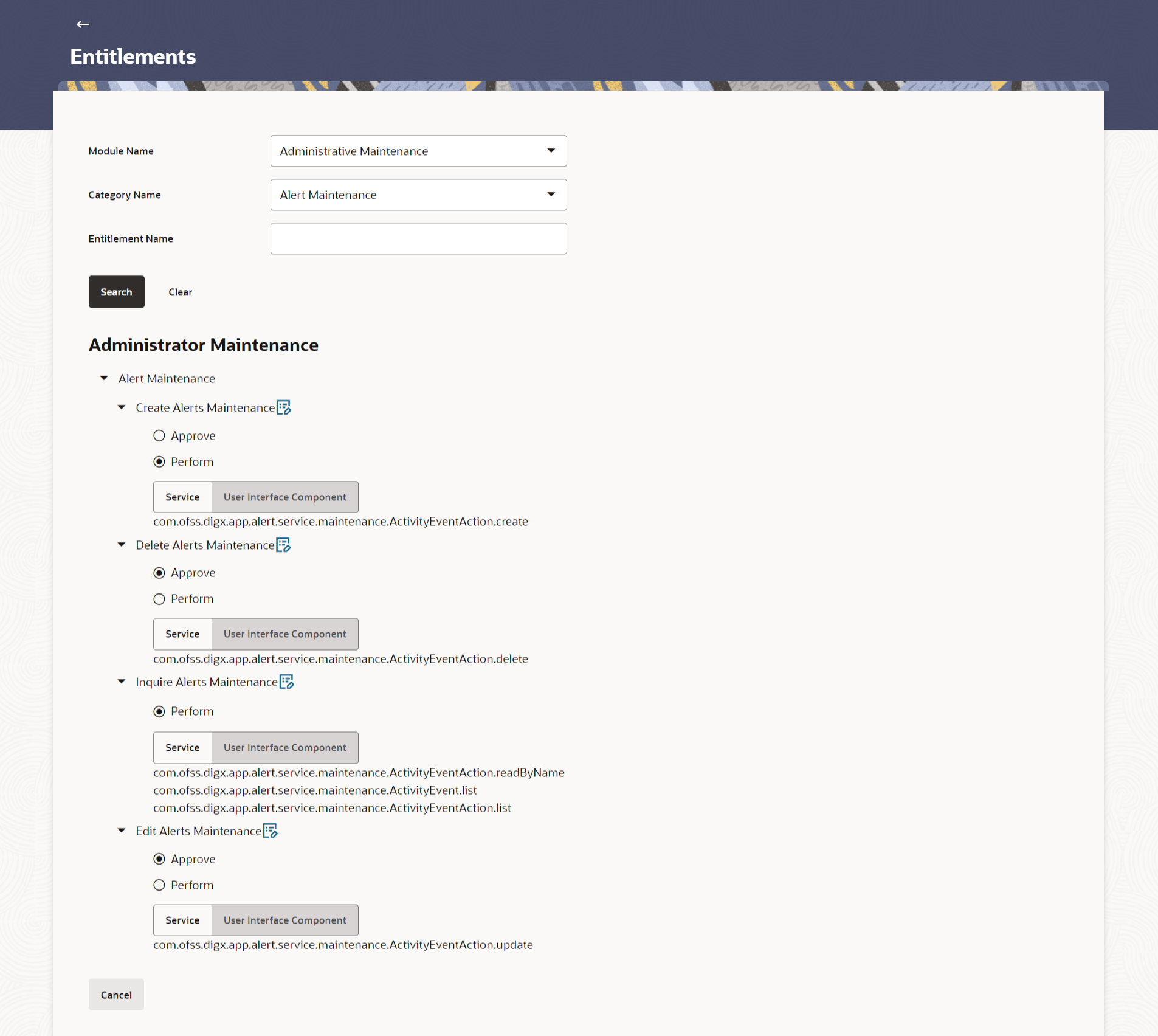

Using this option, Administrator can search and view the existing
entitlements.
To search entitlement (s):
- Navigate to one of the above paths.The Entitlements screen appears.
- From the Module Name list, select the appropriate module for which the entitlements are to be viewed.
- From the Category Name list, select the appropriate category of the selected module.
- Enter the entitlement name.
- Perform anyone of the following actions:
- Click Search.
- The based on the search criteria the list of entitlements appears.
- Click Cancel to cancel the transaction.
- Click Clear to reset the entered details.
- Enter the value directly in the Entitlement Name field and Click Search.

Resource Name Name of the resources mapped to entitlement for each action- Approve/Perform/View under Services or User Interface Component. - Click
icon against the particular category to view the entitlement under that
category. - Select the Service or User Interface Component tab to view respective details.
