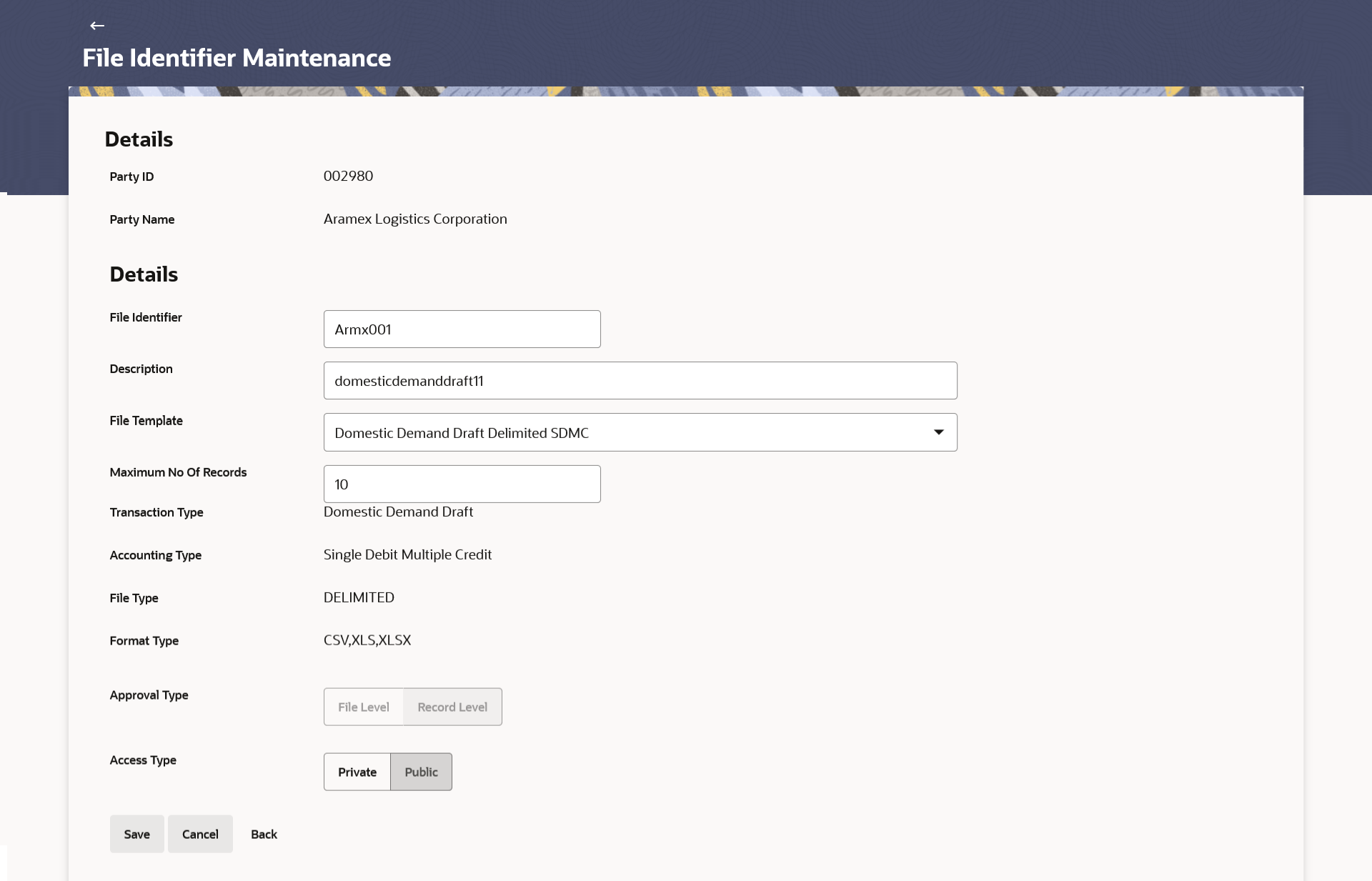

  4. Click Create.
    The File Identifier Maintenance - Create screen appears.
    Figure 44-9 File Identifier Maintenance - Create
    The fields which are marked as Required are mandatory.
    Table 44-7 File Identifier Maintenance - Create - Field Description

  5. In the File Identifier field, enter the code of the file to be maintained for upload.
  6. In the Description field, enter the file description corresponding to the file code.
  7. From the File Template list, select the file template.
    1. If you have selected a file template with AcctId defined at FI level from the File Template list, enter the Debit Account Number.
  8. Select the appropriate Approval Type.
  9. Perform anyone of the following actions:
    • Click Save.
    • Click Cancel to cancel the transaction.
    • Click Back to navigate to the previous screen.
  10. Perform anyone of the following actions:
    • The File Identifier Maintenance - Review screen appears. Verify the details, and click Confirm.
    • Click Cancel to cancel the operation.
    The success message appears along with the transaction reference number and status.
  11. Click OK to complete the transaction.
