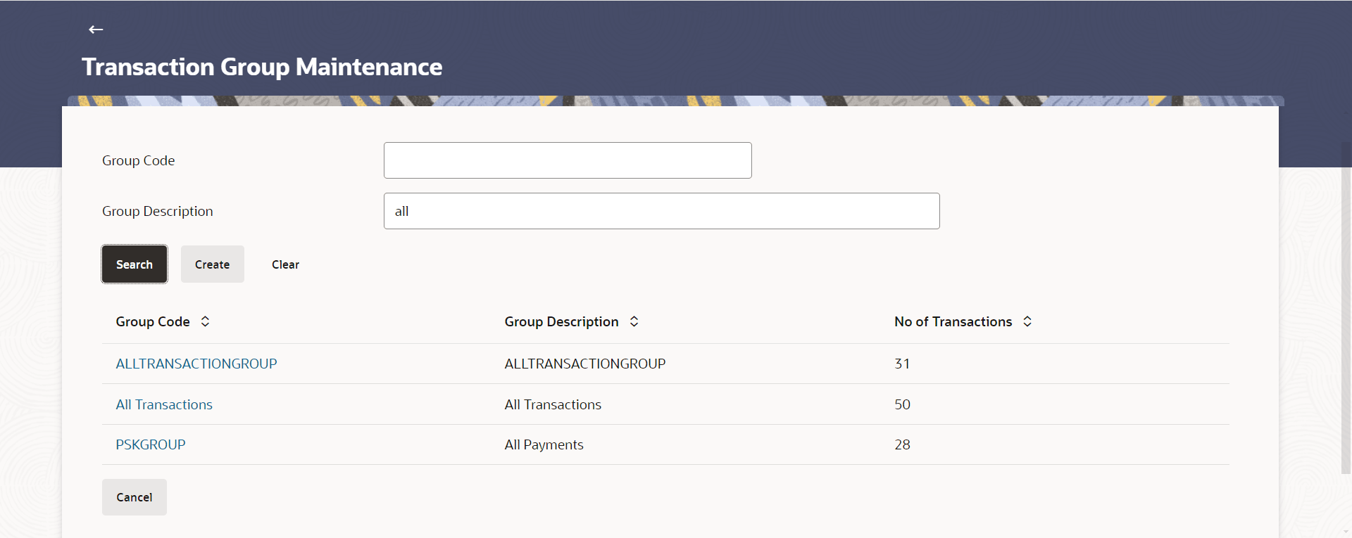

  2. Perform anyone of the following actions:
    • In the Transaction Group Maintenance screen appears. Click Search. Displays the Transaction Group Maintenance screen with search results appears based on the searched criteria.
    • Click Cancel to cancel the search process.
    • Click Clear to reset the search parameters.
    Figure 8-8 Transaction Group Maintenance - Search

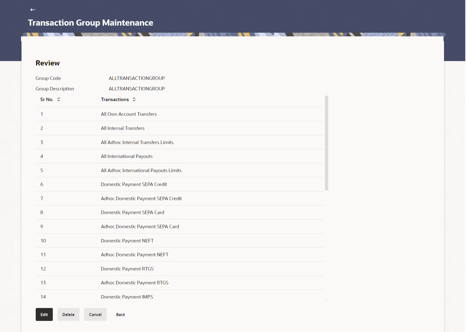

  3. Click the Group Code link of the record to view the transaction group details.
    The Transaction Group Maintenance -View screen appears.
    Figure 8-9 Transaction Group Maintenance - View

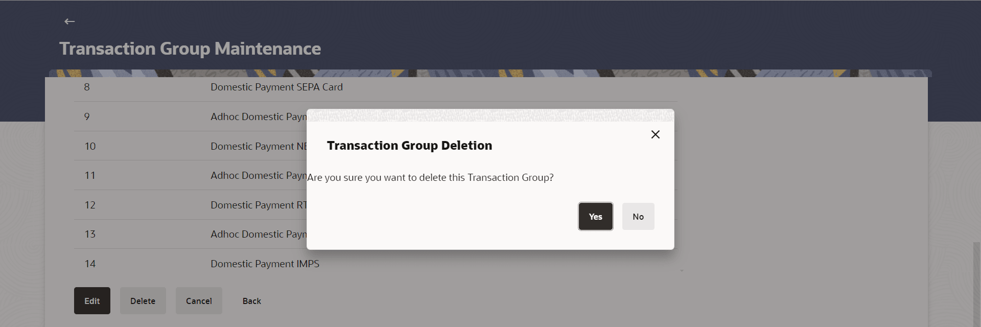

  4. Click Delete.
    The Delete Warning Pop-up Message appears.
    Figure 8-10 Delete Transaction Group
  5. Perform anyone of the following actions:
    • Click Yes to confirm the deletion.
    • Click No to cancel the deletion process.
  6. The success message of transaction group deletion appears.
    Click OK to complete the transaction.
