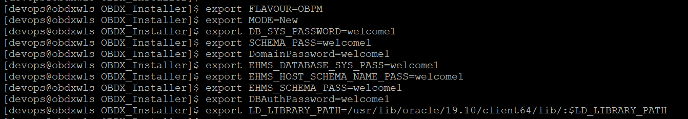

- Set the environment variables , as shown below
Below parameters should be set as environment variables, depending on the Host system the installer should be executed.

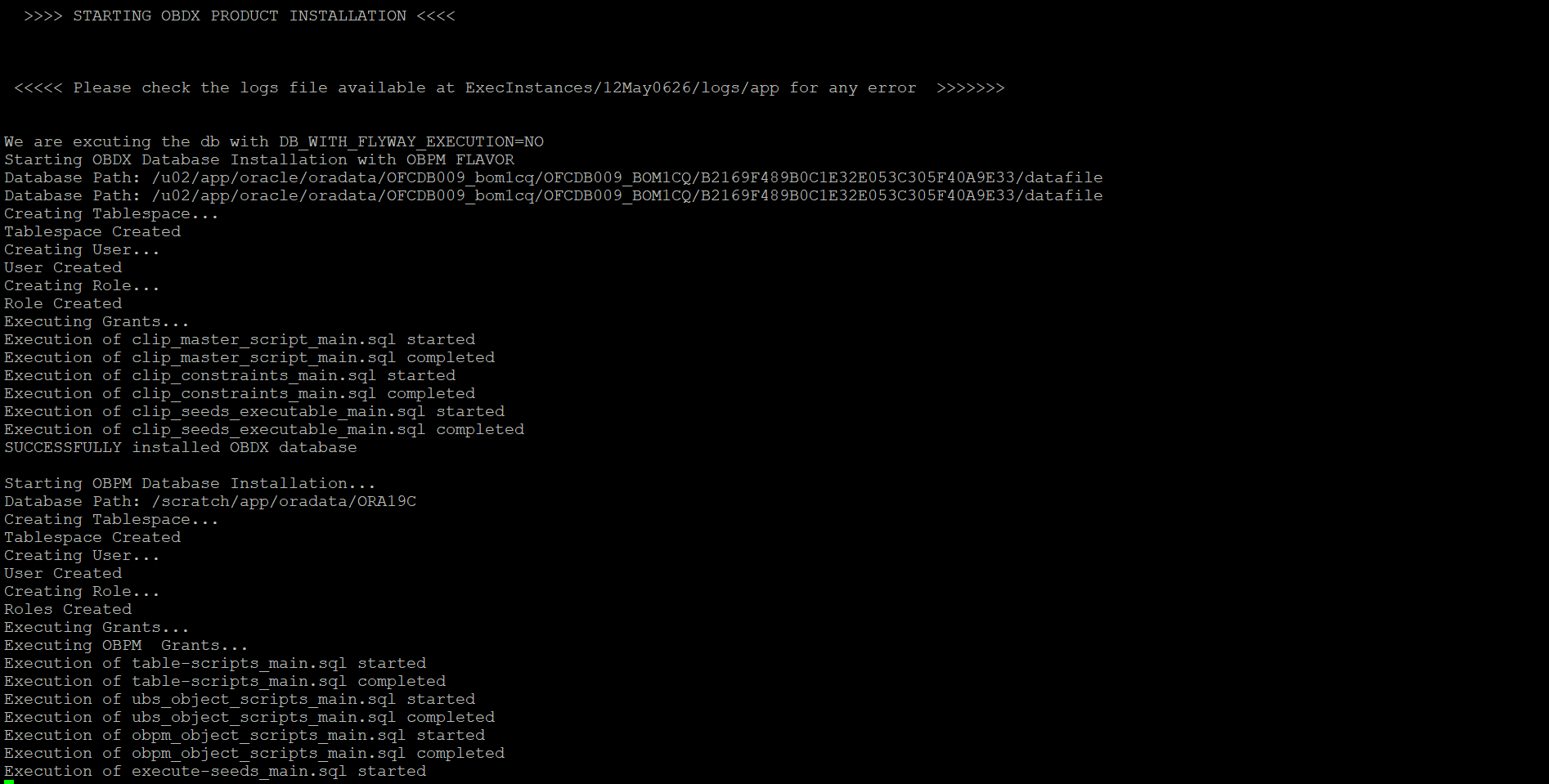

If DB_WITH_FLYWAY_EXECUTION set to NO

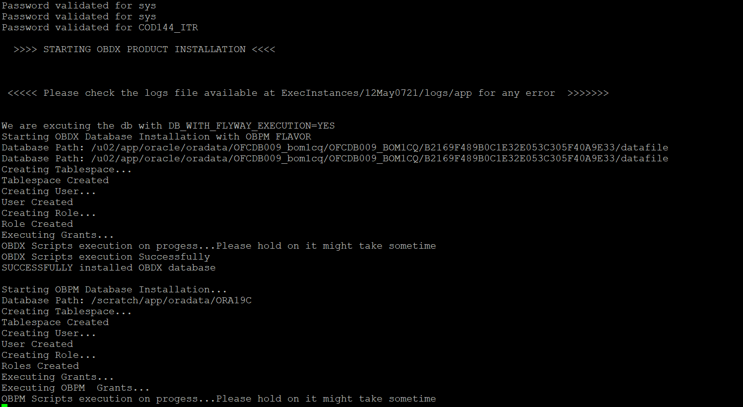

If DB_WITH_FLYWAY_EXECUTION set to YES

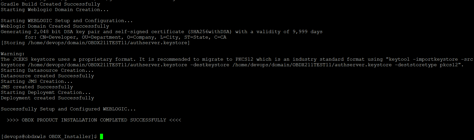

When the installation completes, the below message is displayed
