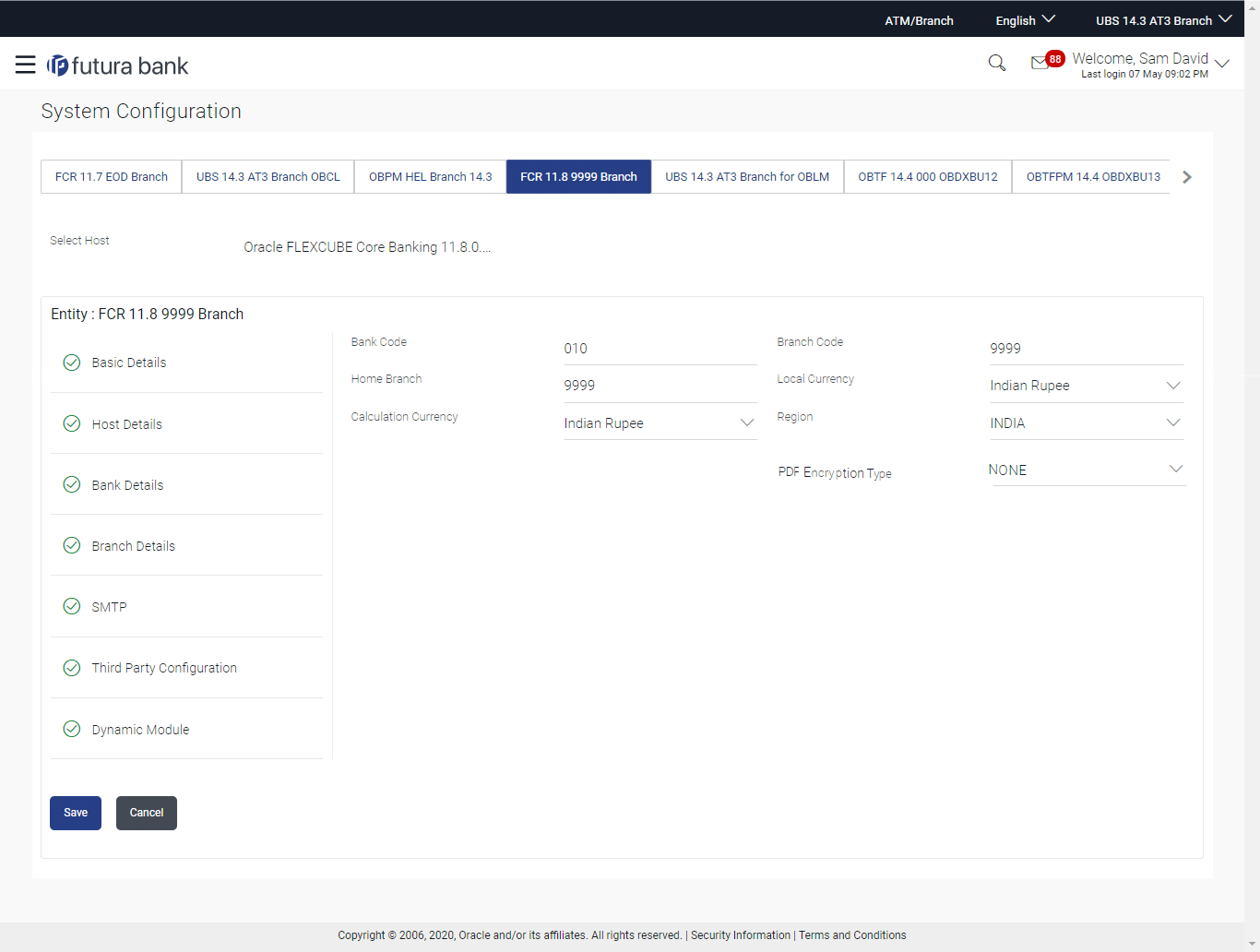

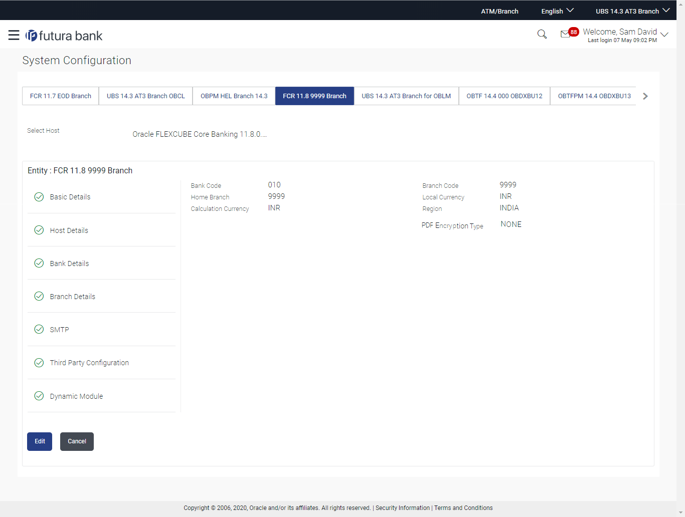

- Click on System Configuration option on the dashboard
and navigate to the branch details tab. The default option is
‘View’.
- Click Edit to edit the Branch Details.The System Configuration - Branch Details screen appears in editable form.
Table 4-18 Field Description
Field Name Description Bank Code Displays the unique code of the bank as defined. Branch Code Displays the bank branch code as defined and available for edit. Home Branch Displays the home branch code as defined and available for edit. Local Currency Displays the local currency as defined and available for edit. Calculation Currency Displays the calculation currency as defined and available for edit. Region Displays the region of bank payments as defined and available for edit. The options are:- India
- UK
- SEPA
With FCORE as host system, only India region is currently supported.PDF Encryption Type Specify the type of password protection required for the PDF documents required while downloading pdf, to enhanced security. The options are:- None
- First 4 characters of Name and DDMM of the Date of Birth
- First 4 characters of Name and Last 4 digits of Mobile Number
- In the Bank Code field, edit the code of the bank.
- In the Branch Code field, edit the branch code of the bank.
- In the Home Branch field, edit the name of the home branch of the bank.
- From the Local Currency list, select the local currency of the bank branch.
- From the Calculation Currency list, select the calculation currency of the bank branch.
- From the Region list, select the appropriate region.
- From the PDF Encryption Type list, select the appropriate type for encryption type for downloaded statement.
- Click Save to save the changes.OR
Click Cancel to cancel the transaction.
- The System Configuration - Branch Details - Review
screen appears. Verify the details, and click Confirm.OR
OR
Click the Basic Details, Host Details, Bank Details, Currency Payments, SMTP, Third Party Configuration or Dynamic Module tabs to view and edit the respective details if required.
- The screen with success message along with the reference number and status
appears.Click OK to complete the transaction.
