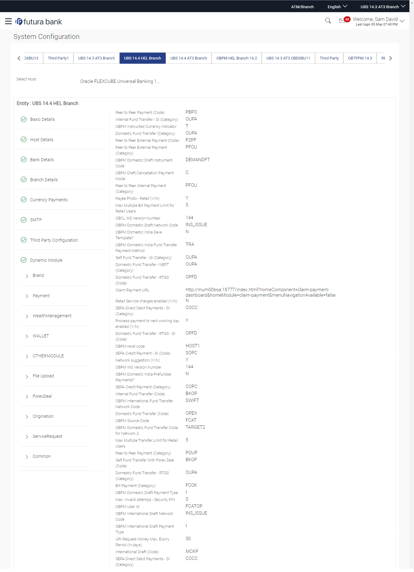

To view and edit the Dynamic Module - Payment details:
- Click on System Configuration option on the dashboard
and navigate to the dynamic module – Payment tab. The
default option is ‘View’.

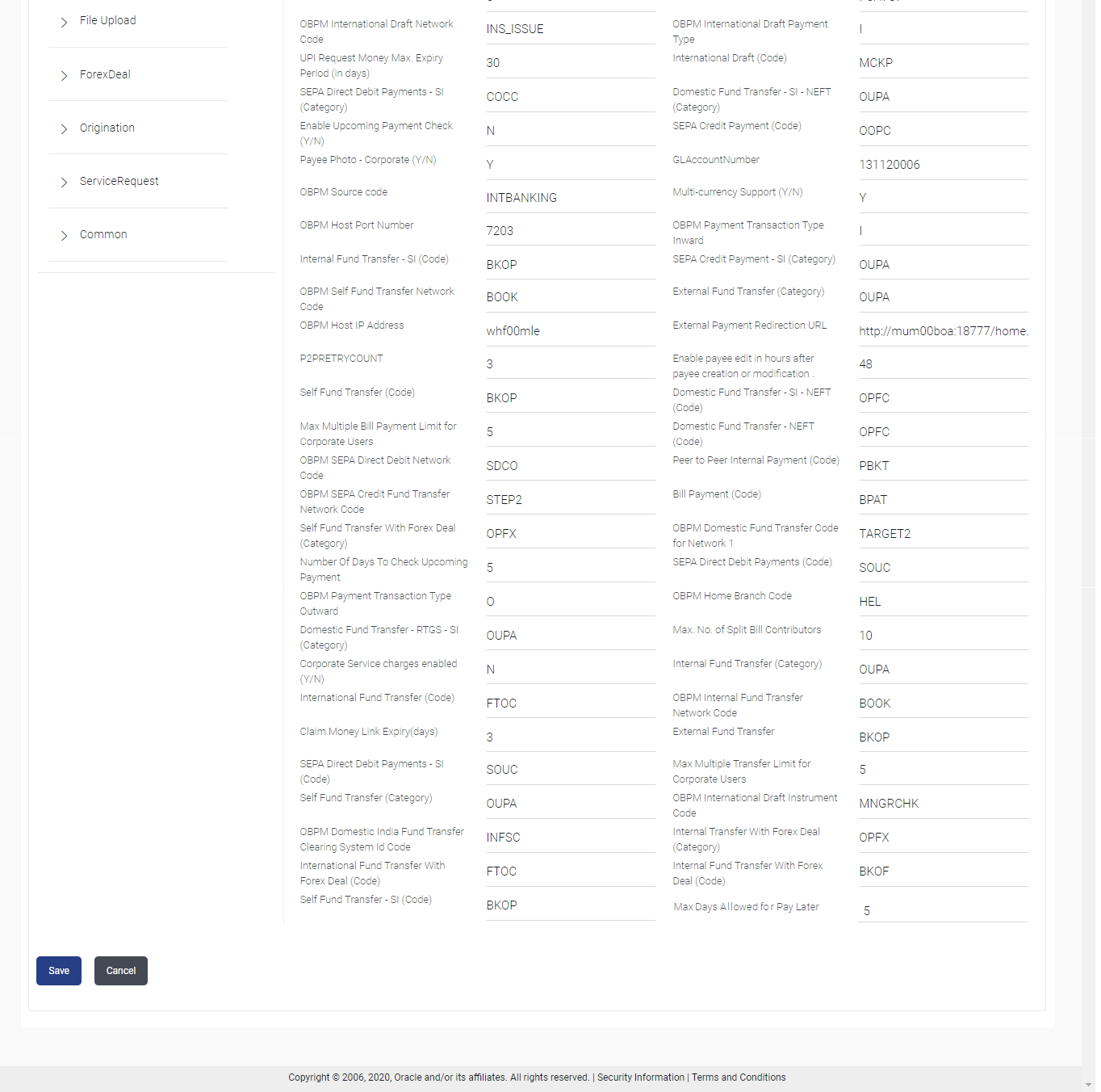

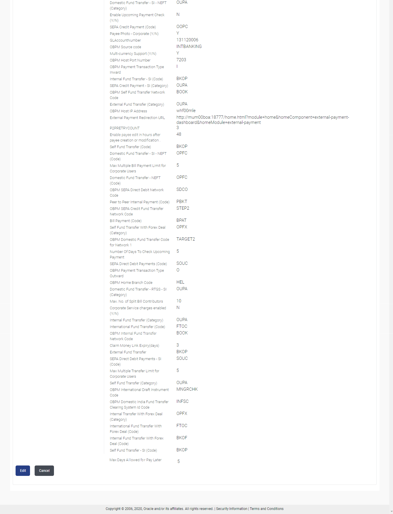

Figure 3-33 System Configuration - Dynamic Module – Payment - View
- Click Edit to edit the Dynamic Module –
Payment.The System Configuration - Dynamic Module – Payment screen appears in editable form.

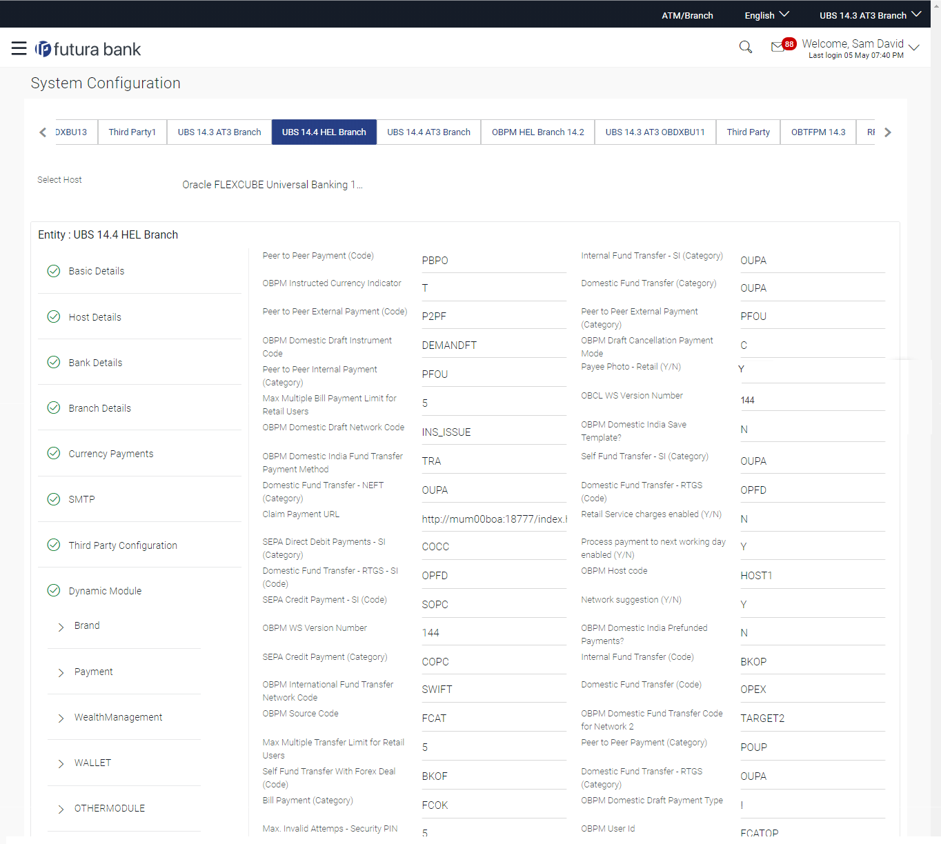

Figure 3-34 System Configuration - Dynamic Module - Payment - Edit
