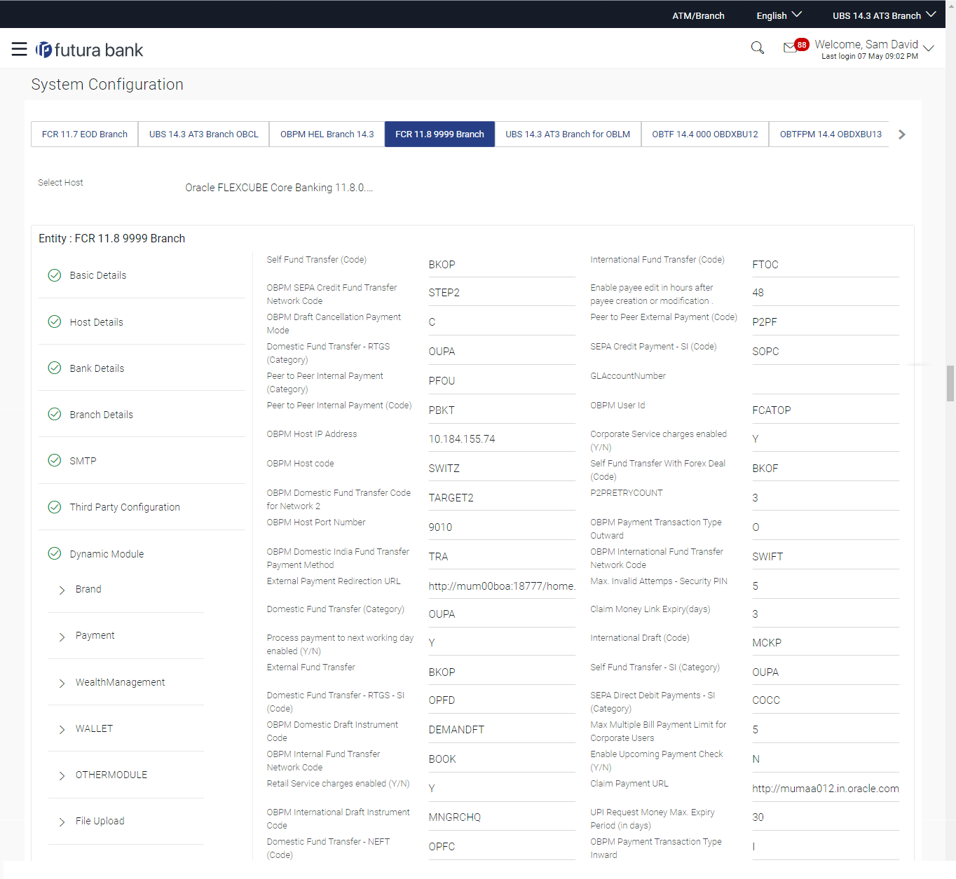

To view and edit the Dynamic Module - Payment details:
- Click on System Configuration option on the dashboard
and navigate to the dynamic module – Payment tab. The
default option is ‘View’.

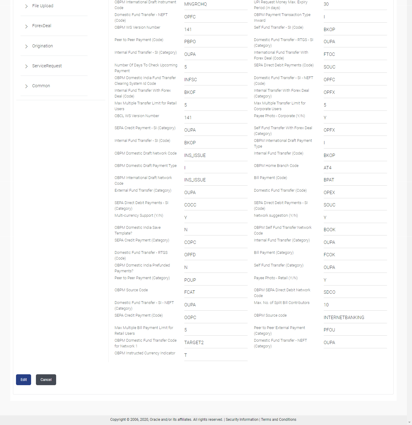

Figure 4-30 System Configuration - Dynamic Module – Payment - View
- Click Edit to edit the Dynamic Module –
Payment.The System Configuration - Dynamic Module – Payment screen appears in editable form.

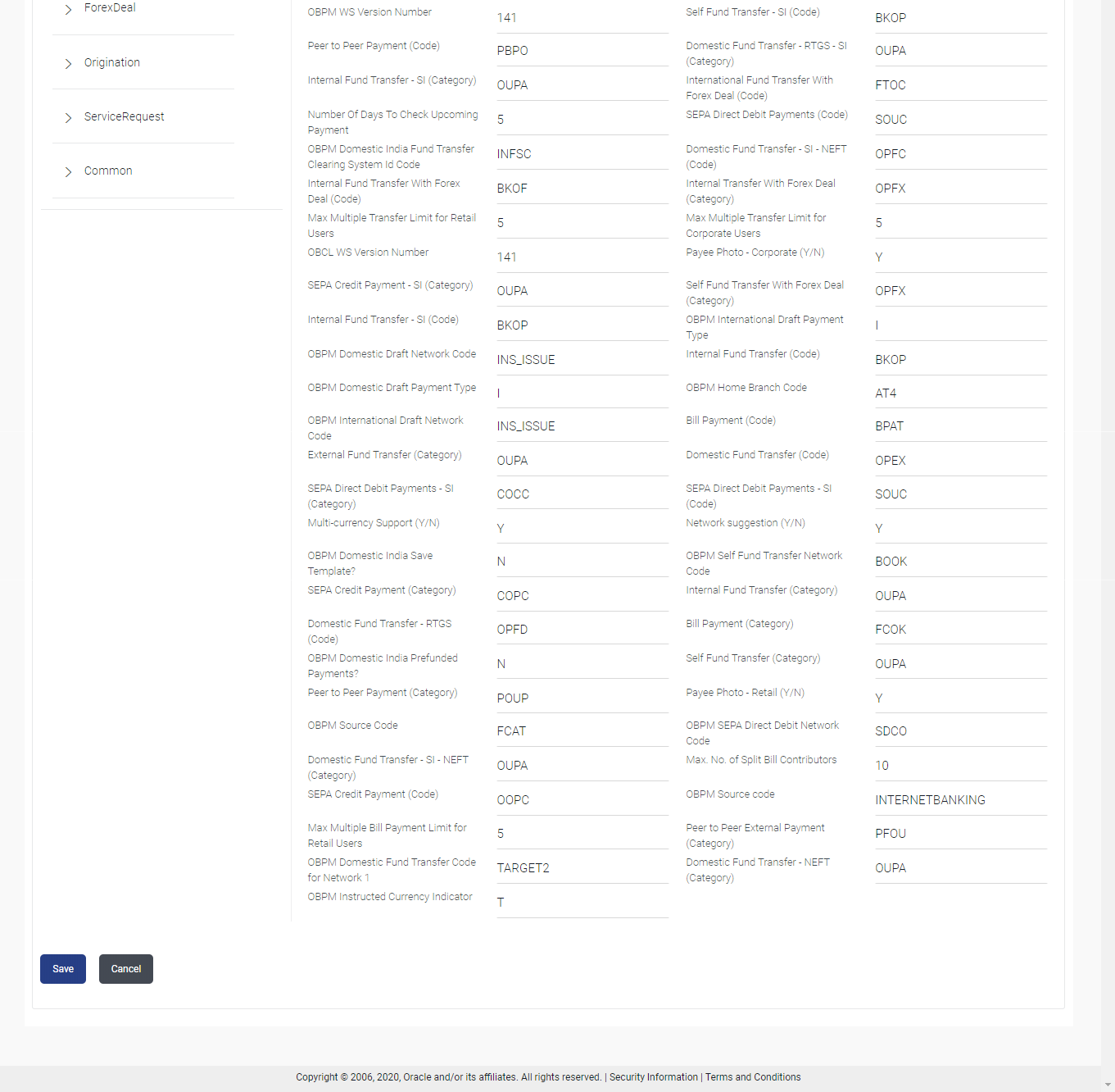

Figure 4-31 System Configuration - Dynamic Module - Payment - Edit

- Edit the required Payments detail.
- Click Save to save the changes.OR
Click Cancel to cancel the transaction.
