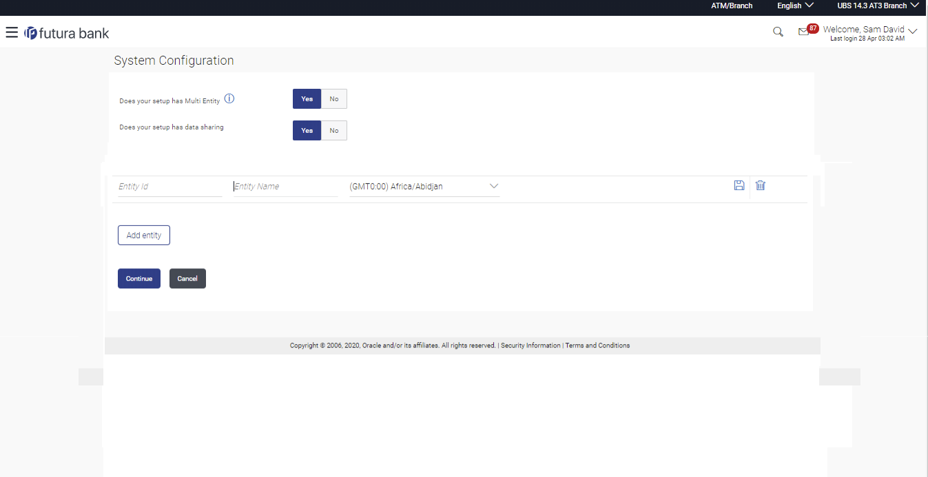

- Click Add Entity to create a new entity. An additional row/section to enter the new entity details i.e. Entity ID, Entity Name and Time zone appears.
Table 2-3 Field Description
Field Name Description Does your set up has Multi Entity? Option to select whether the setup has multi entity enabled or not. Does your setup has data sharing Option to select whether the setup has data sharing enabled between entities. Entity Id Enter the unique ID of the new entity being created. Entity Name Enter the name of the new entity being created. Time Zone Select the Time zone from the list for the new entity being created. - In the Entity Id field, enter the entity id for the new entity being created.
- In the Entity Name field, enter the entity name for the new entity being created.
- From the Time Zone list, select an appropriate time zone for the new entity being created.
- Click
icon to save the entity details. - Click
icon to edit the entity details of the newly created entity.ORClick
icon to delete the entity details.
- Click Continue. The System Configuration Setup details screen appear.
