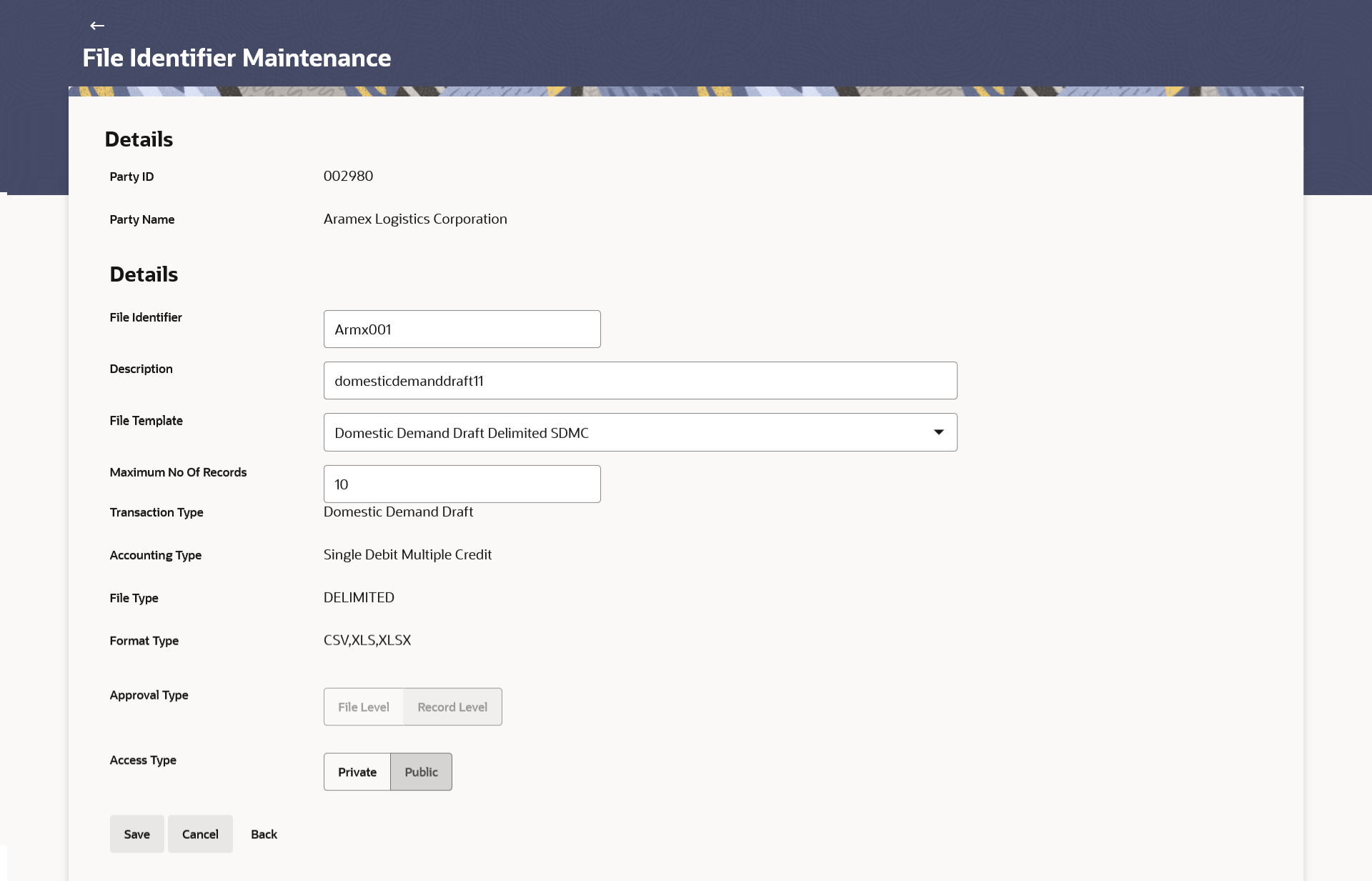

- Click Create.The File Identifier Maintenance - Create screen appears.
Figure 52-9 File Identifier Maintenance - Create
The fields which are marked as Required are mandatory.For more information on fields, refer to the field description table.

- In the File Identifier field, enter the code of the file to be maintained for upload.
- In the Description field, enter the file description corresponding to the file code.
- From the File Template list, select the file template.
- If you have selected a file template with AcctId defined at FI level from the File Template list, enter the Debit Account Number.
- Select the appropriate Approval Type.
- Perform anyone of the following actions:
- Click Save.
- Click Cancel to cancel the transaction.
- Click Back to navigate to the previous screen.
- The File Identifier Maintenance - Review screen appears. Verify the details, and click Confirm.
- Click Cancel to cancel the operation.
The success message appears along with the transaction reference number and status.
- Click OK to complete the transaction.
