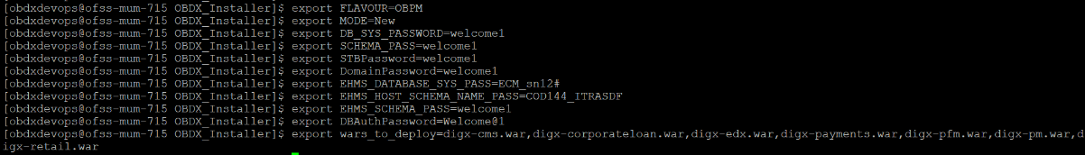

- Set the environment variables , as shown below
Below parameters should be set as environment variables, depending on the Host system the installer should be executed.

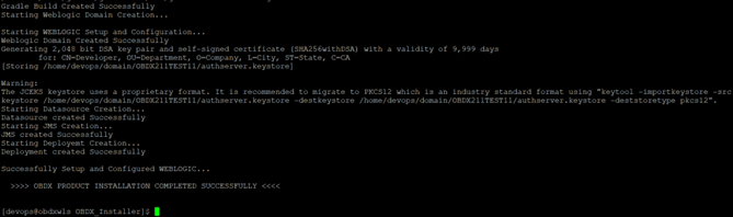

Installation Status
The status is displayed on the terminal to indicate the progress of the installation.

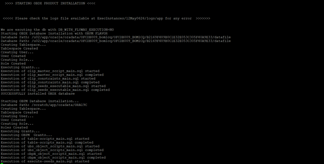

If DB_EXECUTION_TYPE set to CX_ORACLE

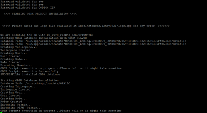

If DB_EXECUTION_TYPE set to FLYWAY
When the installation completes, the below message is displayed
