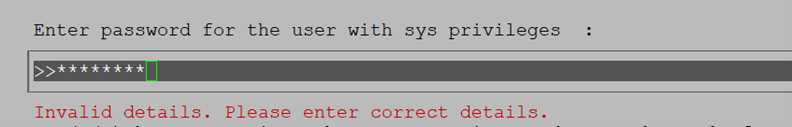

Invalid database password
This topic contains troubleshooting information if you receive an error when attempting to connect to the database server.
If you get the following error:
Troubleshoot Overview
Try one of the following:
  • Verify that the database is running.
  • Check Network connectivity between Weblogic Server and Database server.
  • Check the database configuration in installer.properties file
  • Verify that the entered password is correct.

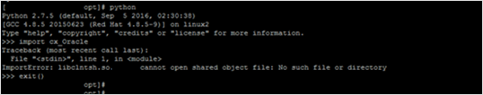

cx_oracle module
This topic contains troubleshooting information about problems with cx_Oracle python module.
Execute the below command:
export LD_LIBRARY_PATH=/usr/lib/oracle/19.10/client64/lib:$LD_LIBRARY_PATH
python
 import cx_Orace     cx_Oracle.__version__

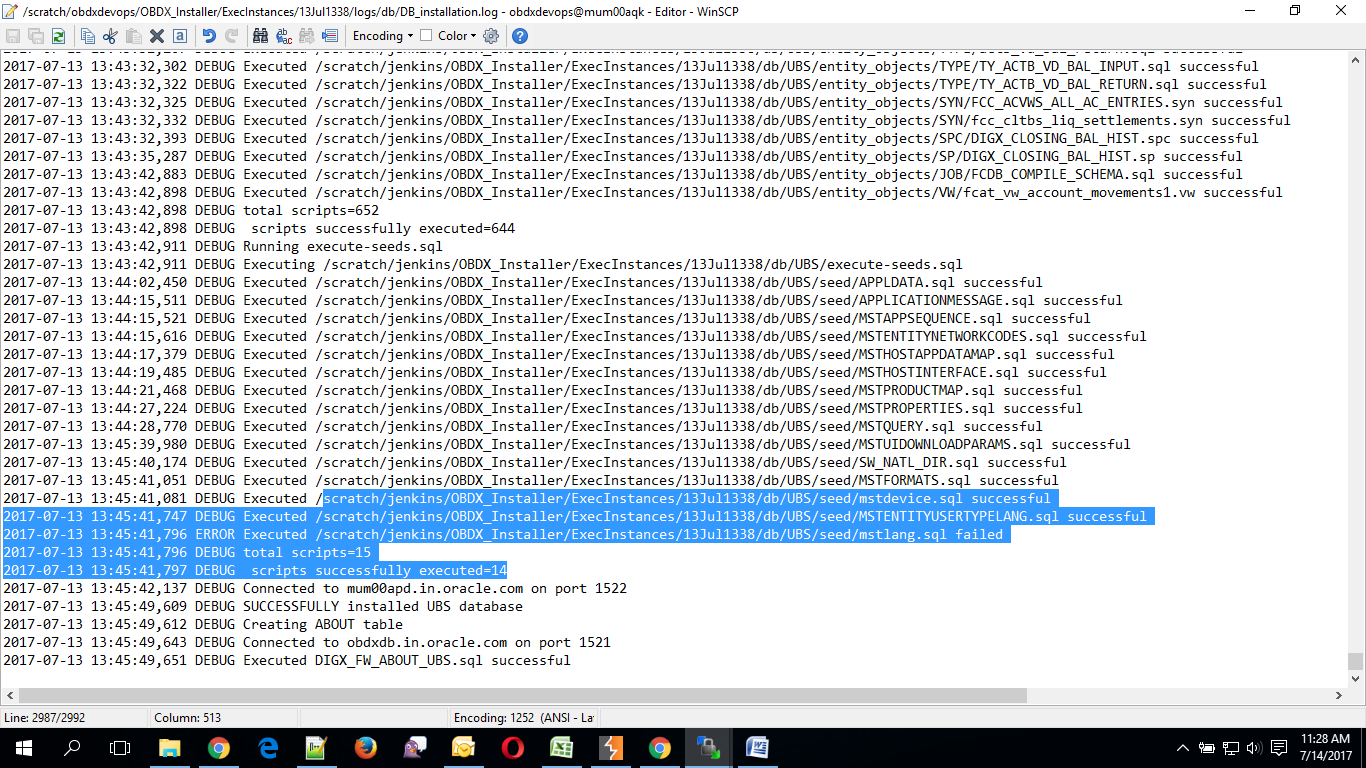

Failed Database Scripts
This topic contains troubleshooting information in case of database script failures.
If you get the following error in DB_installation.log:

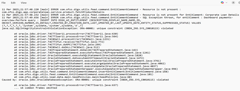

Failure of Policy Seeding
This topic contains troubleshooting information if policy seeding fails during installation.
Check if Entitlement.log is created on
        following path <OBDX INSTALLER DIR>/ExecInstances/<DDMonthHHMM>/logs/db/ and contains any SEVERE
        errors for Entitlement policy seeding.
Check if Task.log is created on following
        path <OBDX INSTALLER DIR>/ExecInstances/<DDMonthHHMM>/logs/db/ and contains any SEVERE errors
        for Task policy seeding.
Check if Dashboard_seed.log is created on
        errors for Dashboard policy seeding.
  • Check the seedPolicies.log in <OBDX INSTALLER DIR>/ExecInstances/<DDMonthHHMM>/logs/db/ directory if it contains any runtime errors generated during execution of the policies Seeding in OBDX schema

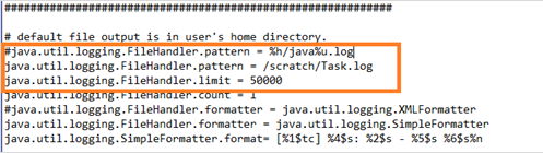

Fix the problem by following below steps:
  • Login to OBDX installer server.
  • Over-write the policies files (Day0Policy.csv; Entitlement.csv; Resources.csv and Task.csv) from OBDX Product zip into <OBDX INSTALLER DIR>/installables/policies directory.
  • Browse to <OBDX INSTALLER DIR>\ installables\policies.

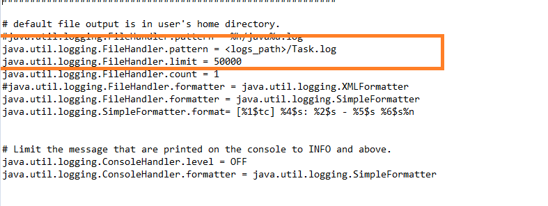

  • Edit Entitlement_log4j.properties , Task_log4j.properties & Dashboard_seed_log4j.properties . Replace <logs_path> with directory where policy seeding logs will be generated.
    Example
