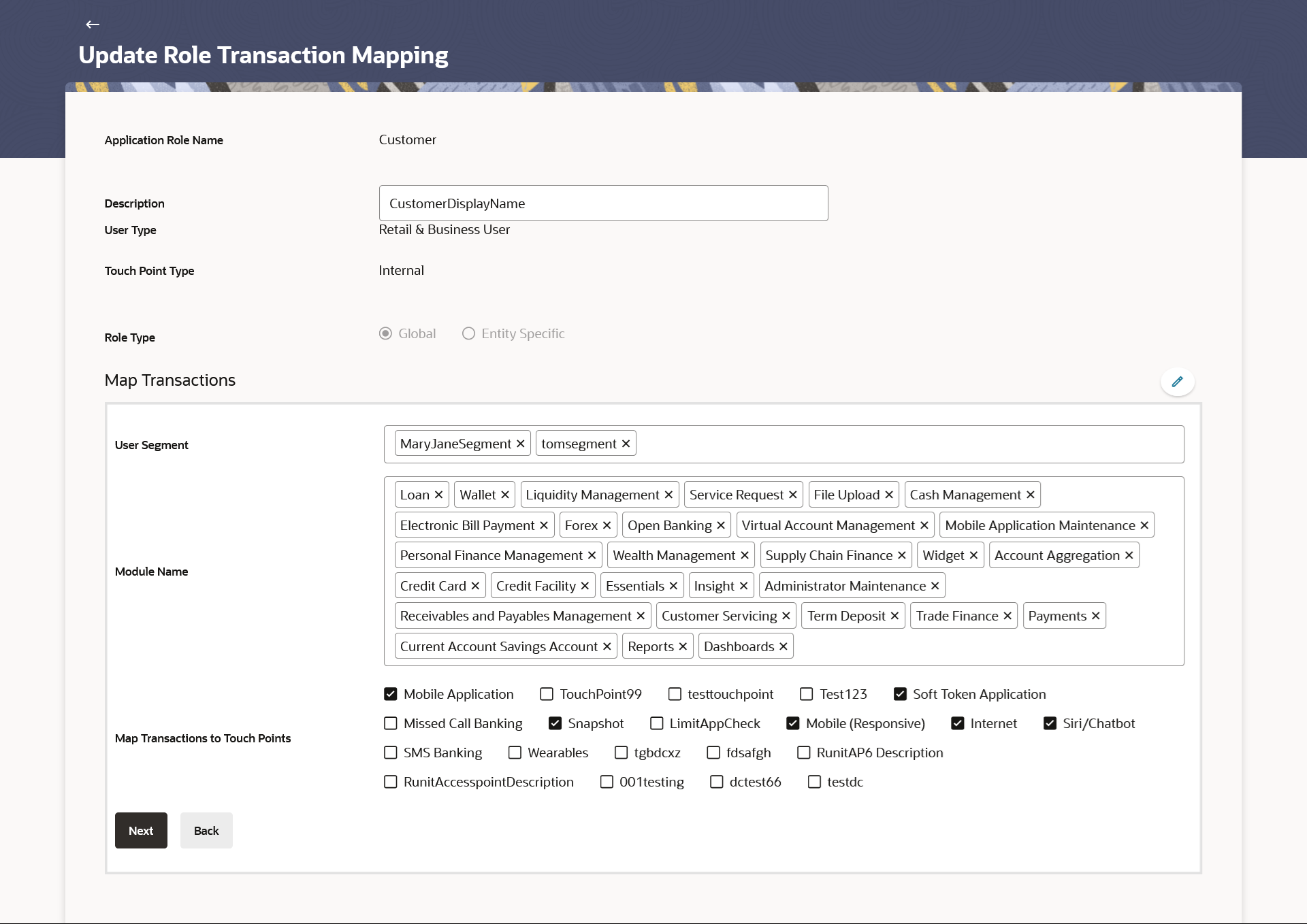

  3. Click edit icon against the Map Transactions.
    Screen in editable mode appears.
    Figure 31-3 Role Transaction Mapping - Edit
    Application Role Name, User Type, and Touch Point Type fields cannot be edited.
  4. Update the role description if required.
  5. Add/ remove the user segment as per requirement.
  6. Select/ deselect module names for which the transaction mapping is to be done.
  7. Check/uncheck the touch points for which the transaction mapping is to be done.
  8. Perform anyone of the following actions:
    • Click Next to link/ delink transactions.
    • Click Back to go back to previous screen.
    If the administrator deselects a module from Module name field, transaction mapping done for all the transactions under that module will get removed for that module. Similarly if the administrator unchecks and existing touch point, transaction mapping done for all modules for that touch point will get removed for that Touch Point.

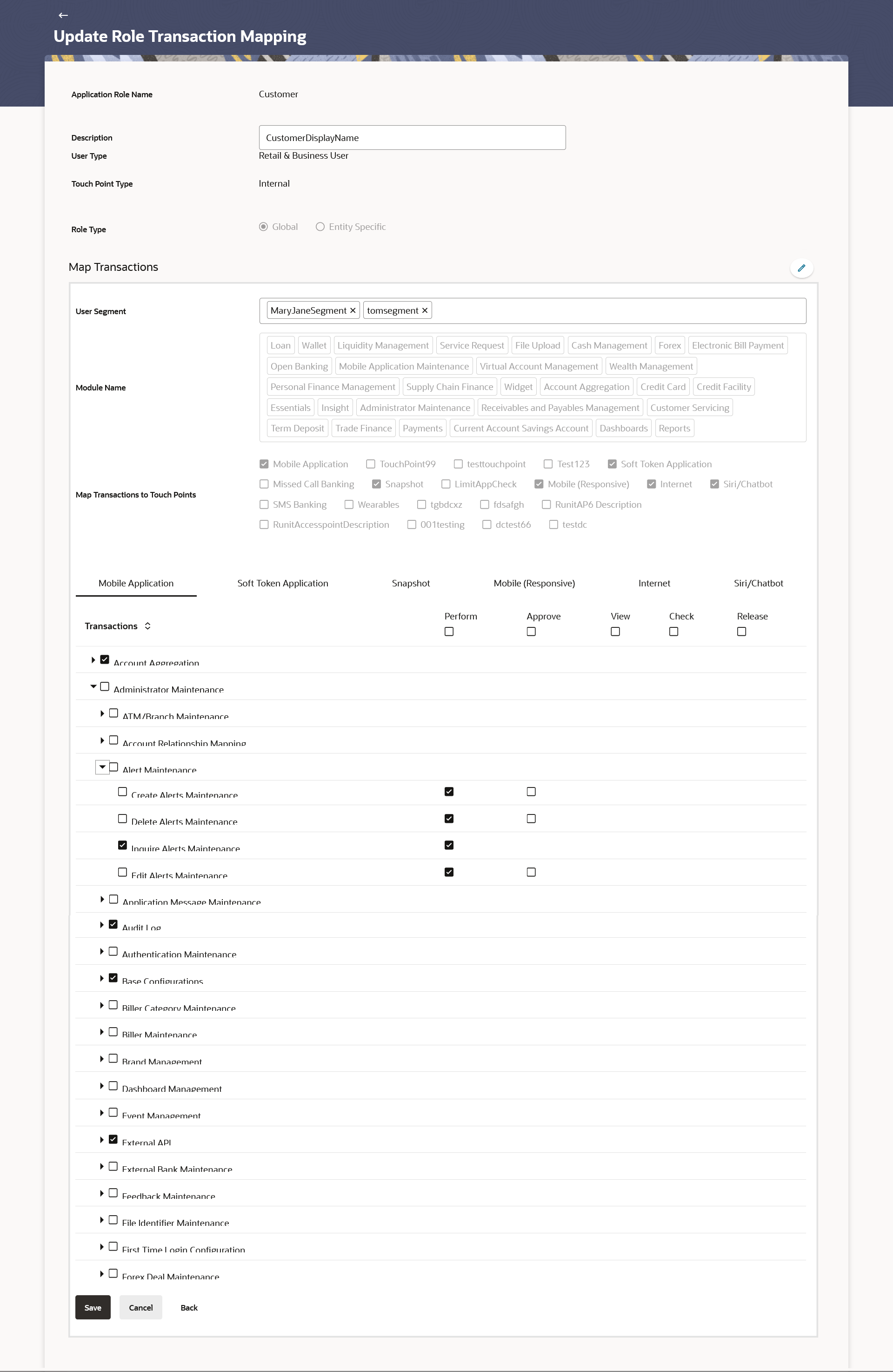

  9. Modify the transactions mapping for different touch points.
    Click viewdetails icon against the particular category to view and update the transaction mapping.

  11. Modify the transactions mapping for current touch points if required.
  12. Perform anyone of the following actions:
    • Click Save to save the updates.
    • Click Cancel to cancel the transaction.
    • Click Back to navigate to the previous screen.
  13. The screen with success message appears.
    Click OK to close the message screen.
