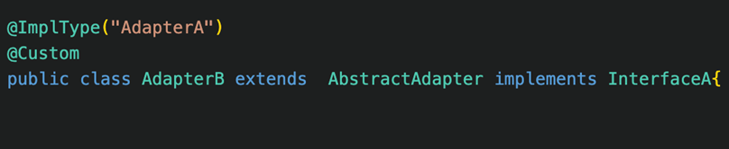

- Use an existing adapter interface or create a new adapter interface, this adapter interface must be implemented by the new adapter class.
- If the new adapter class has a parameterized constructor, then it must have a no-args default constructor.
- The new Adapter class must have @Custom annotation The @Custom annotation is used to signify that the adapter is customized by the vendor, this is mandatory for proper functioning of the adapter.
- @ImplType annotation should be used in the new Adapter class to mention the Adapter Qualifier. Using the Adapter Qualifier and Adapter Interface used in the custom adapter class the Adapter Factory will be able load the custom adapter. If @ImplType of a custom adapter and base adapter are same then the custom adapter will be loaded instead of the base adapter.
- To configure a custom adapter, we need to add the entry of the fully qualified name of the new Adapter in META-INF\services\<<fullyQualifiedNameOfAdapterInterface>>

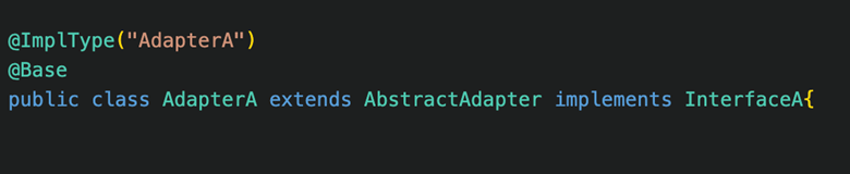

Suppose we have a “AdapterA” in base product which implements “InterfaceA” then it will be represented as below.

There might be requirement to change the functionality of the cross domain adapters by adding to or removing the existing functionality of the adapters. This could be achieved by overriding the existing adapters.
Let us override “AdapterA” mentioned above.
Here we give the @Custom annotation to signify that it is a customization from vendor
