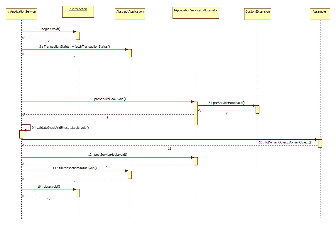

3.2.6 Sequence of events in service extension
Every application service method has a standard set of framework method calls as shown in the sequence diagram below:
The pre hook is provided after the invocation of
fetchTransactionStatus call inside the application service. At
this step, the current task code is received , any additional manipulation of the
input received from the User interface channel can be done in the pre hook. Apart
from this additional data coming from the screen specific to client requirements can
be handled in the pre hook.
The post hook is provided after the business logic corresponding to the application service invoked has executed and before the successful execution of the entire service is marked in the status object. This ensures that the status marking takes into consideration any execution failures of post hook prior to reporting the result to the calling source. Both, the pre and the post hooks accept the service input parameters as the inputs. The post hook also accepts the Response parameter as the input.
